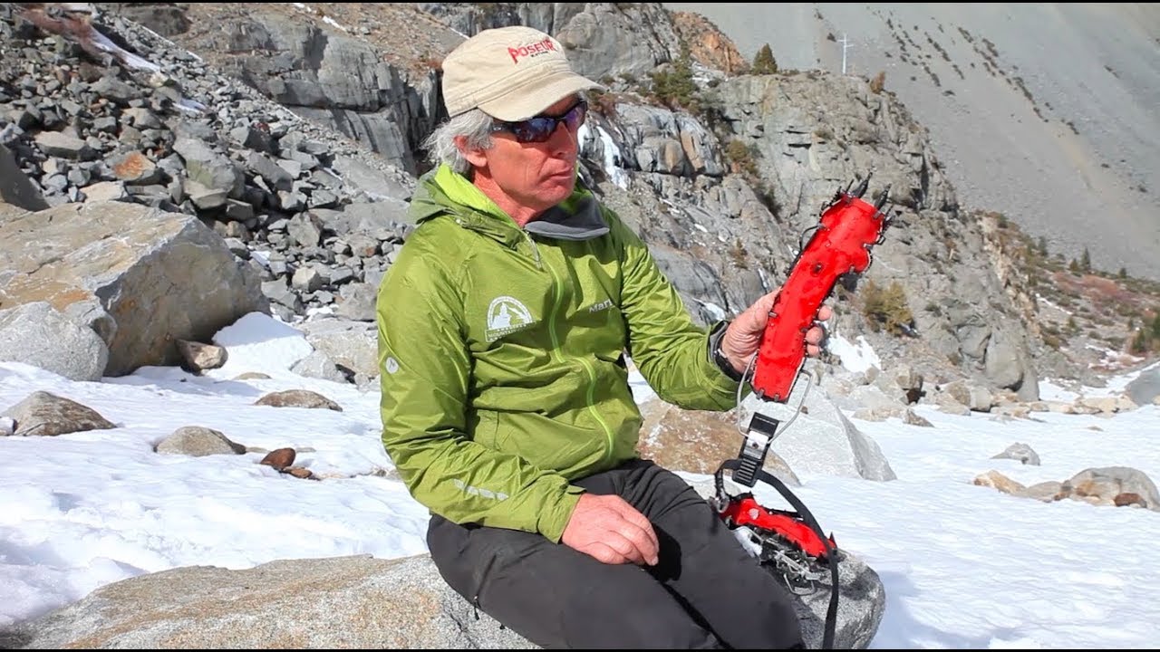

My Kahtoola KTS crampons have SRS which is Snow Release Skin, a rubbery sheet that goes over the base and is meant to aid release of build up. I haven’t used them enough on softer surfaces to know if they work or not. I do know they were an extra when I bought the crampons and the tote bag to carry them. Irrespective of whether the skins work, the tote bag (which cost about $25) works brilliantly.
Anti balling plates, available for most crampons
https://www.needlesports.com/Catalogue/Climbing-Equipment/Winter-Alpine-Expedition/Crampon-Accessories-Spares/Grivel-Anti-Balling-Plates-pair-GRI-ABPLATES

Second vote for the Grivel anti balling device. I use them on G-10s. The fold up version Grivel walking spikes also have them fitted.
