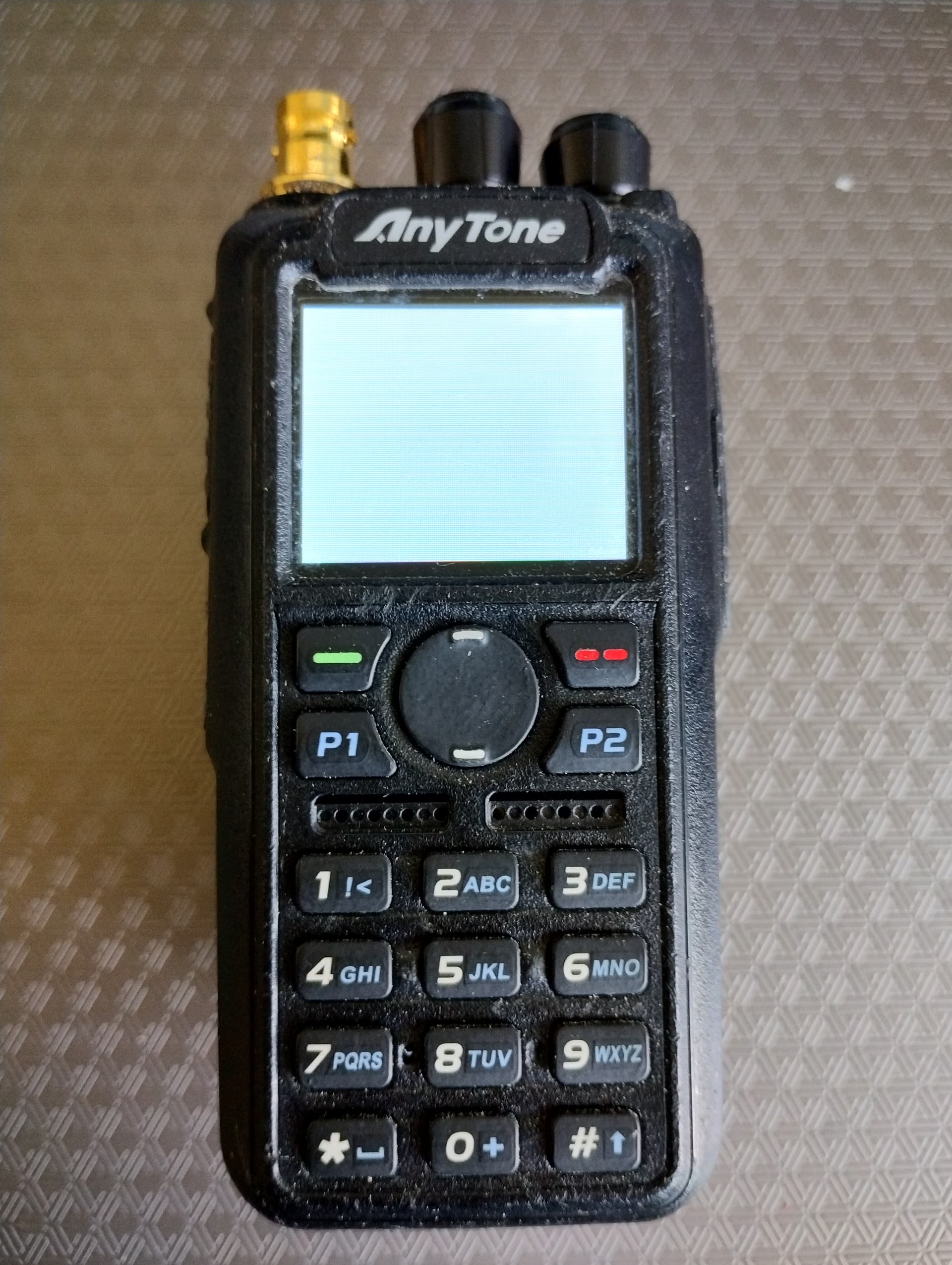

Hi,
I plan to use my new AnyTone AT-D878UVII Plus HT for Sota Activations. Do you have any recomendations on using it? Should I use a different anttena? Any help would be greatly appreciated.
thanks 73

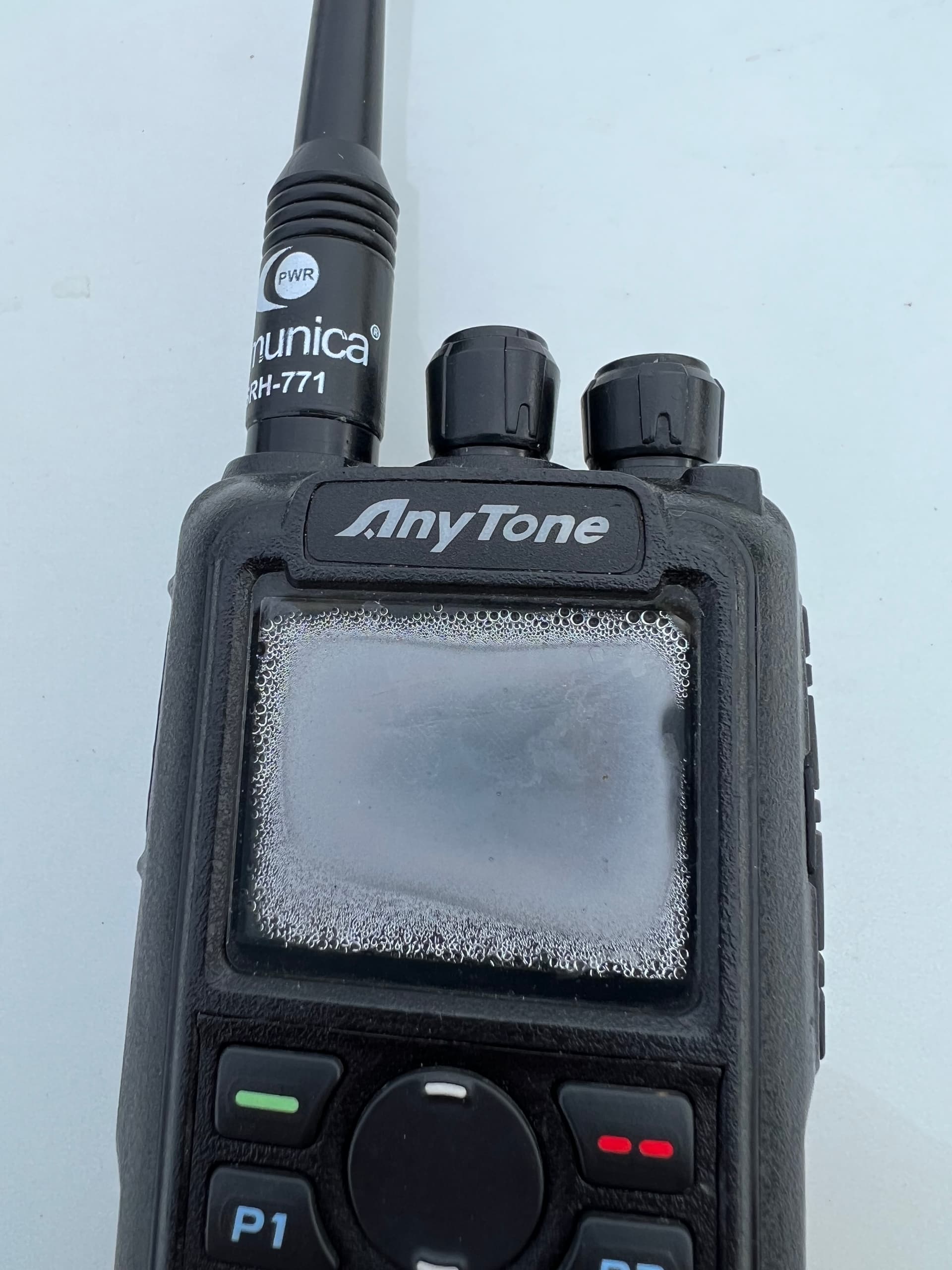

I now have my second 878 and am very satisfied. I recommend using a Protective Case Cover in (heavy) rain. It is not as water resistant as described (IP-54). The image shows moisture on the inside of the screen. This was the 3rd time this happened when I used it without protection, and after this it did not work anymore
Same issue here. Water ingress on a recent activation:
For now i have an expensive paper-weight (until I get round to fixing it). Interestingly, the radio is still working as it’s sending out ARPS beacons. It’s just the display is toast.
