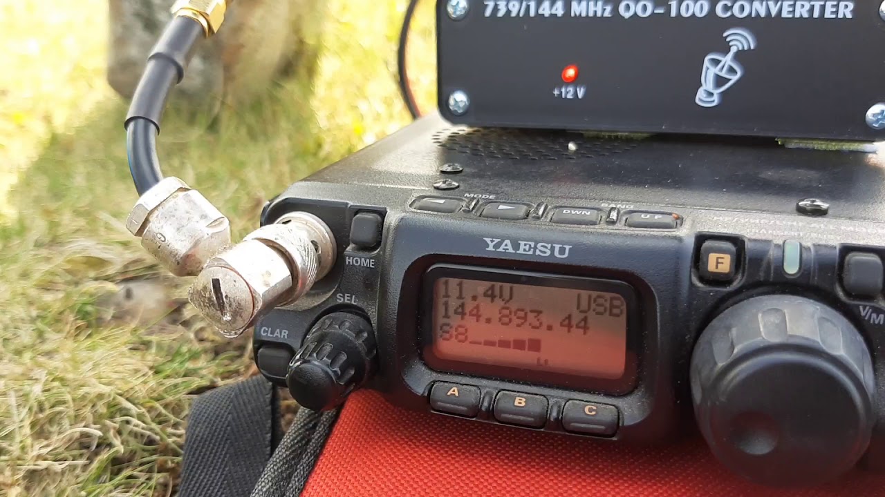

Photo’s from my end on Kirkby Moor.
And some video
Equipment
80cm SATV dish on a Gorilla stand.
TCXO modified LNB
SG-labs 13cms transvertor for the up link
A QO-100 Downconvertor.
Two FT-817’s to enable me to hear my downlink.
This is my 2nd QO-100 portable station and I hope to keep refining it.

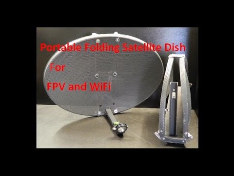

There’s this idea for one of the small elliptical SKY dishes.
It will not be awfully light but should be lighter than a 60/80cms dish. It might need a bit more 13cms uplink power though.
My light 40cm dish with LNB and yagi for the uplink can be taken apart.
The dish could also be used as a sun hat in summer.
