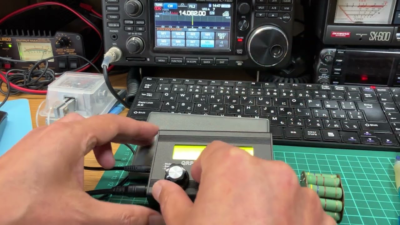

I tried adding a built-in speaker to QMX.
The speaker is too small, so the sound isn’t very good.

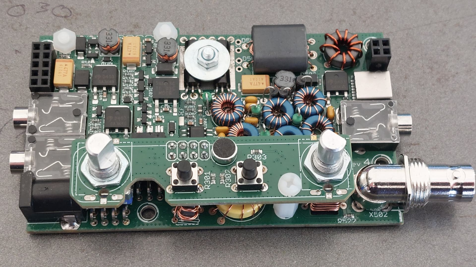

I took the step and joined the dark side!
I wasn’t mega excited about the QMX when first announced and then I’ve mostly heard tales of woe about the rig.
I’ve patiently waited for over a year and I felt that the QMX is now mature enough to give it a try. I received the shipping notice on 31st December 2024 after using Christmas money from my XYL’s mother to place my order with QRP Labs. The kit arrived on Tuesday 7th January in good condition and very well packed. I opted to use the DHL shipping option.
I manged to do three sessions of construction spread over three days, each of around 2 hours.
I thought I’d messed up loading the firmware as I accidentally dragged both the unzipped firmware file and the zipped firmware folder across to the QMX. Supposedly the expected behaviour is that the QMX self resets after successful firmware delivery. My QMX just hung. I thought I’d bricked it.
Reluctantly I removed the power supply lead and then plugged the QMX back in and pressed the power on button - amazingly the QMX sprang to life and proudly showed firmware 027 on the LCD.

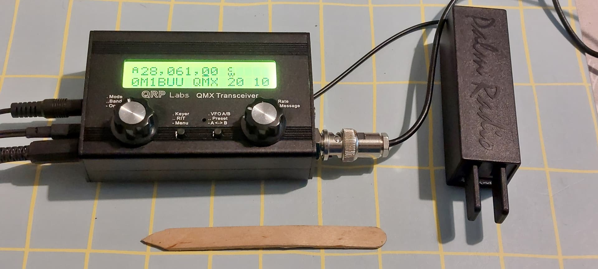

Using a wooden stick as a pokey tool as I was able to adjust the low pass filter inductors, as needed, to get at least 4 watts out on every band using 12v as the supply voltage.
Initially I thought the QMX had a fault as no power output was showing on computer diagnostics page and also there was very little audio making it in to the computer. However I think it must have been user error or maybe RF pick up on the USB cable as I gave it another try on a different day and then everything worked as it should.
I think investing in a really good USB cable would be a good idea.

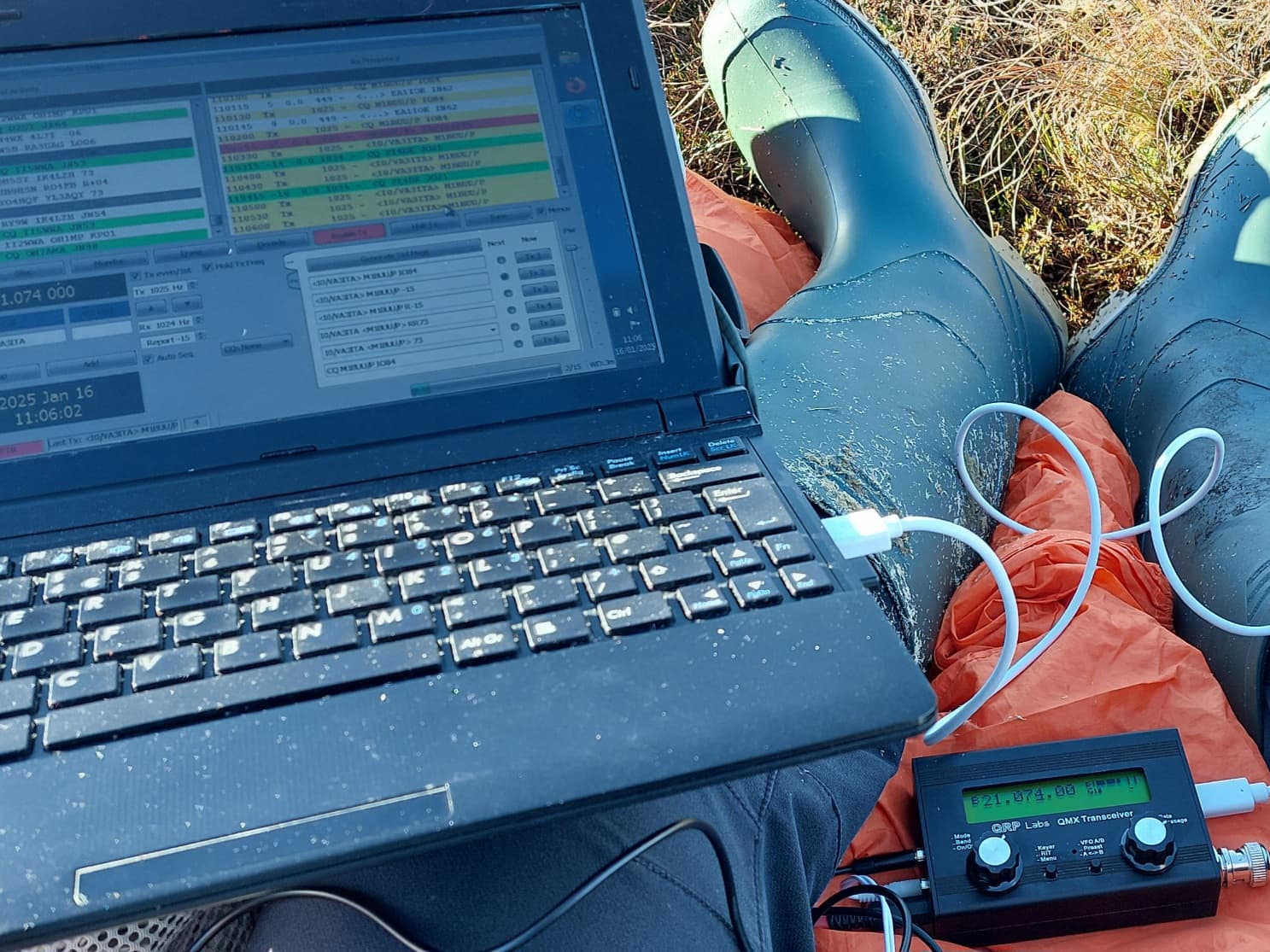

I gave the QMX a test run on 15m this morning from White Hill G/SP-006 and it seemed to work ok although I wasn’t keen on the audio from the rig on CW mode. I think I should be able to get the audio more to my liking by playing with the filter and agc settings.
So, that’s it, I’m now a member of the QMX club!
73, Colin
Good signals into Pickering Colin, 115 Km. Sounded like ground wave on 21061 KHz but can never be sure on HF. It looks like its another successful home construction project, well done.
73 Phil
You sounded like DX, as you do on the higher bands. Quite a bit of echo. I’m not knowledgeable about propagation but I’d suggest some phase distortion due to multiple paths.
I felt HF was different to how I expected it to be today, I set my dipole broadside to Whernside, which I could see, and yet the signal from Richard @G4TGJ on G/NP-004 was weak and noisy with me. We exchanged mutual 559 reports. It was LOS! I expected earbending 599+. Weird.
73, Colin
