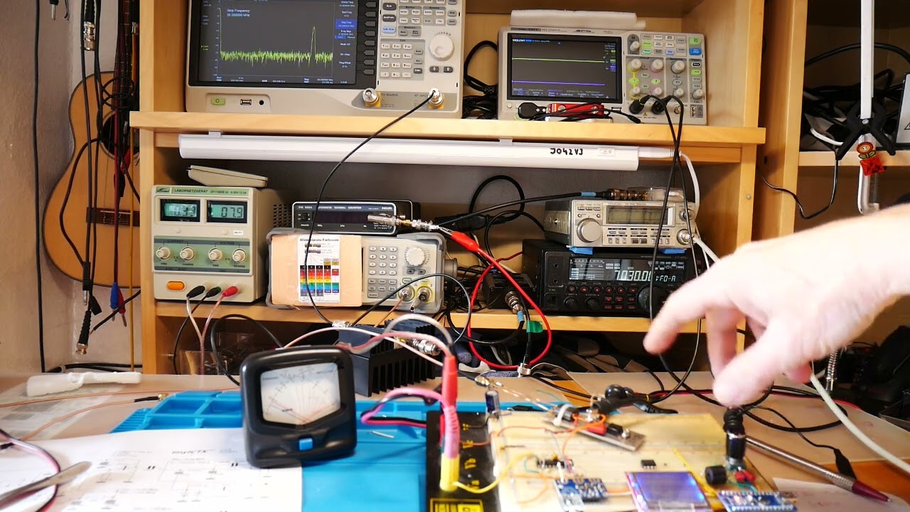

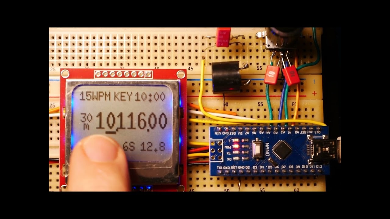

At the moment I am developing a small cw trx for 80m to 10m. I’m still at the beginning and concentrating on the tx and the software. Here is a longer video on how to use it, unfortunately in German, hi. :grimacing:
Hallo Chris
…das sieht ja jetzt schon super aus… da bin ich ja gespannt, wie es weiter geht.
Die Einstellungen gefallen mir richtig gut!
…that already looks great… I’m excited to see how it continues.
I really like the settings!

Now I make the next step for my homebrew t(r)x. 3-4Watt out at 7.9V from 80m to 15m and up to 10W at 12V.
