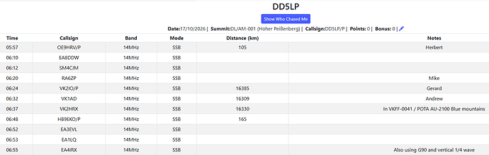

Conditions were not as good as hoped, possibly due to the Coronal hole (QSB started to be a problem, later in the activations as well). Tuning around to start with around 0540 UTC, I had booming 59 signals from some DX home stations, ZL1KBA, VK4EEC and VK7ACE, certainly being strong enough to work easily had I been able to get through the pile-up of European KW stations with 6-element Yagi antennas!

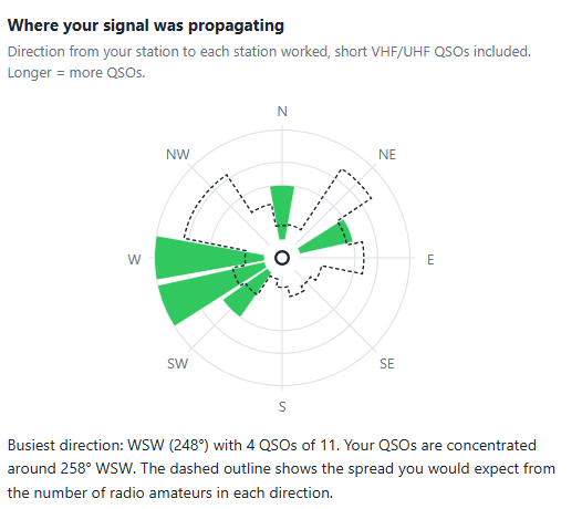

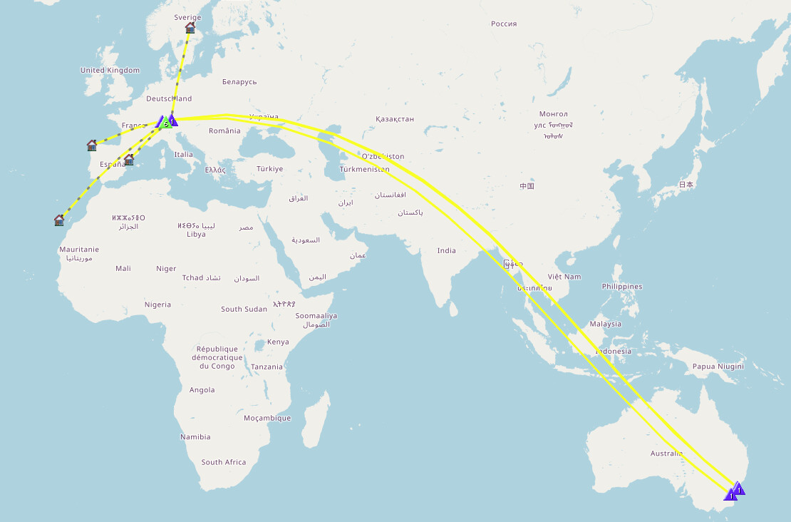

I’m happy to report two EU S2S contacts with Austria & Switzerland and, indeed, thanks to the hard work at the other end, I am sure, three S2S into VK with Andrew VK1AD and Gerard VK2IO. Compton VK2HRX was in a park AND on a summit, Riley’s Mountain in the Blue Mountains National Park; it was very nice to get a contact with him S2S & P2P after so long (DL/AM-001 sits on three POTA trails).
The spotted UK SOTA stations were completely inaudible on the band from my summit (skip distance perhaps?).

Corrected Map with long path, thanks to Duca, YT3MD - see his QSO story announcement here:
