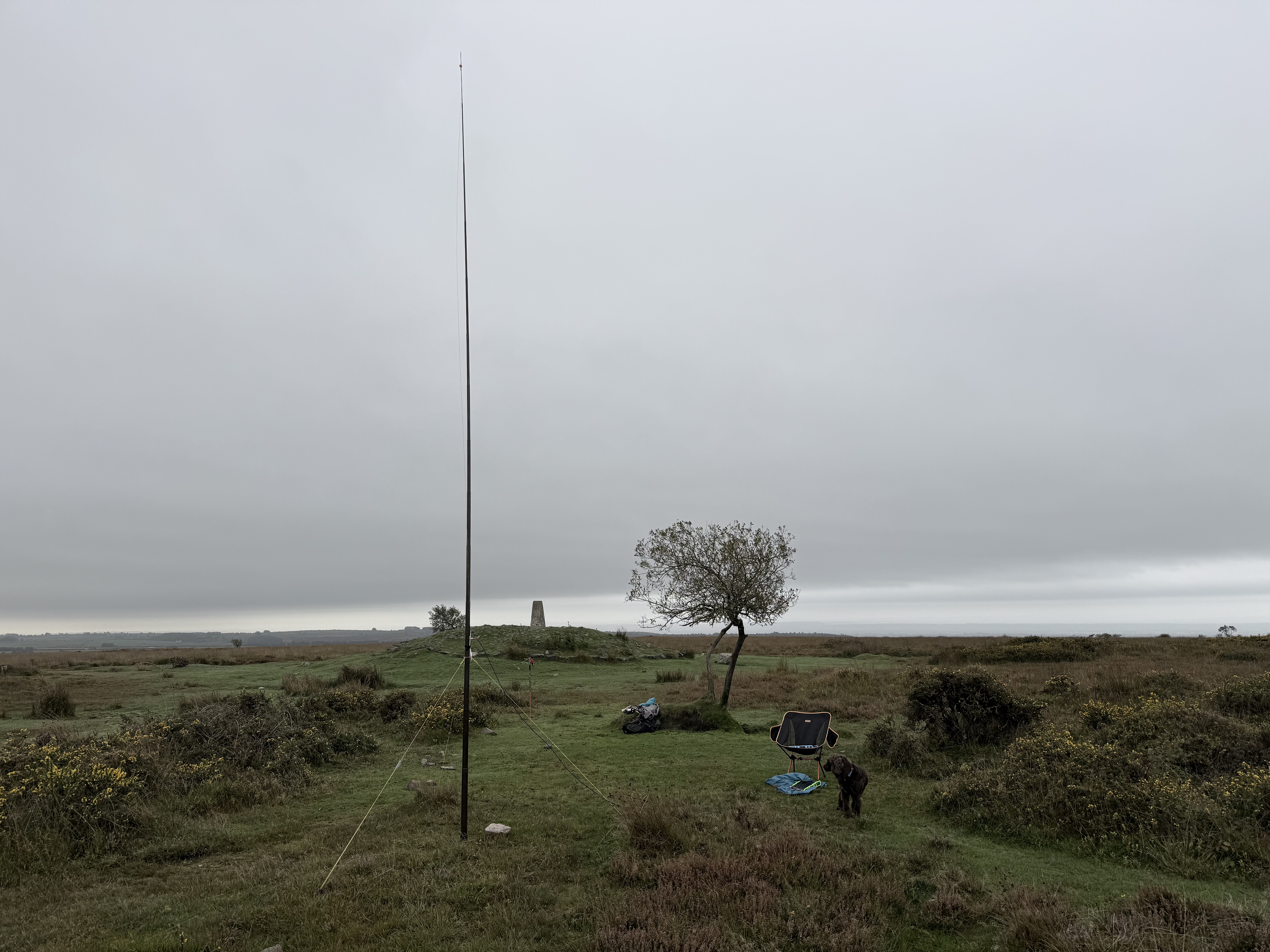

WX somewhat pish and rather Autumnal. Was 25% blue sky but soon heavy overcast. Average wind speed 22mph with 40mph gusts
 not conducive for the bendy 5.6m Chinese whips. And I didn’t wake up in time :blush:

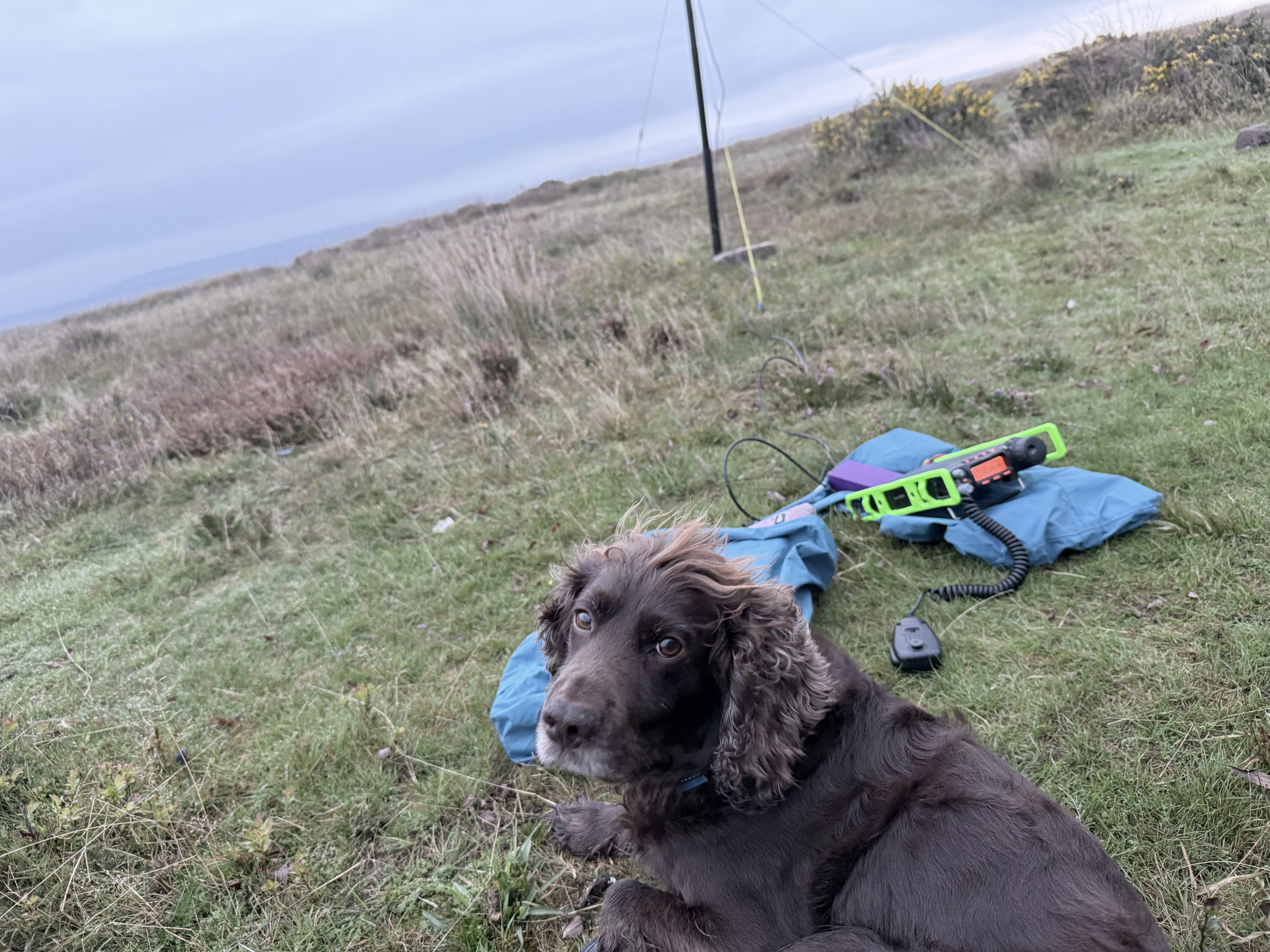

Thank you all for a fantastic morning working so many VK stations from G/SC-003.
FT891 today with a 1/4 wave vertical with single elevated counterpoise/radial. Recycled Vape batteries providing 100watts !

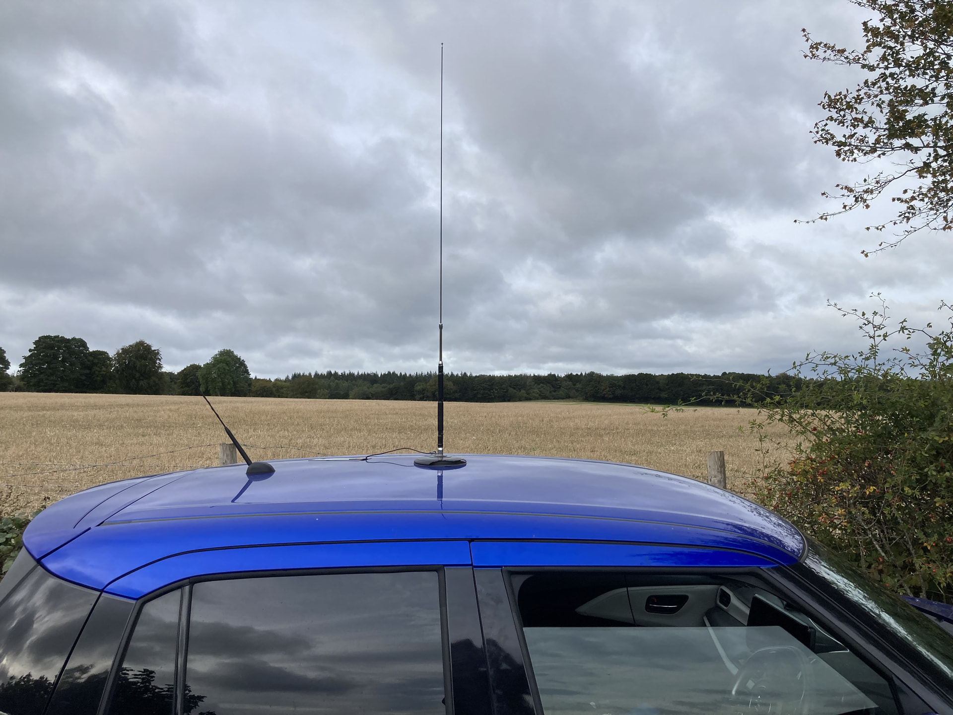

Thanks to all who have raised interest on the reflector. I decided to get up early and drive to a local quiet spot to have a listen. I didn’t have high expectations of being able to work the DX with a mobile whip, but was delighted to get @VK1JIM & @VK1DA on the key at the tail-end of their respective pile-ups. Thanks both! Really made the early start worth it.

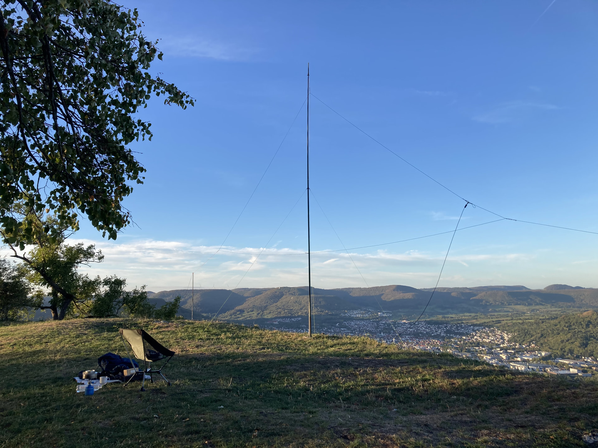

Abstract:
Summit: DM/BW-099 (Achalm)
QRV: 05.45 - 7:30 UTC
Rig: Elecraft KX3 @ 15 watts
Antenna: Delta Loop right at a cliff facing VK/ZL LP
Band: 20m
QSOs per mode: 11 x CW, 6 x SSB
QSOs per country: 10 x VK/ZL (3 x S2S); 6 x EU; 1 x JA
Weather: ~ 10 °C, light breeze
Sunrise: ~ 05:10 UTC
Wow, that was fun!
perfect weather here and a great 20m LP opening.
My first QSO was actually more of a chat with Andrew @VK1AD on VK2/ST-001, followed by QSOs with @VK3SQ, @ZL4NVW, @VK1MA and @VK2DAG.
Then I tried to get a summit-to-summit QSO with @VK1JIM and experienced the same as Remy, F4LEK reported: a huge pile-up of EU stations which wasn’t easy to get through. More on that below.
A run on 20m CW resulted in a summit-to-park QSO with @VK2IO and QSOs with @VK2ZRD and two EU chasers.
Rather late I found Andrew, @VK1DA for another S2S QSO on CW and was surprised to be called by Hiro, @JG0AWE shortly after.
Sadly, I missed VK3PF whom I couldn’t hear on his spotted frequency and VK5CZ.
