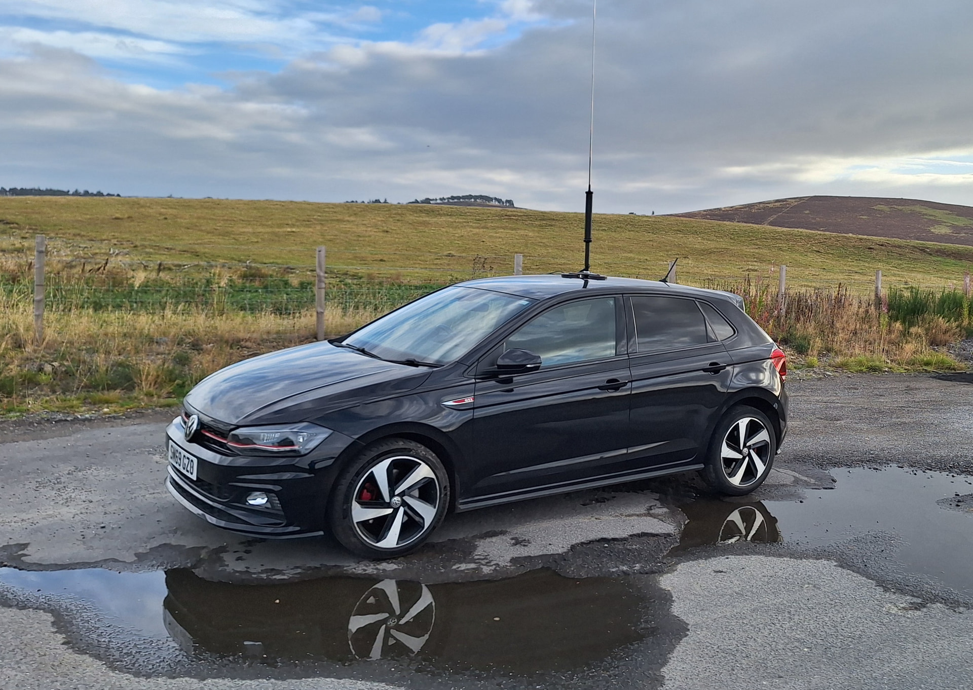

I have a new vehicle mounted HF antenna to test. I was planning an outing at 0600 UTC Friday to give it a try, with a 100W radio.
I’d love to chase a summit down under, should anyone be around. It will feature in a video I’m doing for the RSGB.

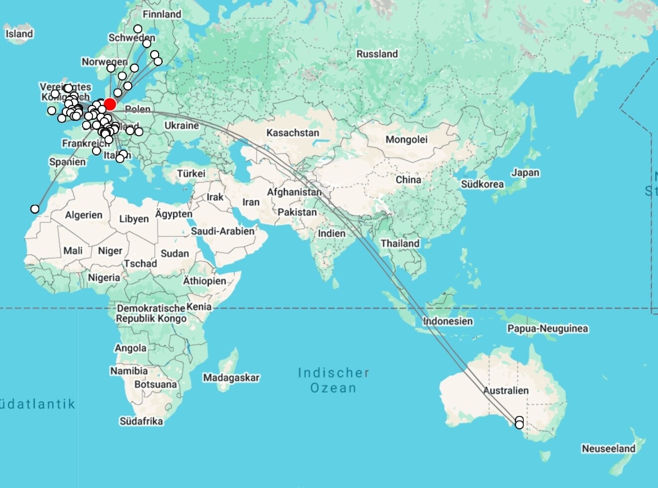

I heard five different stations from VK, all of them running more power than you (up to 10 W).
My antenna is a vertical on the roof, comparable to a SOTA setup on a hill.

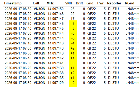

VK3QN produced the most consistent reports. He was getting through already when I turned on my WSPR Rx around 5:45 UTC, running 5 Watts, though.
Condx seemed okay but not great. Otherwise I should have been able to hear you. I’ll leave the Rx switched on for the next few days…
73, Roman

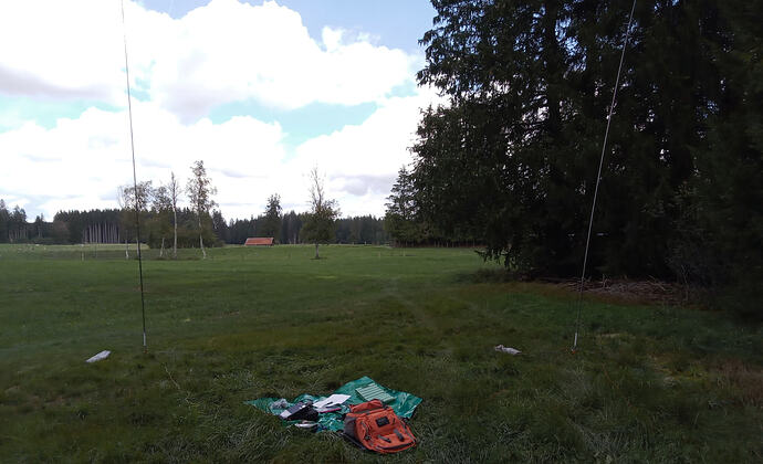

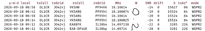

As part of my preparations today, I compared two antennas on the 15m band. For several days now, the 15m band has been open to Japan around midday. Luckily I was more often chased in the days mostly by JS1MXV and Takeshi JS2TNW. Tnx, dear OMs!
A 20m-long EFHW configured as a slight inverted-V, strung between dead trees at the edge of the woods.
B An 8.5m-long vertical EFHW. It consists of a 7.5m element resonant on 15m, followed by an inductor on a toroidal core acting as a loading coil for the 20m band, and finally an approximately 1m wire extension. The inductance of the loading coil was specifically calculated so that, in combination with the wire sections, it functions as a trap for 21 MHz.
The test relied on the signal from the Japanese caller, which I happened to hear. The vertical antenna was about 2 S-units louder. But have a listen for yourself.

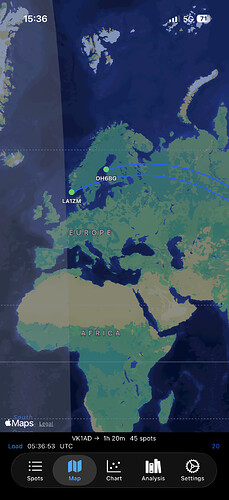

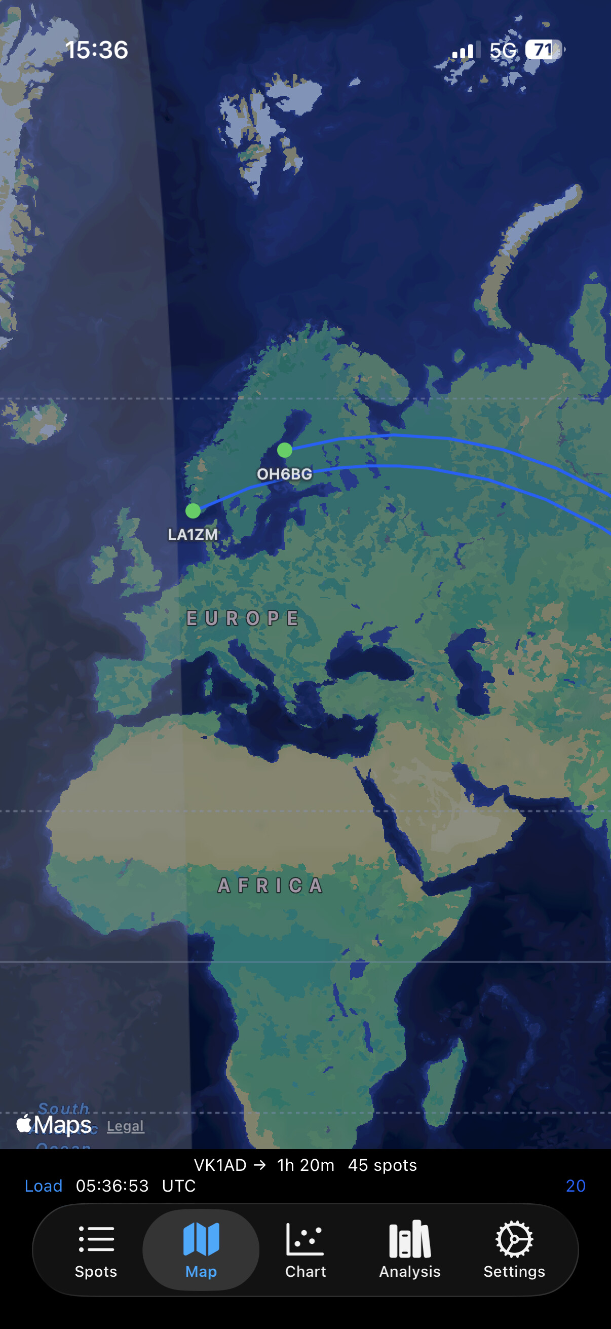

First EU stations at 05:30 UTC. VK1AD 20m 200mW WSPR beacon.
Edit: 06:00 UTC
Edit 06:15 UTC - now includes the UK.
I will save you from further screenshots.

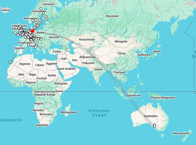

I also checked out my 2-element vertical parasitic array yesterday at a POTA 4-fer, ready for tomorrow morning and October 17th on DL/AM-001

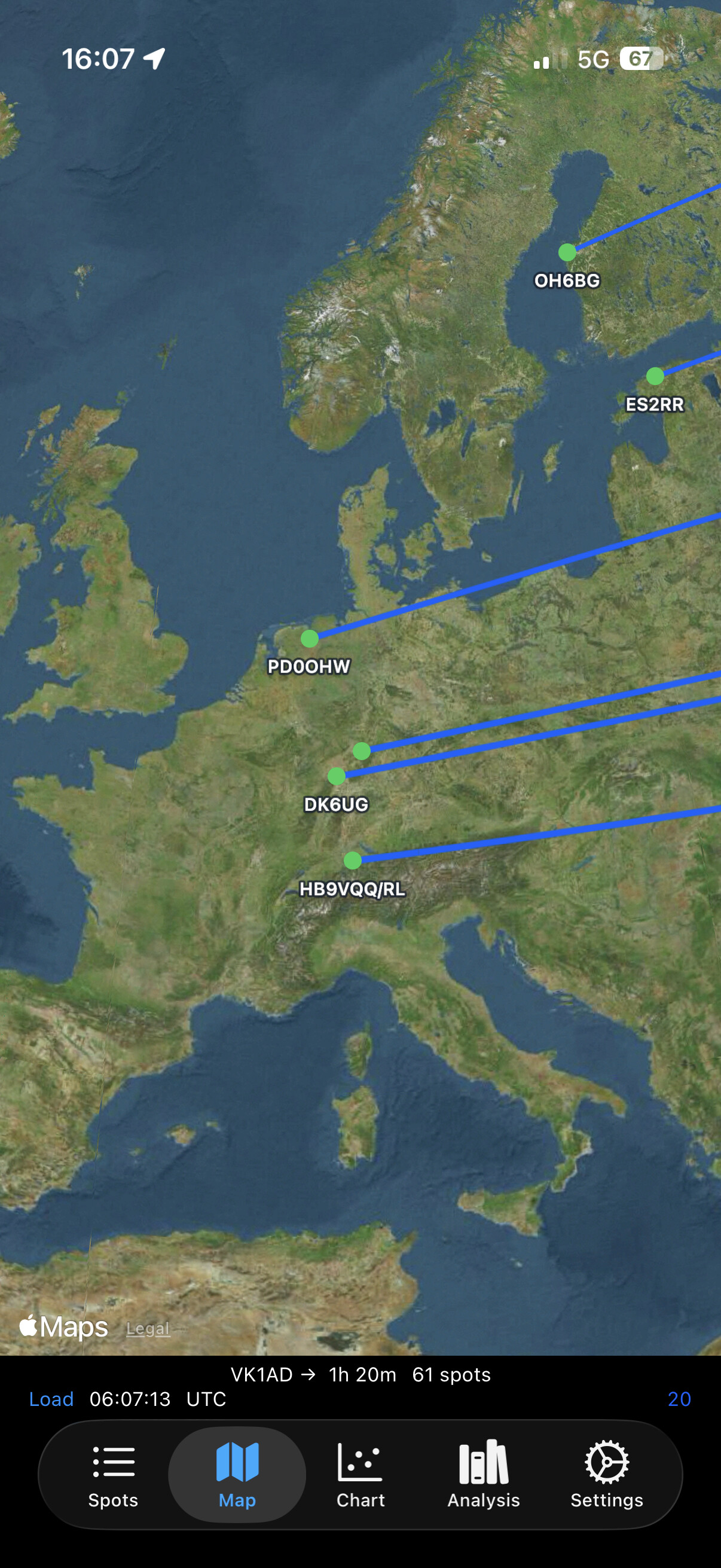

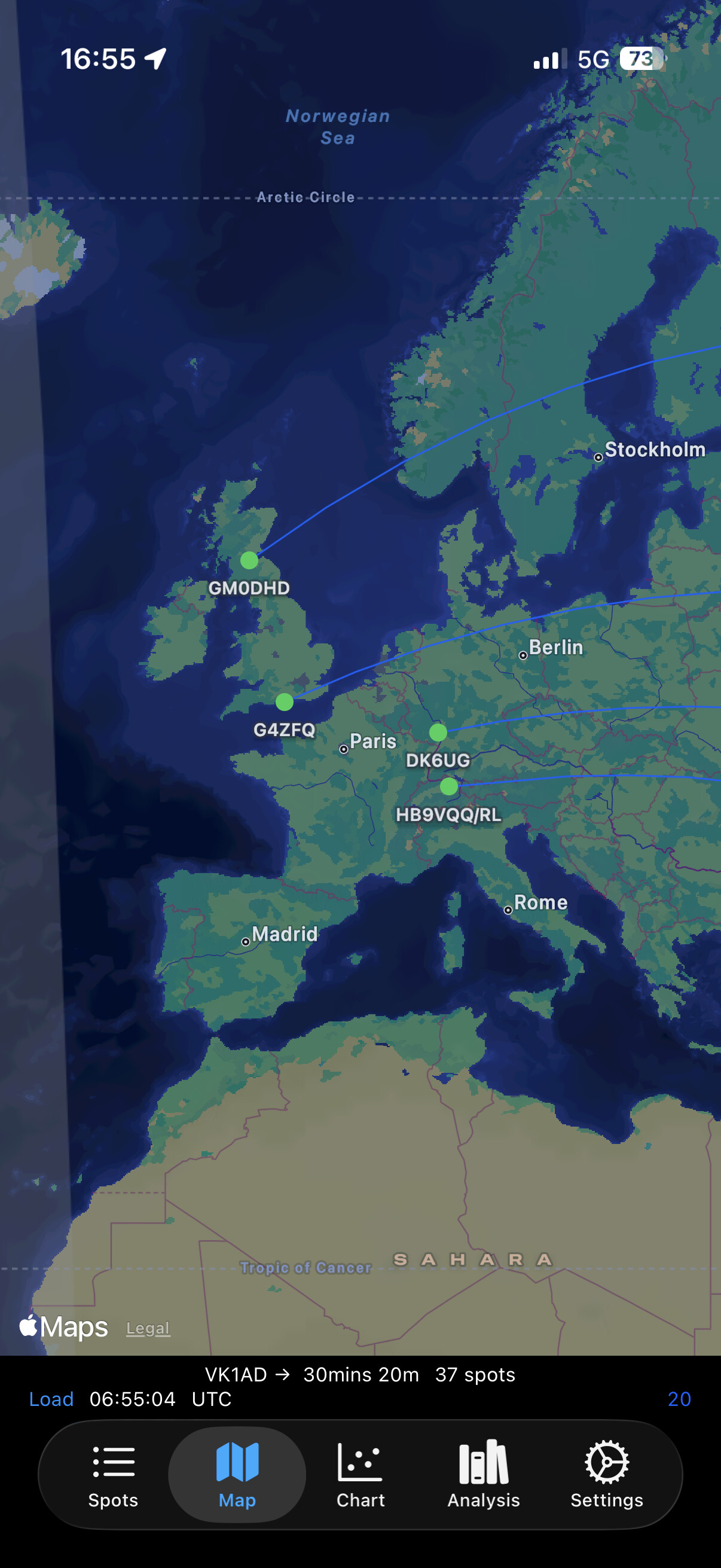

Hi Andrew,
Remembering that the VK/ZL signals are coming in from the West (the left-hand side of your graphic), you would expect stations in Scandinavia and the UK to be the first to be heard on the long path; but that is not the case, and there is also a South-North progression, with stations around the western end of the Mediterranean Sea being the first heard in VK/ZL, then central Europe and then Northern Europe. There can be up to an hour difference between a Spanish and a UK station being heard in VK/ZL. In part, it depends on where the signals cross the American continents; passing through Central America has the least landfall in the signal path, so a stronger signal is heard earlier.
I was surprised to see Scandinavian WSPR stations being the first to record VK signals however perhaps these two stations simply have better receivers, are in better locations or some other factor may be affecting the result. I note the LA station is very near the grey line.
73 Ed DD5LP.

The exact opposite of my experience. Always Poland & eastern europe first to get the openng, tracking WSW with Spain & UK an hour or so later, generally right on dark.

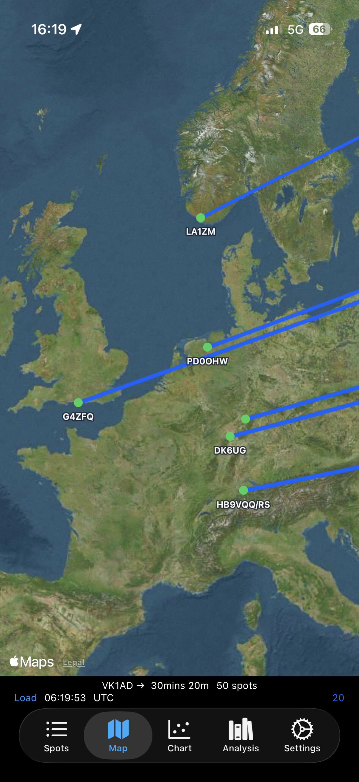

Hi Ed
Look at my activation report from last Saturday. Poland first and much later Spain. The propagation moves from East to West, the same path as the sun.

As I was inside the Cairngorms National Park area, I put a POTA spot on 20m SSB.
That worked!
