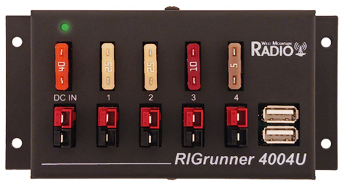

West Mountain Radio will have a new RIGrunner 4004 in September. http://www.westmountainradio.com/product_info.php?products_id=rr_4004_c
73, Hans PB2T
That looks perfect - similar to the discontinued SOTAbeams Phonepole.
Perhaps not the cheapest solution, but probably the neatest.

Rigrunner 4004U is £69 used at an emporium in Barnsley.
Does he have one though as the advert in the US says “The estimated release date is September 1, 2020” ?
And even though it’s in a nice box etc, £69 for 4 powerpoles and dual USB is bordering on Dick Turpin territory.
That is most likely the old version with 1 Amp fuse. It’s good for a phone but not for a tablet.
Says 2 in stock.
or you could buy new @ £109.95 if you really need one. (from the emporium down south & son).
the spec says “Each fuse has a blown LED” I would hope they replace them FOC.
