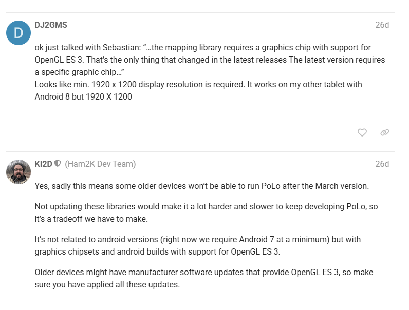

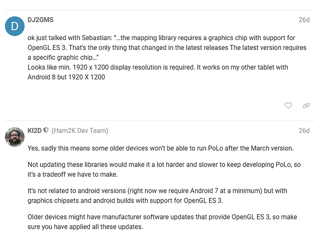

Unfortunately, POLO has stopped working for me.
This is Sebastian (the author) 's explanation on the POLO Forum.
So unless your Android SmartPhone / tablet supports OpenGL ES3 - you will no longer be able to run POLO. (As Sebastian says however, check that there isn’t a software update for Android from your device manufacturer.)

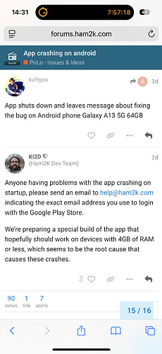

My Tablet has 4GB of memory, and that is also marked as incompatible now (most likely because of the video requirements). I first thought it was a memory issue, as I have had issues before with loading SOTA data into POLO on my 3 GB LG phone, until Sebastian kindly made some changes in the code.
Let’s hope a later build will address both issues (but I suspect the new video needs will be harder to get around).
For now, an automatic update stopped what was a working program from working (the danger of having automatic updates turned on!).
