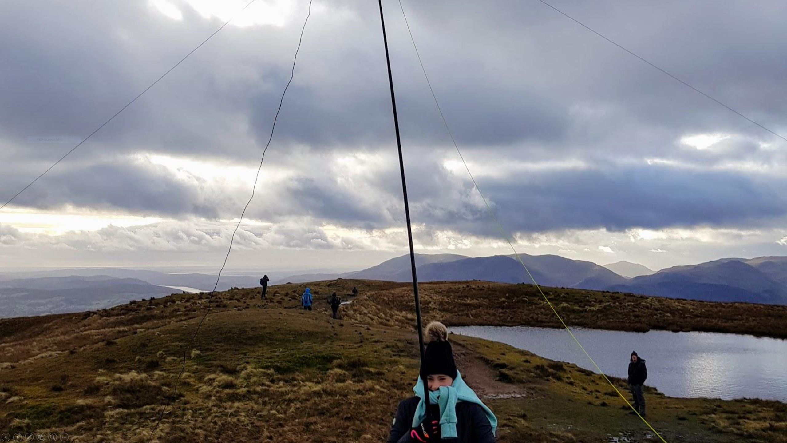

This also means I can’t use members of family as temporary antenna supports unless operating QRP…
Ahh but surely working as an antenna support she’s become an operator working under your supervision/callsign? :wink: :slight_smile:

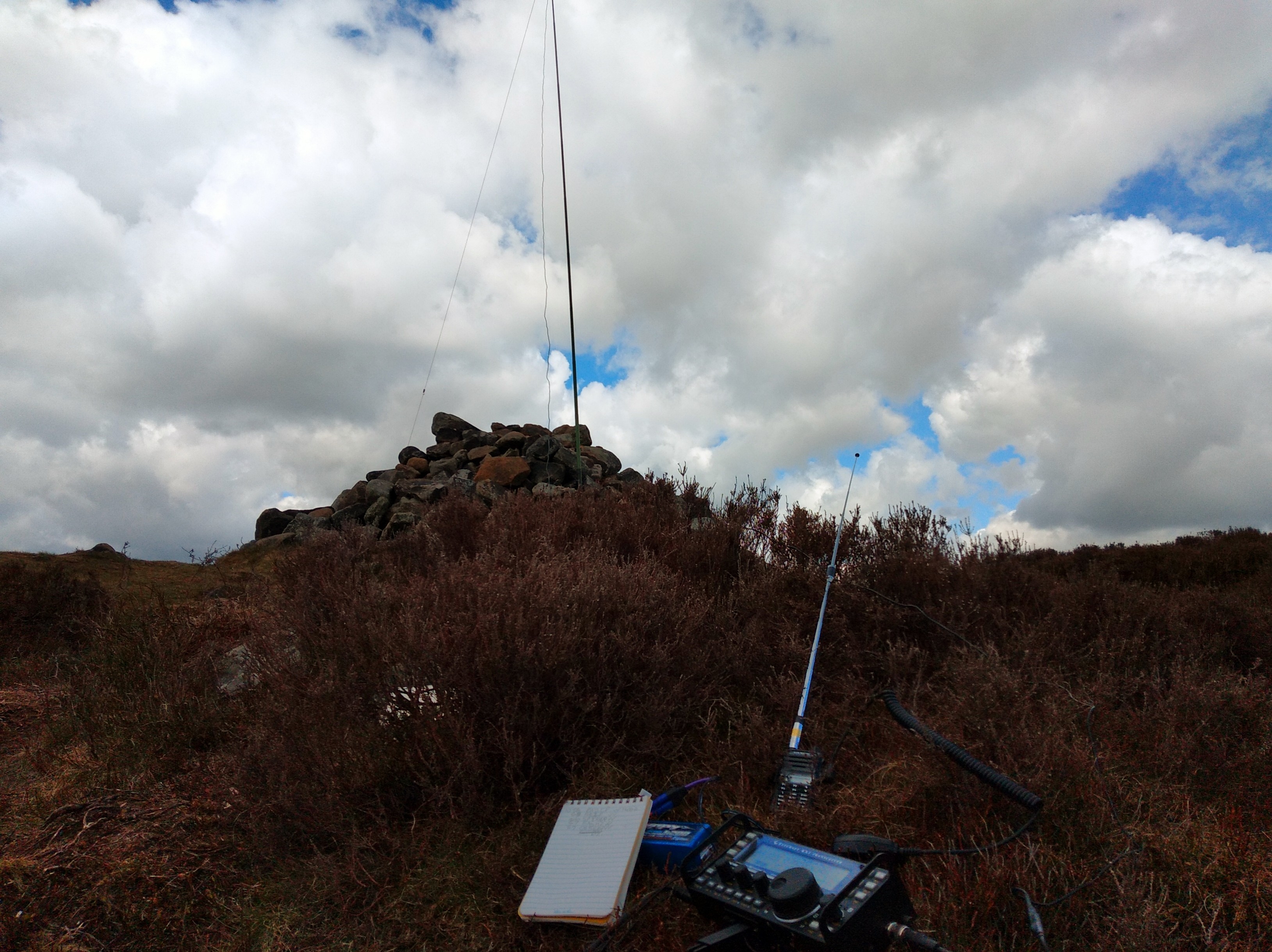

Just back from a cracking activation of G/TW-002 Cringle Moor and eating a cake I got from the Lord Stones Cafe at the car park with my sandwich back at home. Cinder Road - like Rocky Road but containing more Belgian Chocolate - nice. 63 QSOs with several S2S - best and most productive band was 30m Best DX was K4DY on 20m CW, pretty good to work USA before UK lunchtime. 20m and 40m becoming a little more like summertime condx - I worked Don G0RQL on 40m SSB.

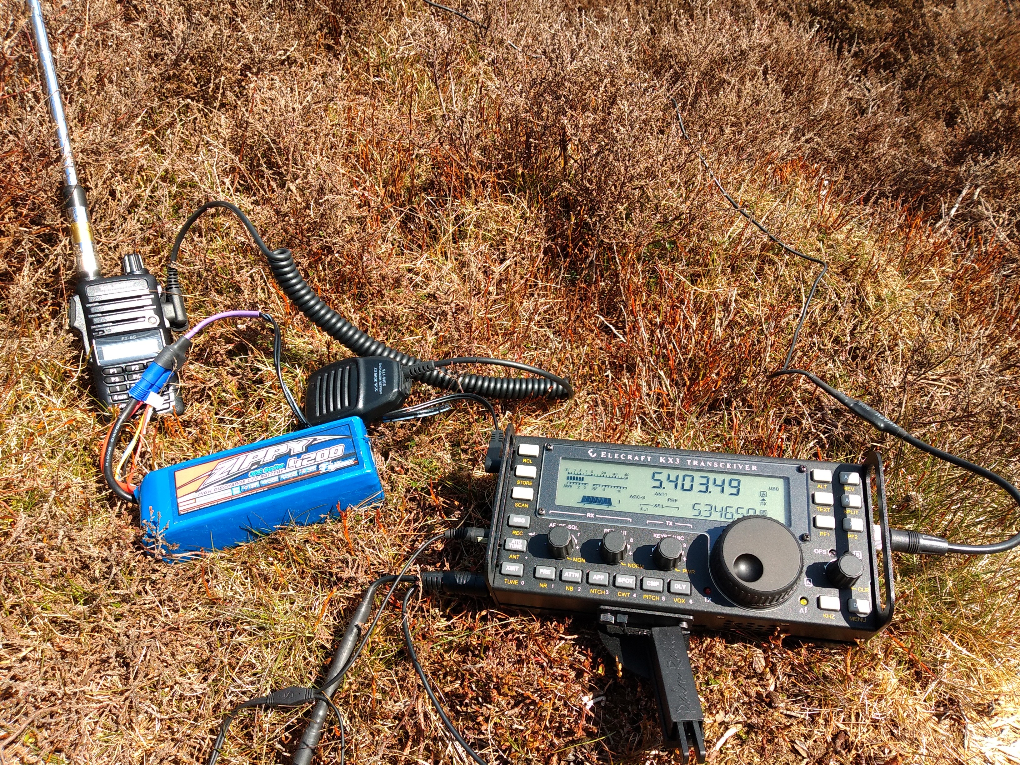

Yes, I am enjoying a secondhand KX3 I bought about 5 weeks ago Dave, it is in mint condx and gives a full 15 watts output with a plug in Zippy 4.2 amp LiFEPo 13.8v battery - 10 watts out with my other 12.5v battery (3 X 18650), she throttles back herself when the lower voltage is used. She also came with 8 X NiMH batteries and charger. I sold those on ebay. Very poor output and too heavy for carrying. Even lower voltage with those internal batteries and she throttled back to 5 watts, so not a good option. I bought the KX3 privately with a built in ATU, side plates, roofing filter, 4 amp Tracer battery and charger, KXPD3 paddle and MH3 microphone. I sold on the KXPD3 and MH3 mic as they were of no use to me. Once I got the KX3 I sold my KX2 (without ATU) with sideplates and a home made 18650 battery pack and Loewe case also privately. The chap who sold me the KX3 was buying an IC-705 he isn’t a SOTA player…
