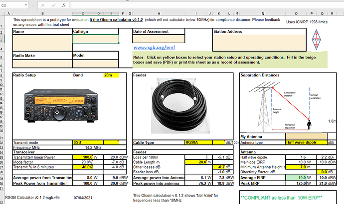

Don’t know about you Phil but no matter what numbers I put in I still get a pink cell saying distance is 1.98 m when clearly my distance in at least 8m. Maybe offcom are worried about flying insects being fried.
Have just had a thought. I wonder if the separation thing means that anyone getting within that distance is in danger and tht’s why it’s in pink as the photo shows

As it says in the spreadsheet the cell is highlighted when near-field assessment is recommended. This is when the “Ofcom Separation” distance is less than the “Near field zone” value. In practice this is going to be the case for pretty much any QRP HF setup. But then many of those QRP HF setups will come below 10W EIRP anyway.

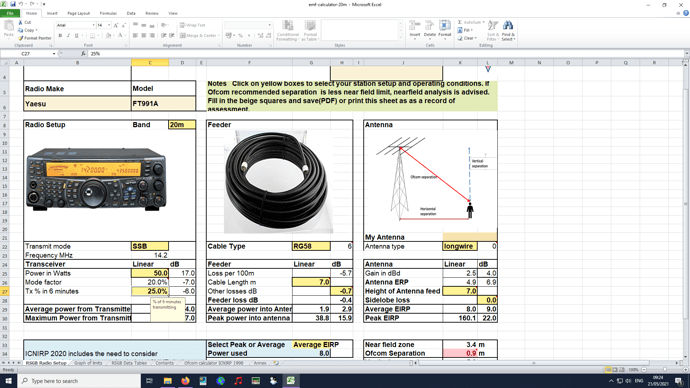

Hi Rod it seems I can’t transmit even using 1 watt . it’s doing my head in mate but I want to do the right thing
If so, your power level is definitely too high.
Hi Richard. I just downloaded the new calculator etc. and filled in all the bands on my max of 50w and they’ve all passed now with flying colours, so I’m over the moon now. Thanks all for their help though it’s really apreciated. :grinning: :grinning: :smiley:
