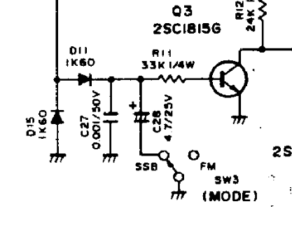

I’m not sure which amp you have but this would apply to an HL-37V. That amp does not have a hard PTT input, all PTT switching is based on RF detection. There is a tiny switch on the back for SSB/FM and all that does is change the time constant for the relay hang time.
You can see it adds a 47uF capacitor to increase the hang time. There’s no SSB/FM bias change over, it looks like the PA device is biased whenever in TX. My thought is someone used it on SSB and the hang time was too short and it was very choppy and they have increased the value of C28 or if they were me, slapped another cap in parallel on the back of the board.
Check the switch (if there is one) and then check for mods/bodges on the board.

Thanks Andy - It is an and I also looked at the circuit digram last night, but decided that the couple of glasses of red wine were not conducive to going further…
Today I looked inside and expected to find about 40 years worth of bodging. (I am assuming it was made in about 1985) and … it was perfect inside the box with no sign of anyone else opening the box at all in the last 40 years. Not only that but there was a clearly labelled circuit board with components big enough to see - even without glasses on! The capacitor was labelled, had nothing else in parallel and was even labelled 4.7 so…
.., a bit more investigation required… Was it the FT-817ND (which didn’t do it on FM) or is the capacitor just a bit too big?
