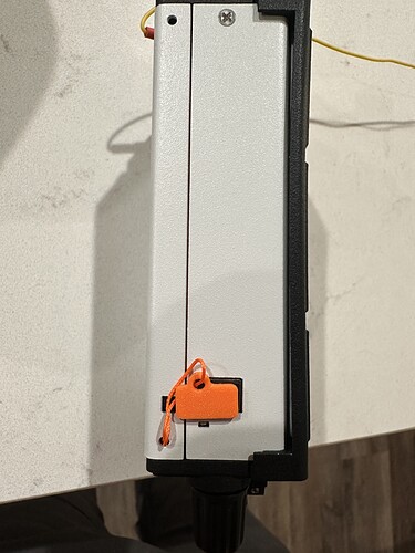

Another op with a 3d printing machine kindly provided one of the switch covers featured earlier and it was worked great for me. I used a very very tiny cord to lash it to the battery cover to avoid losing it.
I can’t open the battery case with the switch cover in place but that part doesn’t matter to me, I just unplug the switch cover if I need to access the battery.

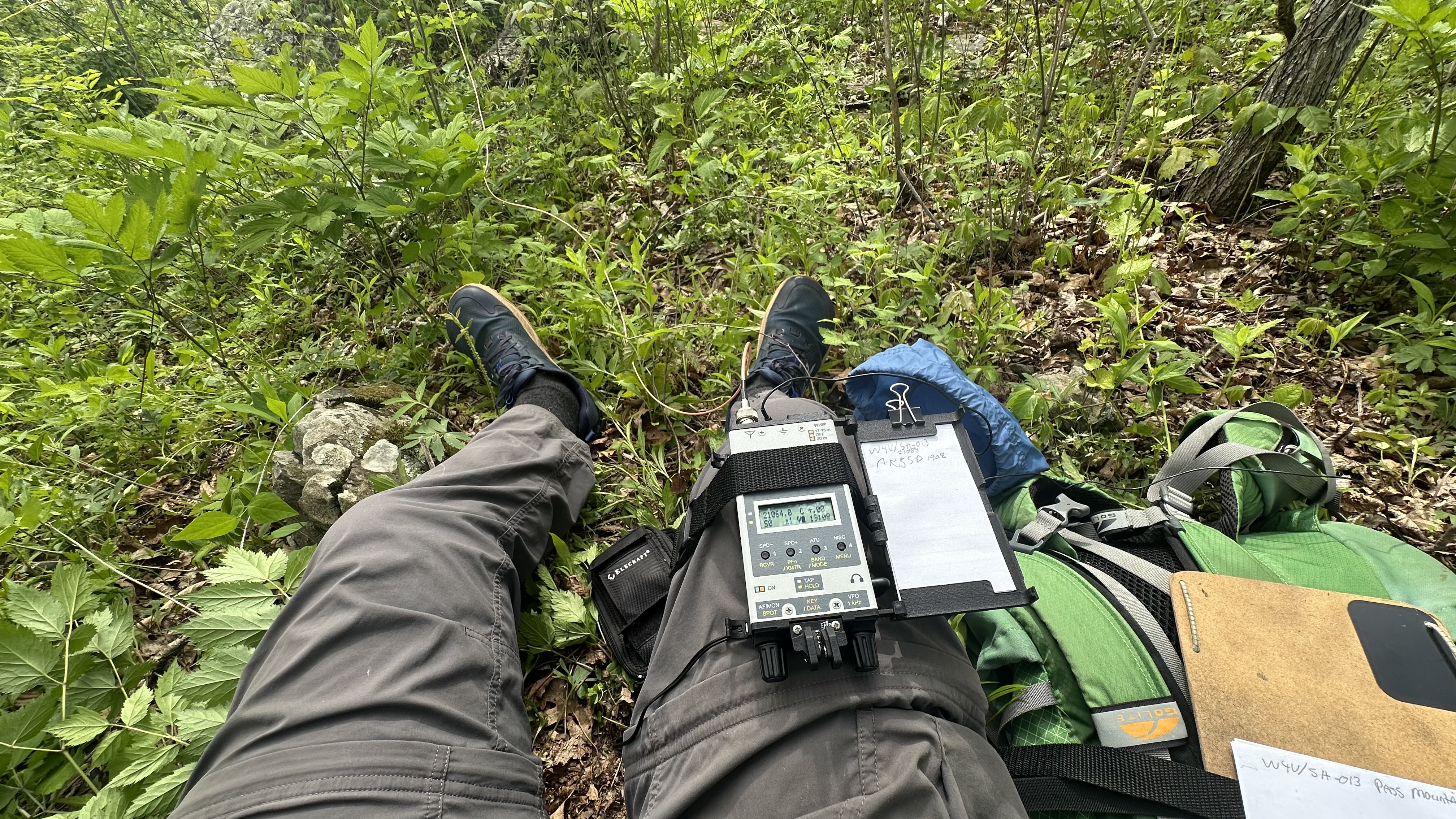

Andy. I have the same problem. I learned to key right handed and write left handed. With KH1, I had to learn to key with left hand so I could hold it with right hand. It was pretty easy to make the change for standing operation. Plus I slow down a few WPM when standing. However, I had already learned to use my left hand for cootie/sideswipper manual key for SKCC.
Also, for SOTA activations, I usually sit with KH1 strapped to my leg and key with right hand. Often I’m on a summit for an hour or more, so sitting is MUCH more comfortable.
