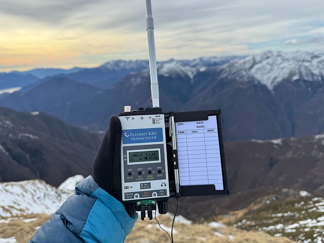

First impression: the rig itself feels solid, operation is easy to learn, the received audio sounds good, and the built-in tuner does a good job of tuning up the whip antenna. The plastic parts (cover, whip and pen clips) feel a bit flimsy to me, the cover on my KH1 is slightly warped, and it looks a bit (but not quite) as if these parts were 3D printed. I wonder how long they will last. At least the whip clips are already available as replacement parts for around $10 :joy:
As others have remarked, the paddle takes some getting used to, as the keying action has a soft/spongy feel to it.
Today I took my KH1 on its inaugural activation. A first activation in HB/TI seemed fitting for the occasion. Pizzo Coca HB/TI-124 was chosen, a summit that like so often in Ticino is not very difficult, but requires a long ascent (1900 m, 7.5 km), and pathless bushwhacking in 35-40° terrain for the last 500 vertical meters. It was nice to have a lightweight rig given the already heavy backpack.
At the summit, a fierce wind welcomed me, but luckily it didn’t take much more than a minute to get on the air with the KH1. I made 20 QSOs within 20 minutes on 20m and 17m. I did not log anything myself, but instead had the KH1 record the sent CW (firmware 1.22). With the soft paddle, cold fingers and gloves on, it was a bit tricky to send cleanly so that the decoder would decode and log it correctly, but aside from @GI0AZB’s callsign, which I messed up several times, it was doable.

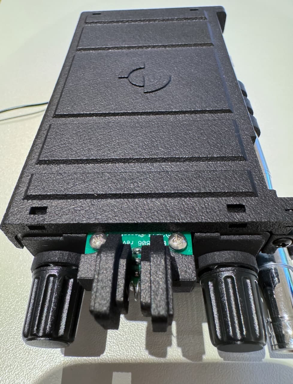

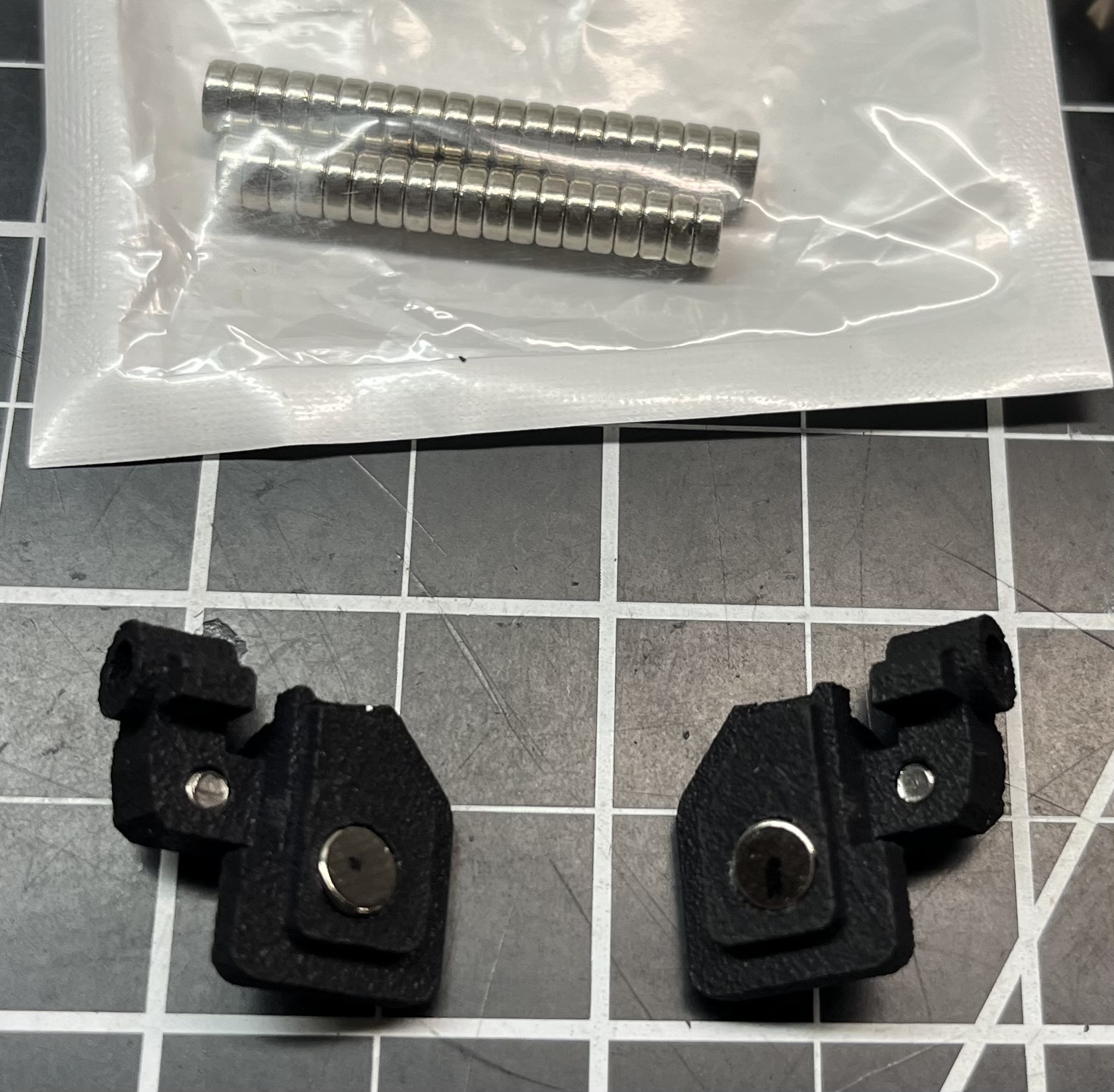

I replaced the spring in the paddle with magnets. This was a big improvement to the ‘feel’.

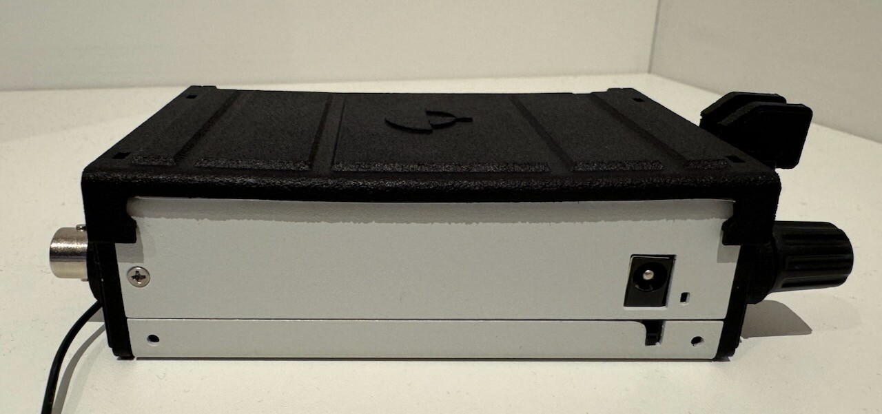

Could you share a picture and the dimensions ?
The magnets are 5mm x 2mm. I used a #9 drill to enlarge the existing spring retention holes on the paddles just very slightly. The magnets are a good press fit into the holes and no glue is required.

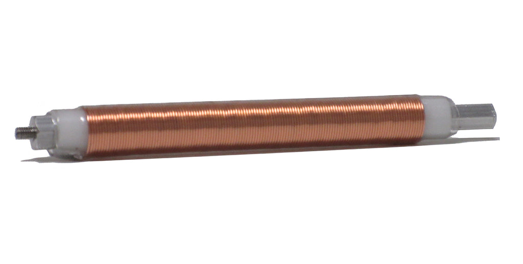

also tried 40m with loading coil
i am verry impressed
Is the loading coil part of the package ?
If not, which one did you use ?
is an extension for ax1 antenna, comes with coil and longer radial
see also

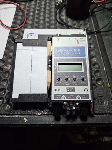

have been on 2000m Summit minus 5°C - orig Elecraft Penball does write
but not shure at colder Days…
so i made a Pencil smaller to fit in KH1 Holder
tried the logging feature - but with KH1 Paddle some errors… so will use Pencil
hoping for 3rd Party Paddle
Maybe you could try the modification with magnets that Josh did (see above) ?
yes i already have some Magnets on order…

my paddles does not only move left/right but rather up and down
noticed that the metal threaded sleeves are little longer as the sleeves of the plasic paddles
so i honed down the metal sleeves and the behavior of the key is better :slight_smile:
i have already magnets on order - so will see when they arrived
