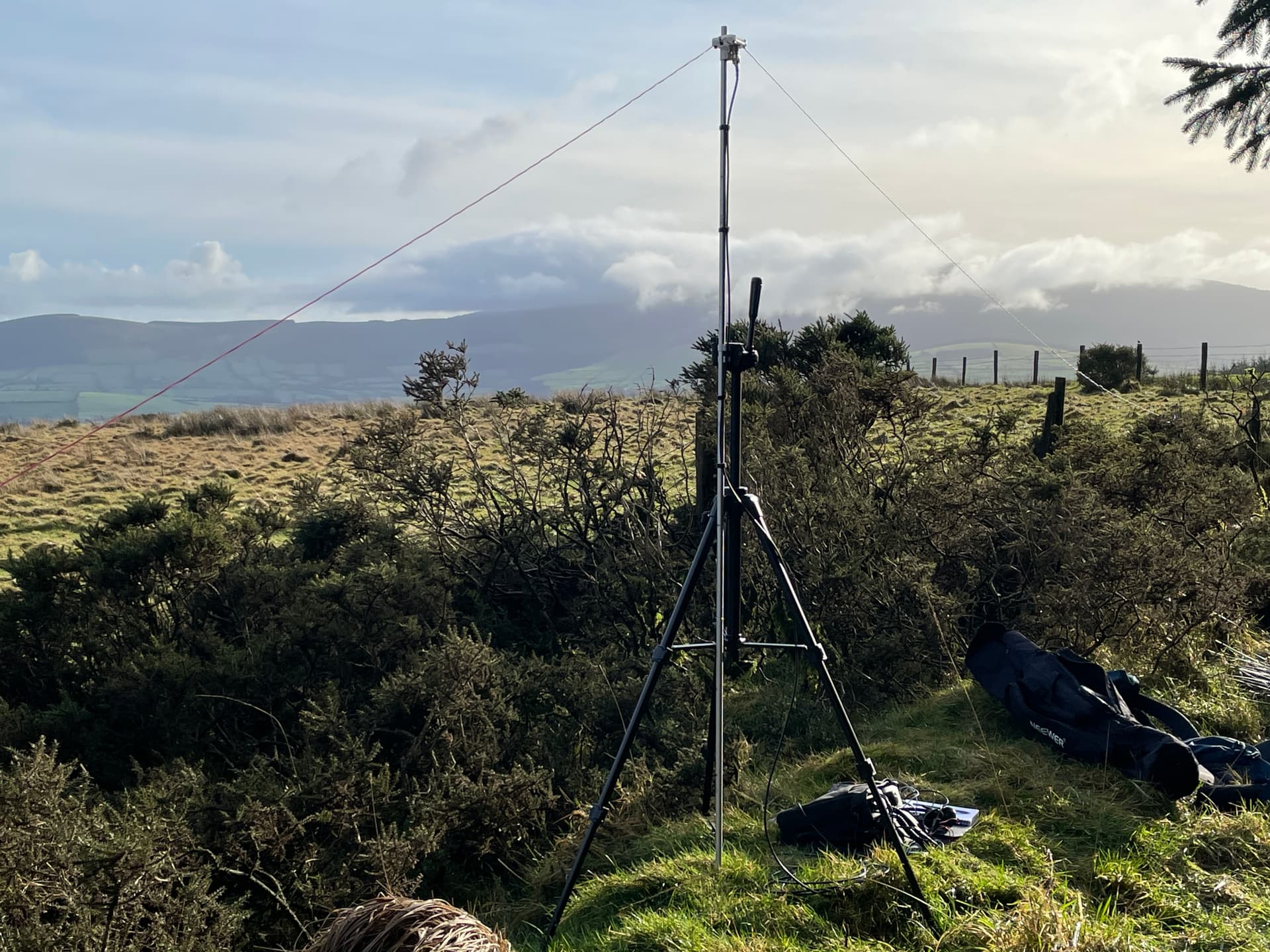

It just happen to be on Sunday 21st, a Winter Solstice day. I had my newly made 20m dipole ready, but never managed to make an extension to the mast, so had to live with only 2m of feed point elevation.

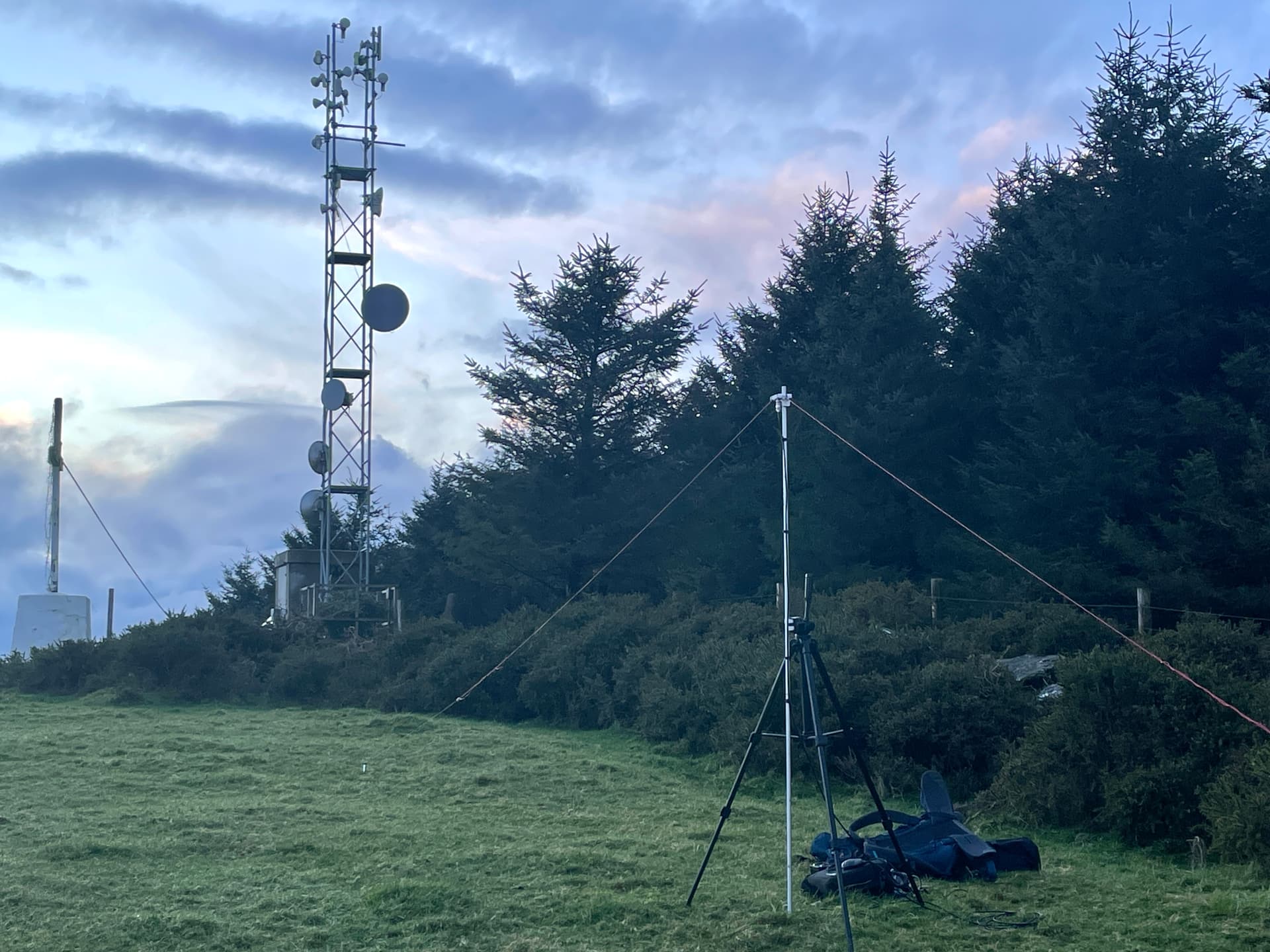

First, I went to a small EI/IE-045 (Preban Hill) 2-pointer. I’ve started with my standard VHF routine, but didn’t get anyone, tried FM,SSB, CW - nothing within 15 mins. Although, worth mentioning a very faint and short CW burst on .050, pretty sure it sounded like HB9 … , however having it on 2m would be too good to be true with current condx.
I knew that my dipole needed to be tuned before use, so I did’t want to waste much time on 2m and moved on to 20m band. First SWR checks showed I am way off with 1:1.0 at around 11MHz. Not a bother, half meter wrap on each side and I am on 13MHz, another half meter and 1:1.0 is all across 20m! I’ve engineered the mast to be supported by my trusty VHF photo tripod and that worked well, resulting 2 meter feed point above the ground with each end at about half meter height.

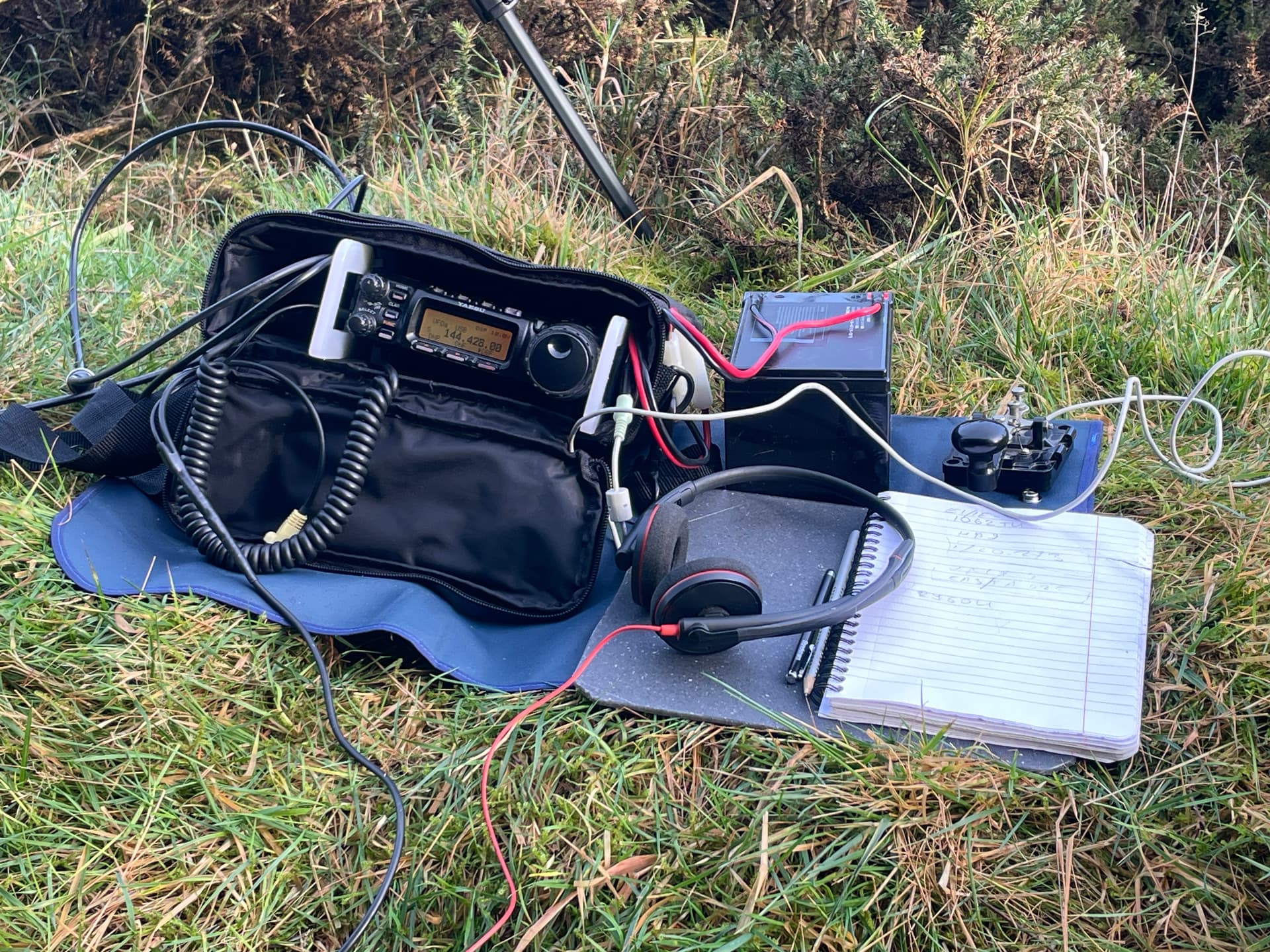

After couple of CQs folks started to pick up with about one or two QSOs per minute rate. I am not used to such ‘pile-ups’ lately, especially in the field, running a straight key full time :slight_smile: My FT-857 doesn’t have CW filters either, only DSP, however turning off AGC made the trick. 19 CW QSOs in 20 mins and I am off to SSB. 15 QSOs there and before wraping up a lonely VHF FM contact logged!

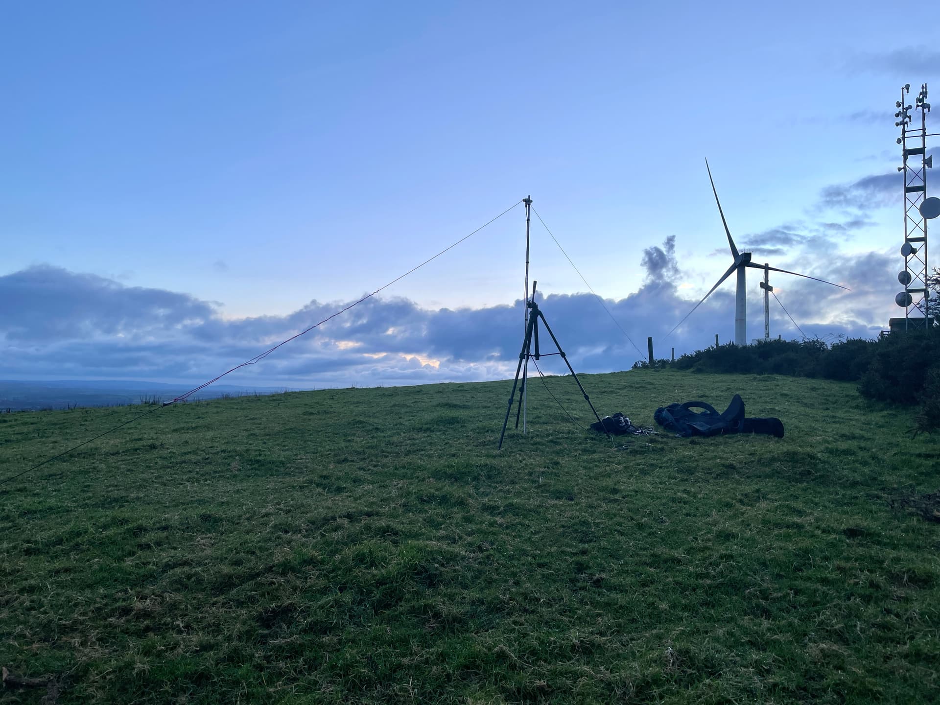

Next, I’ve decided to drive to EI/IE-060 (Gibbet Hill) 2-pointer just to see how the dipole works on another hill. There I had a bit of hassle in tuning. However, after several wraps/unwraps I’ve got SWR set firm at 1:1.0 on the band. CW QSO rate was similar, so I’ve got 18 CW QSOs in 20 mins. Next I’ve moved to SSB and there I’ve got fairly imressive pile-up of 49 QSOs in half an hour!

Great job! Remember that the effective length of the dipole changes with the angle of the elements which is probably why it started out waaaay too long.
For the 20m dipole get rid of that tripod! Use a compact fibreglass telescopic fishing pole - a really cheap one will do to start. Also triple the length of the string on each end of your dipole so that the elements are flatter.
Cheers Declan, I couldn’t tell an S-value as my AGC was off, but your signals were loud :slight_smile: I’ll definitely go down to 40m once figure out the best way though !
Hi Colin, I would gladly leave it at home! The only reason I am carrying it with me it provides a solid portable base for both HF mast and VHF beams, so I can quickly interchange if needed. I was thinking about a standalone fishing pole for HF, but never managed to workout the best way to keep it standing on a flat surface, so went ahead with what I have already :slight_smile:
For a dipole it’s easy. make a mast guy ring (or buy one from SOTABeams) and use 2 guy cords. That way the dipole and it’s cords act as guys in one axis and the two cords from the ring on the mast at 90 Degrees to the dipole keep it from falling sideways.
I must try that Colin! I still have some remaining nylon bits from that Tesco cutting board :), should work fine for the ring.
A guy collar and three guys and three tent pegs. You will find plenty of scrap plastic in your household you can use to make the guy ring. Some 2-3mm nylon cord will make fine guys.
Here’s my setup. 5m fibreglass Decathlon pole, guy ring is about 1.25-1.5m AGL, cords are nice fluorescent ones made for tents with length adjusters in them (about 1.75m long). You can see how it holds up the pole.
Remember, the antenna you have is better than the antenna you want! As you play more you will learn to make antennas using thinner wire, smaller lighter plastic fittings etc. Some people use wire thick enough to jump-start a battle ship when there is no need! Make the individual elements detachable… easier to wind up that way. Don’t support the coax using the connector, make something to attach it at the top of the pole. Dump the PL259s for the simple reason they weigh more than BNCs. For QRP HF you can use RCA phono plugs with no issues if you don’t want to spend money on BNCs.
You really want to get your 40m antenna much higher up and further from the ground as it will be less lossy that way. And finally keep the ends of the dipole at least 1m AGL.
I suppose this is the correct way to go Andy! Although I am not quite ready to leave the tripod at home yet (5 years with it, such a comfort zone!), I’ll come to that in a while I guess. It all comes with experience and a good advice anyway.
