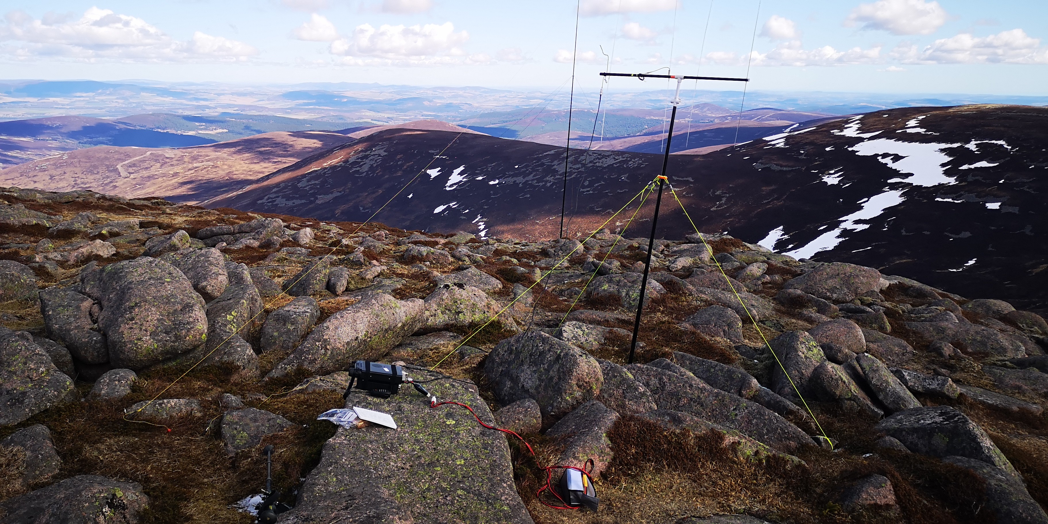

I was at the top in under two hours and decided to set up the W3EDP and also the 2m beam before I started to operate. Summit conditions were brilliant, with no wind, blue skies and sunshine.

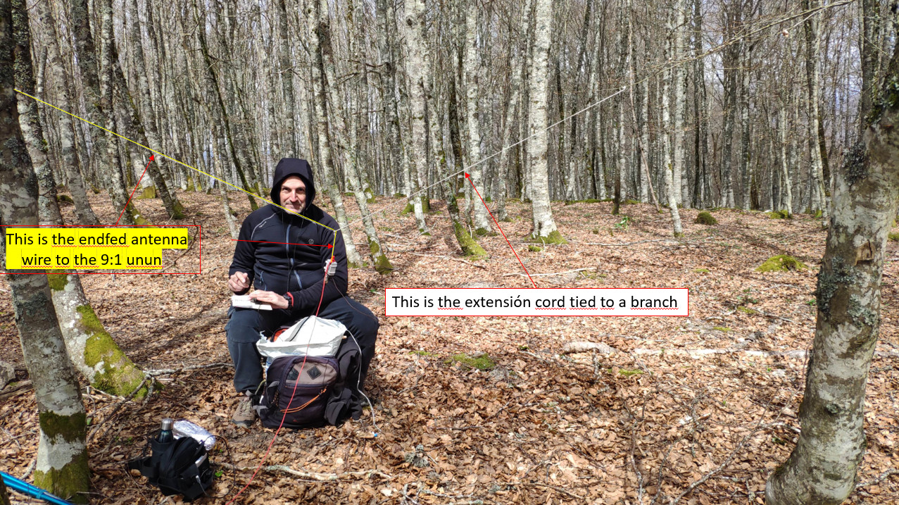

By looking at the picture, it seems to me like you have the last meter or so of your antenna wire on the ground and that’s something I don’t like too much. Why don’t you add a few meters piece of cord to nearly the end of your antenna wire and tie the other end of the cord to a bush/branch/stone in a way that you can have the whole antenna wire fully extended and up in the air, never touching the ground.

The rocks are the problem. I’m not joking, rocks aren’t very conductive so draping a “counterpoise” wire along them provides almost no path to real earth. The counterpoise is necessary to provide the other half of the circuit, otherwise no current will flow into the antenna to create fields between the antenna and ground. Solution may be to add more ground wires, (or just use a complete antenna like a dipole or doublet, sorry can’t help adding that).
This rock conduction problem often causes antennas to stop working, when they were working real well back at home (on a nice moist lawn) or in the park (with good conductive soil all around). This issue causes most of the variability in efficiency and usability of end fed antennas, IMHO.
You can’t get current to flow into an open circuit.

Andrew, Thanks for the comments. I will try a few things differently next time out, including raising the end of the aerial as well as taking account of rocks.
