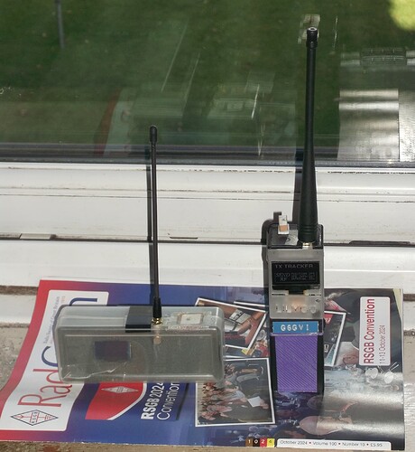

He’s also done another version to work on a LilyGo T-TWR+ unit - which includes a (low-power) radio and GPS. I’ve got a UHF version of this (shown here alongside my T-Beam LoRa tracker):

Yes, but one can now buy an off-the-shelf 439-MHz LoRa tracker from the SOTA shop fully configured with one’s callsign.
And incidentally, although 2m has better range there’s plenty of evidence both theoretically and anecdotal to show that UHF is a better choice in built-up areas like towns and cities, or for densely wooded or hilly area. On recent tests I’ve been amazed how my 70cm 100mW LoRa tracker managed to penetrate dense wet woods to iGates and digipeaters some 30-40 miles away.
