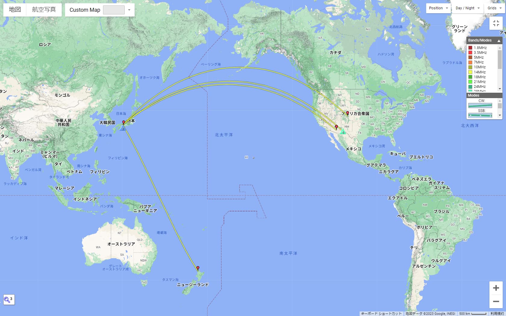

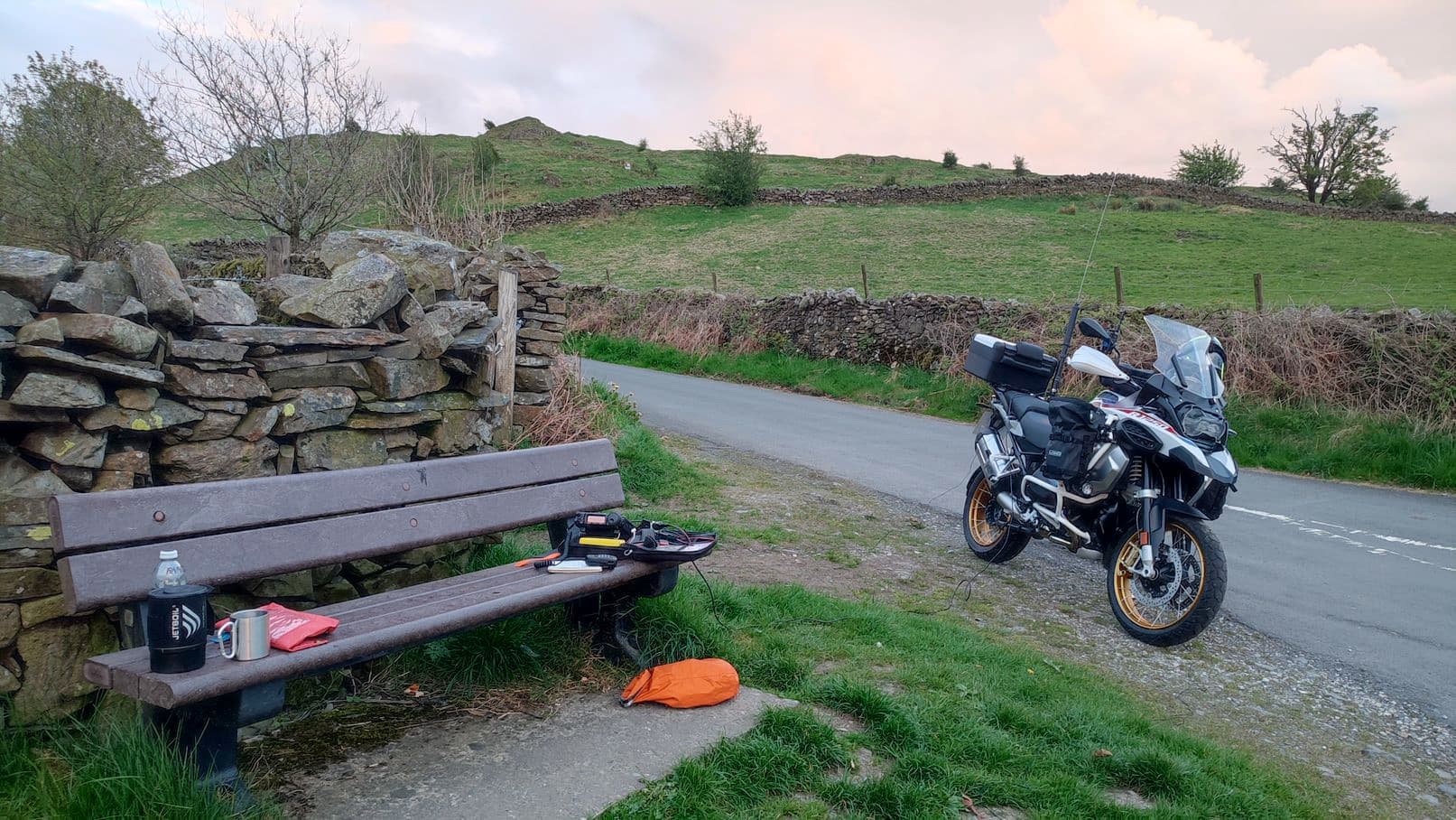

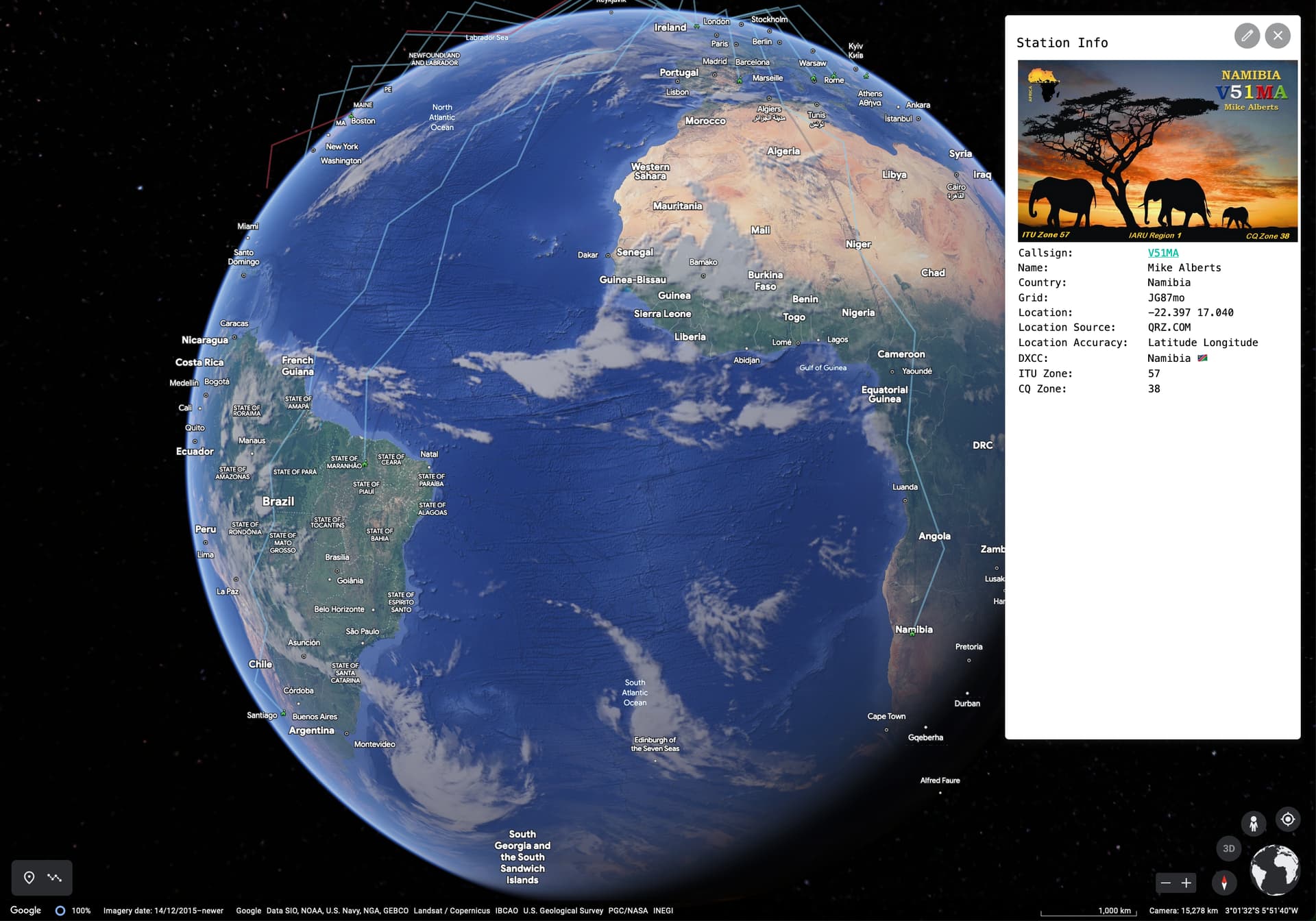

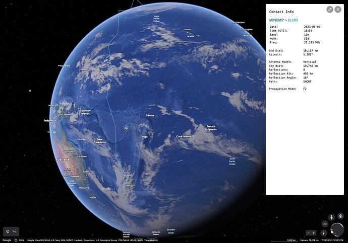

No use to SOTA but on Friday I had a New Zealand contact on 15m using the ATAS-120A on the motorbike. QRP doesn’t work with this antenna, and I usually also attach 3 counterpoises to help with the groundplane. First contact into Namibia too. Nice sunset of the Langdale Pikes to top it off. If I’d been using a non-compromise antenna such as an Inverted V I’d have 100 contacts in the log, not 11.
Given the amount of wire in the air it is very surprising it works, and of course conditions on 15m Friday were very good! You will probably find that a compromise antenna also suffers from severe QSB.
Mark

Very impressive Mark! I bet the traffic keeps out of your way too :wink:
Hi Mark,
That looks like good results on 15m for your mobile setup.
I see you have changed from the R1 to an adventure bike, is this for your planned SOTA/MC tour of Scotland this Summer ?
Never experienced that before on the R1, but I guess it does look a bit motorbike-cop and I have had several incidents of folk pulling over to let me by. I don’t tailgate - I’ve got an Advanced Riders Certificate - but clearly there is something imposing about the setup!
Cheers, Mark.
Definitely!
After a trial run overnight up to Aberfeldy last weekend with a couple of SOTA activations thrown in, I’m off up to do some of the GM/NS hills on the bike at the end of next week.

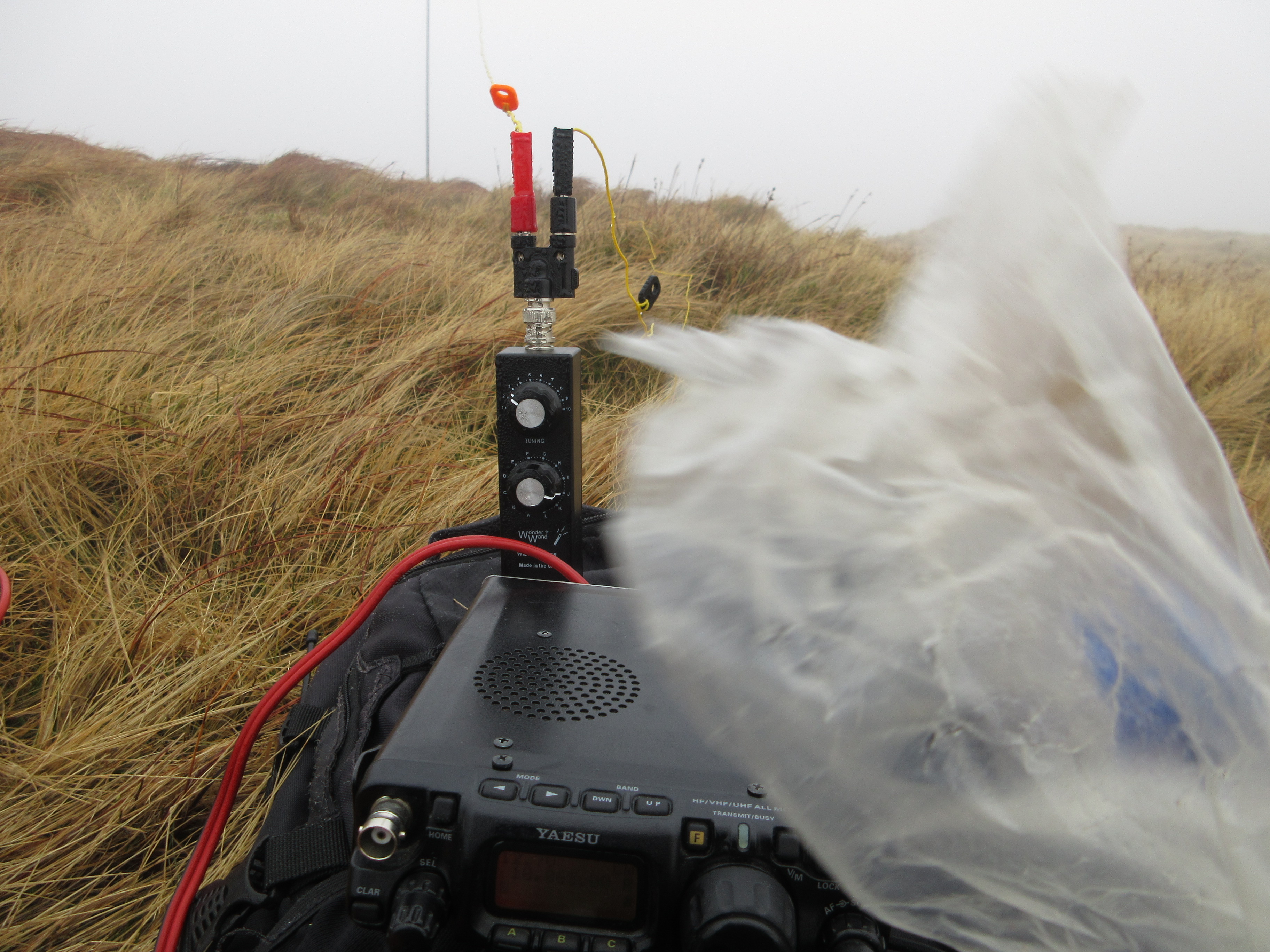

Apologies for the errant plastic bag in the shot above!
I bought the Wonderwand Widebander when I first started getting into amateur radio. At the time I had little clue about what was likely to be effective. I had made a few QSOs on it with the supplied whip, but had not found it to be terribly effective.
However, whilst rummaging through a box of bits and bobs recently, I found the WonderWand matching box and thought it would be fun to have a go at hooking it up to the Sotabeams Bandspringer antenna (about 11-12 m of wire from memory) on a couple of activations just to see what happened. On one activation I made 33 QSOs on 30m, and the other I made a couple of contacts to the states on 12m. All QSOs were cw.
So, whilst I wouldn’t necessarily be rushing out to buy one of these, it is worth considering using the matching unit in this way if you already own one. I will definitely be using this setup again!
