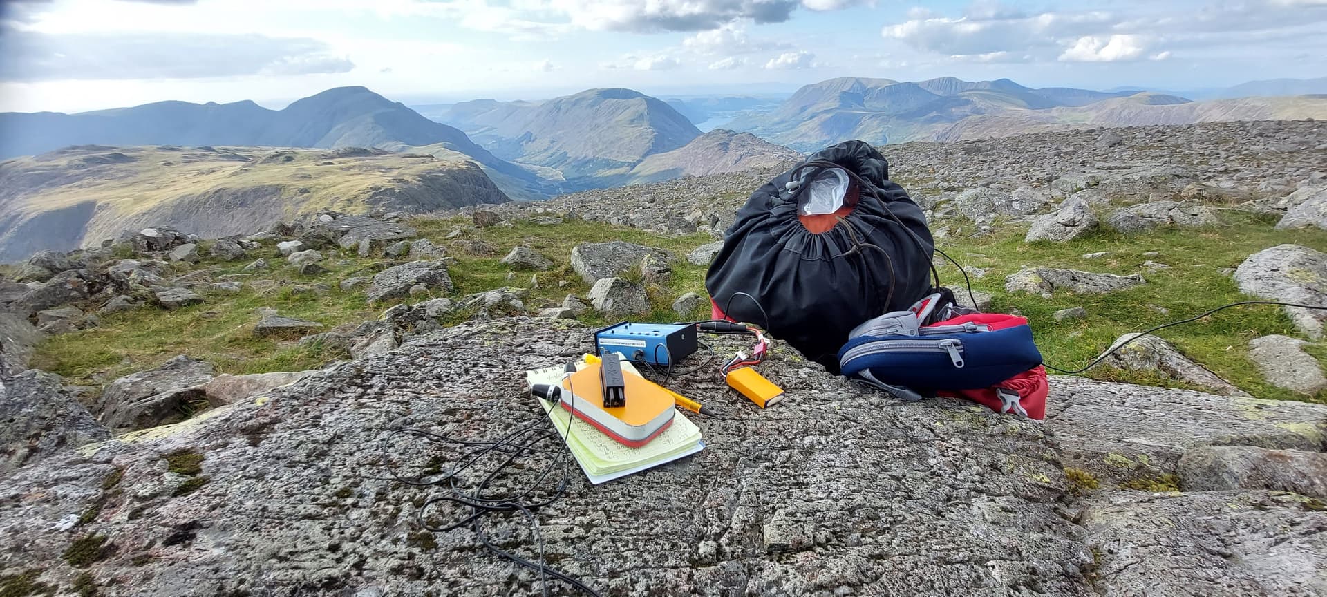

I activated Great Gable G/LD-005, Kirk Fell G/LD-014 and Pillar, G/LD-006 with my little MTR-2B over the two days.

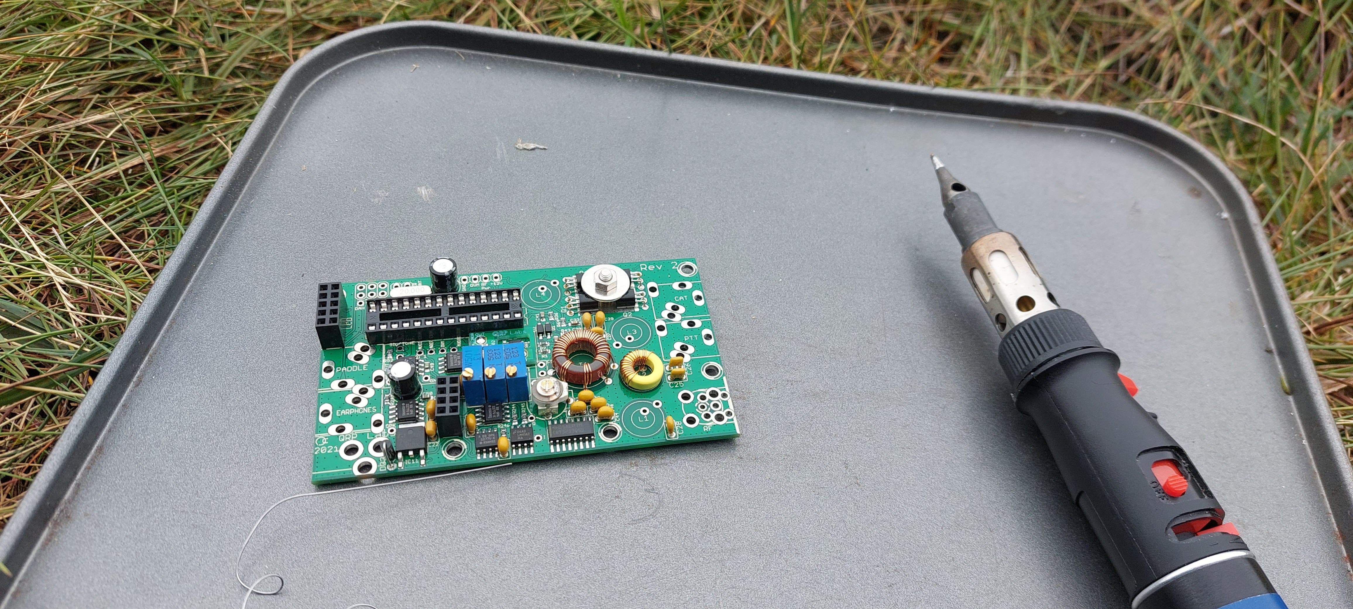

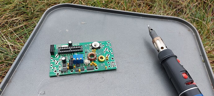

Another thing ticked off was the third and final episode of M1BUU’s Extreme Ironing. I’d built a RockMite 20 for the first in the series, followed by an SMT transmitter in the second episode. For the final episode of the trilogy, I built a QCX-mini 20 transceiver on the summit of Great Whernside. The build went well but it did take a bit longer than I thought it would. I’d built some QCX minis before, but I’d not built one for quite some time. The QRP Labs build instructions are a bit ‘wordy’, which is fine if you’re building in the shack, but when you’re on top of a hill you just want to get the job done. I ended up writing my own concise build instructions.
The summit QCX-Mini build was a sucess and I qualified for the activation points with the radio constructed at the summit.

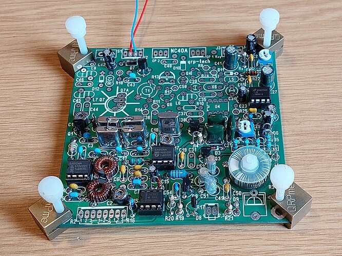

At the moment I’m building an N6KR NC40A. I was given the PCB, so I’ve been hunting for the parts for a while. I’m trying to use original components where possible. I do have quite a number of 1SV149 varicap diodes though, so the NC40A is sporting one of those in place of the MVAM108 originally specified.

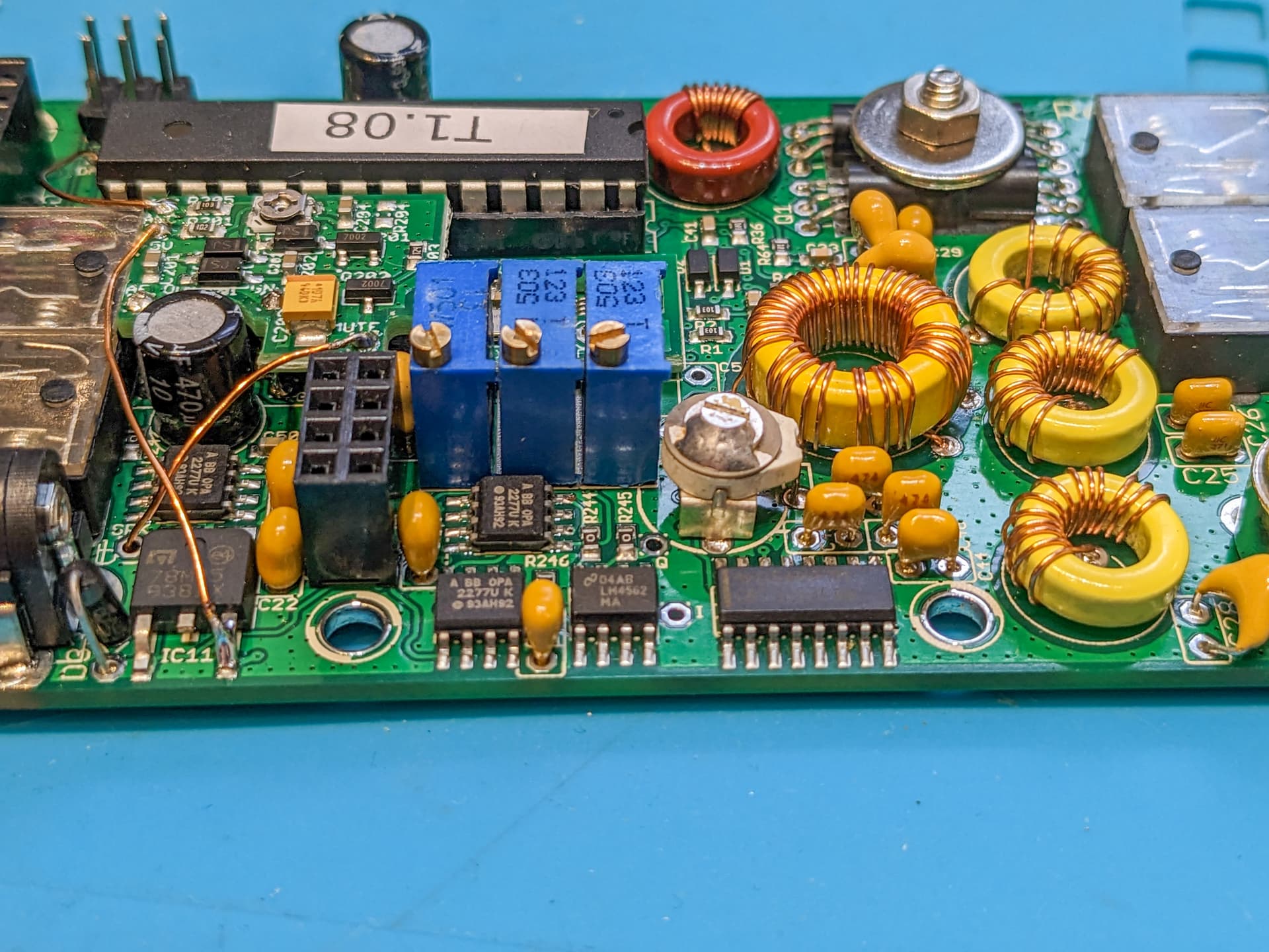

It has taken me a while to get around to doing this but today I modified my 17m QCX Mini following Collin’s @M1BUU design with a 50-6 mix yellow toroid with 24-5-5-5 turns. I also added the AGC module which was easier to do than I feared. The only issue was an existing capacitor stopped the board sitting as low as it should, causing it to foul the back of the LCD display. After a strong push with my thumb it now sits at an angle (not shown in the photo) and clears the LCD. The AGC module is the bit with copper wires running to it.
I haven’t tested it with an antenna yet but I’ve run through the alignment adjustments and measured the power output at about 5.5W from a 12v supply so everything seems good. No magic smoke spotted!
Weather permitting I will try it for real tomorrow.

Following on from the post above a quick test this morning and despite a low antenna in the garden and a K of 4 all seems to be working. There were only a few stations transmitting but they were readable and my transmission even manged to be heard in the US. This all suggests I have put it back together correctly and I will take it to Spain next week with the plan of trying it from a summit somewhere. :slight_smile:
