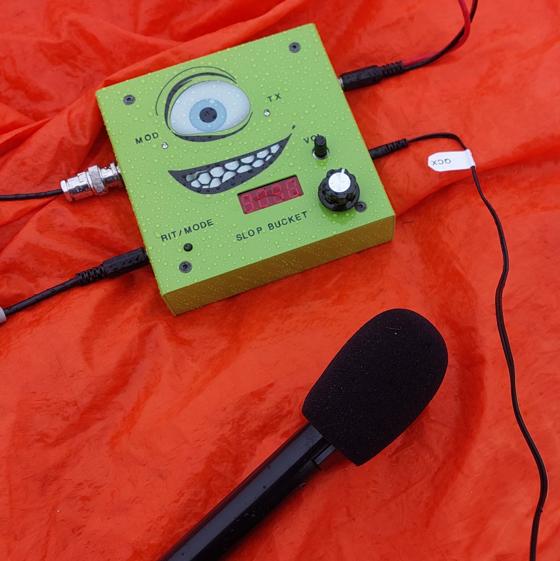

Finally, I fired up my Slop Bucket 20 for some SSB. Initially I used 14.323MHz but I suffered some dreadful QRM after a few minutes. I thought the QRM was local, but a chaser also mentioned the QRM, so I changed to 14.310MHz and worked a handful of callers. I’m not too confident with the rig yet, I’m still learning how to use it. Judging by the modulation LED, I think the modulation could benefit from turning up a bit. I’m running a home brew microphone with the rig, so again, that’s another unknown. During my time operating with the Slop Bucket the rain got heavier and the rig got a bit of a soaking!
