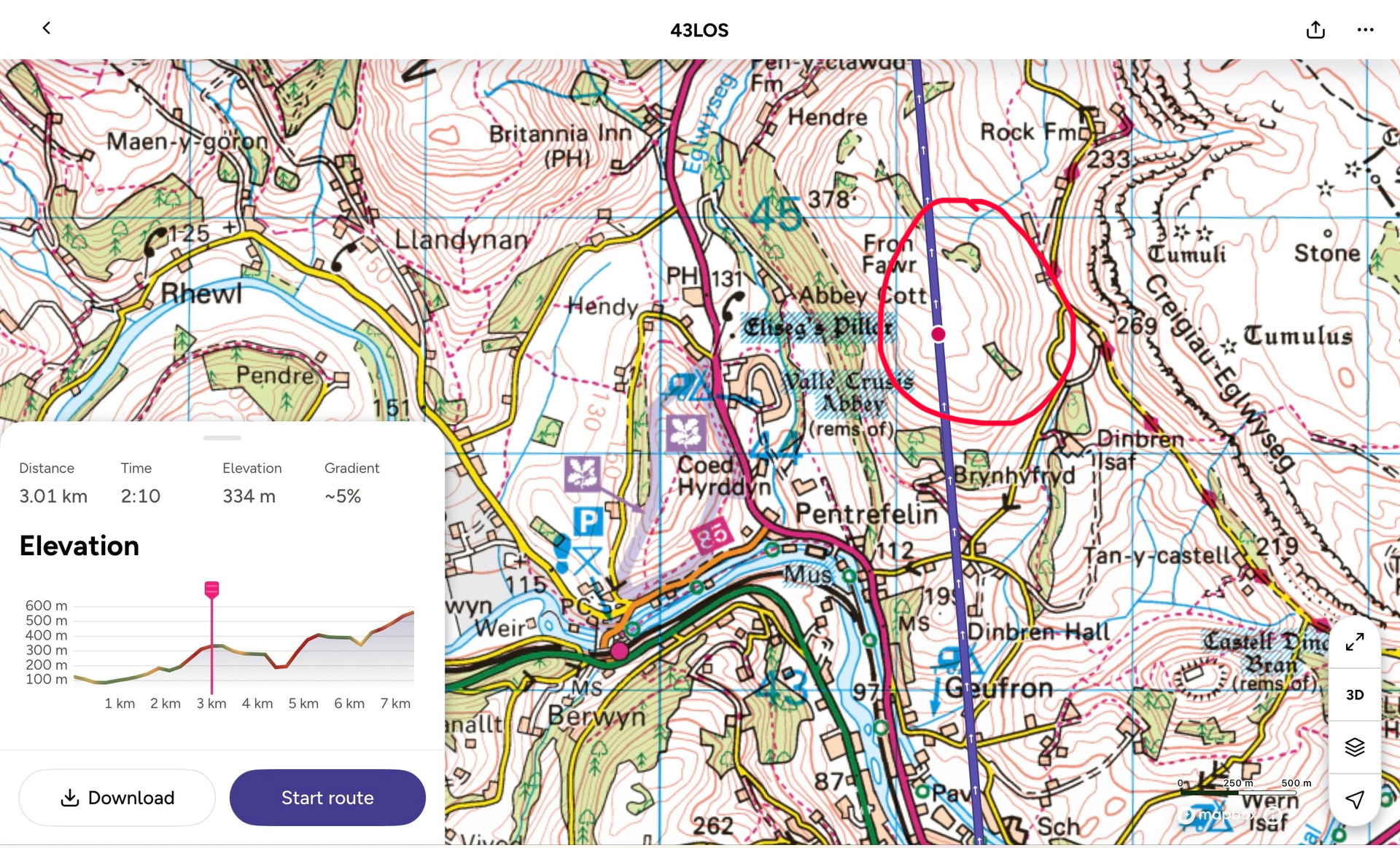

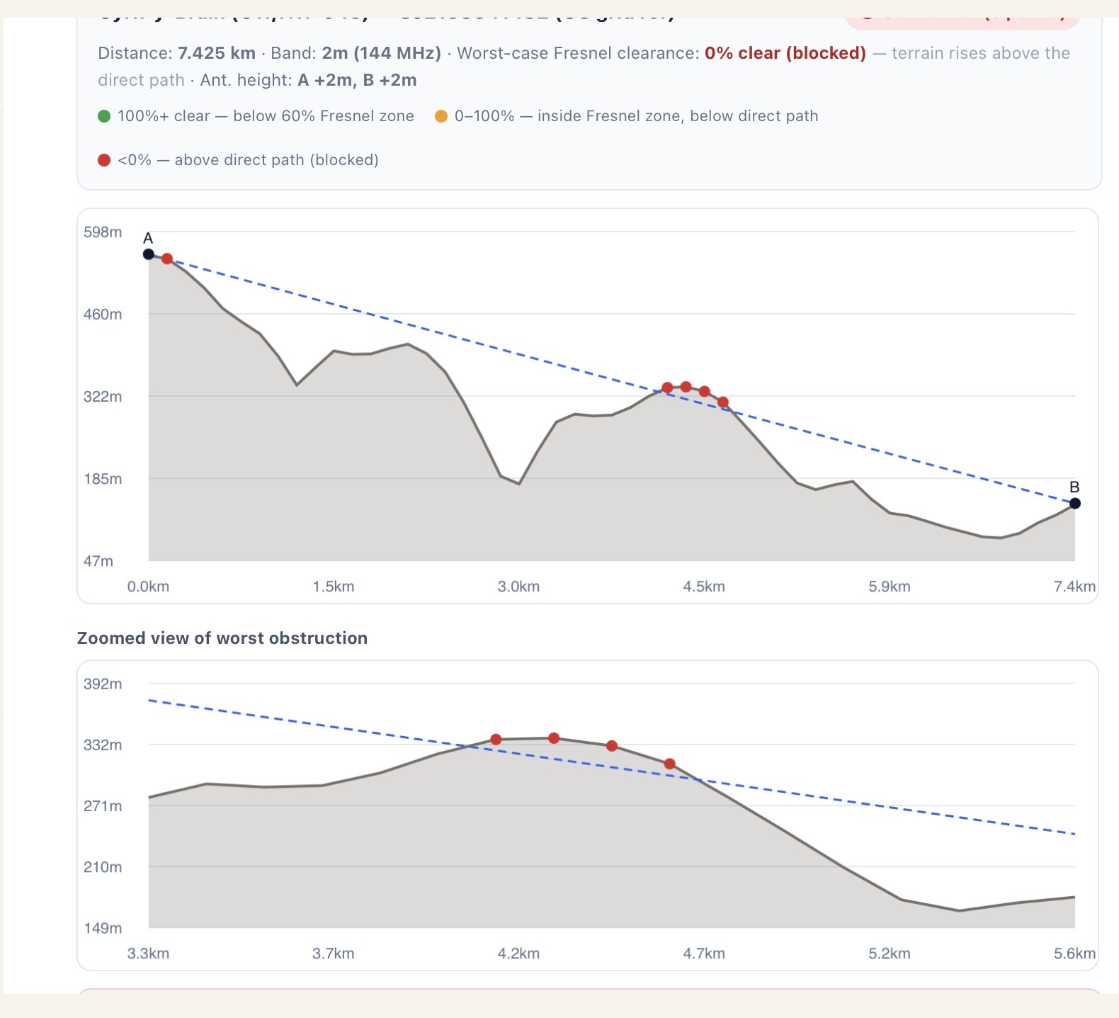

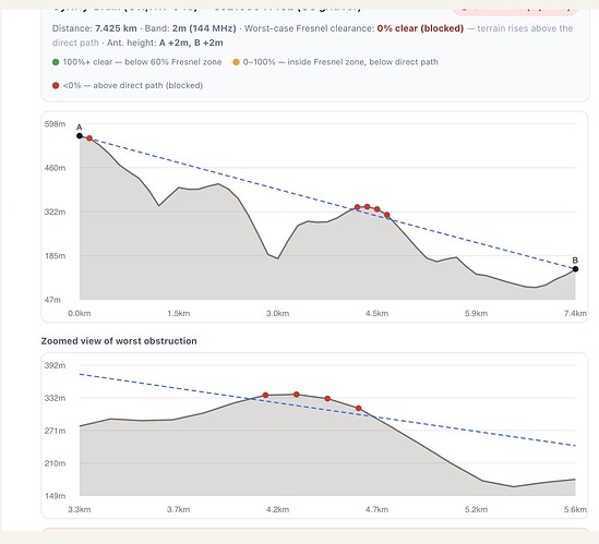

For some years, I thought could just squeeze my 2m wave along the side of a lump of rock that stands between my house and GW/NW-043. I have struggled with many a QSO on that summit, but always assumed it was all down to the transmitter station.
Well it turns out that I seem to bounce over the shoulder of that lump of rock. This probably accounts for some of the variability I get with QSO’s on Cairn y Brain. But this also shows that in marginal cases other factors come into play beyond the theory.

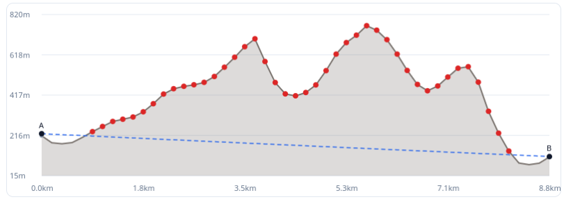

I live on the south side of the Dee Valley, across the other side of the valley is the large expanse of Trevor Rocks (behind Dinas Bran castle ruins) with almost vertical rocky sides. This rock mass acting as giant reflector is the only explanation, that I can think of, how my MW0PDV-14 igate, located at my friends, manages to ping my -12 igate at home. Especially when you look at the LOS plot below.

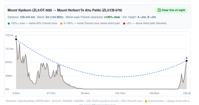

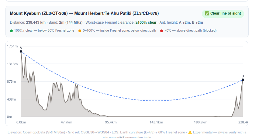

So there is line of sight from Oteake in Otago to the Banks Peninsula at Christchurch. I always wondered. Meaning 2m S2S from Central Otago into those popular Canterbury summits is possible after all! Not found anything further south or inland except the odd peek through the gaps to Mt Cargill in Dunedin. But a great tool to play and explore with.
Now, I just need my 2m SSB radio (FT818) back (and working), and I could play catch-up in the latest challenge.
Matt

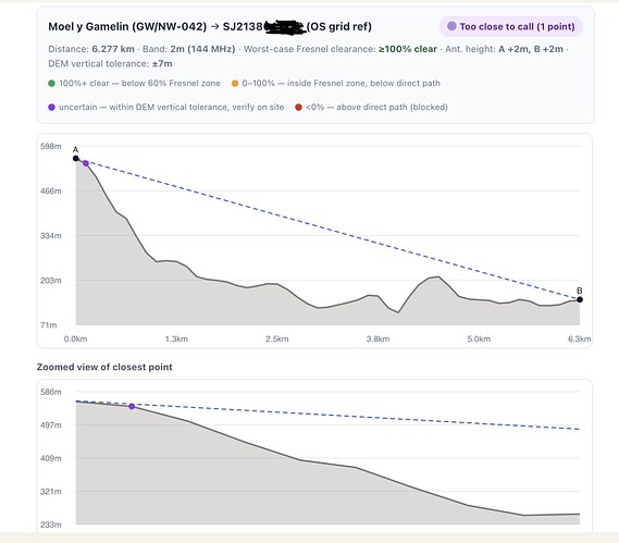

Due to the tolerances of the elevation models, I have now added a check for marginal cases. So if a path only clears an obstruction by a distance less than the models tolerance, it warns you as in the screenshot below. For Europe the vertical tolerance is ± 7m, but the note wil tell you the tolerance for the dataset in use.
Also the documentation has been updated to reflect the added data sets and the tolerance check.

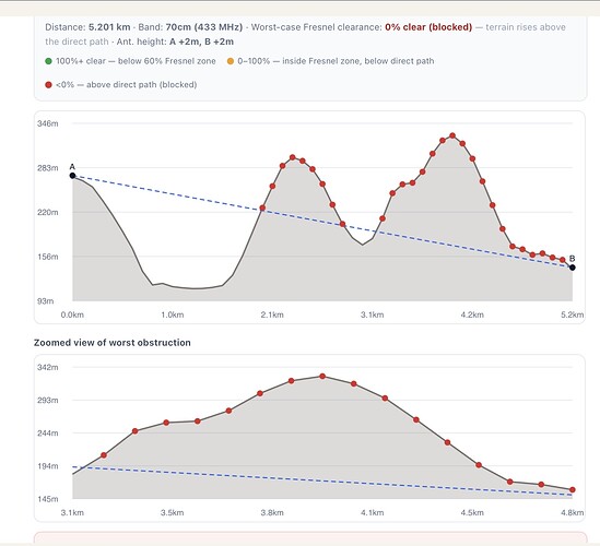

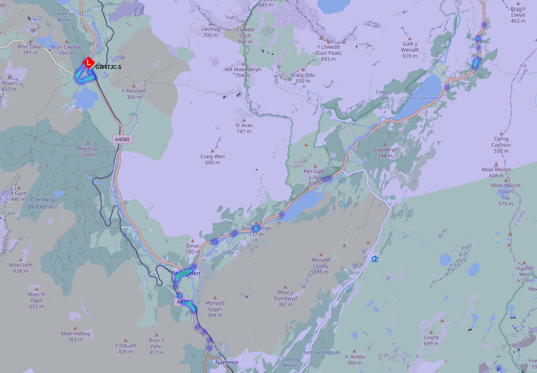

That’s pretty cool. Similarly there are some pretty wonderful packet paths being picked up by Simon @G4TJC ‘s Lora igate in Rhyd Ddu (GW4TJC-5) - look at the packets picked up due east especially:
Using your calculator:
That whole area has a limestone bedrock which is relatively transparent to radio waves and does not reflect well. Nor does it attenuate as much as others. It might be more like a building or a group of buildings doing the reflecting especially if they are those prefab metal light industrial units.
Getting some avid microwave users on the case could help pin point the path.

I do have to say it’s unreliable path, that seems to work in certain conditions. It will sometimes ping my home igate every hour, and then sometimes nothing for days. It’s not a problem as both have their own internet connection. But it is curious how it manages to ping at all.
