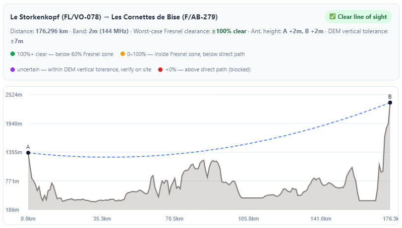

Just a silly idea: if someone enters only a 6-character Maidenhead locator, could you automatically center it within the corresponding 8-character locator? For example, from JN37tl to JN37tl55. I know it’s quite coarse, but sometimes it’s good enough.
BTW: Yesterday, I had a 2 m FM S2S with @HB9NBG/2 and @HB9FZC/P. Good signal reports and both were using only handheld antennas. The signal traveled from the Vosges, across the Jura, to the French Alps:
