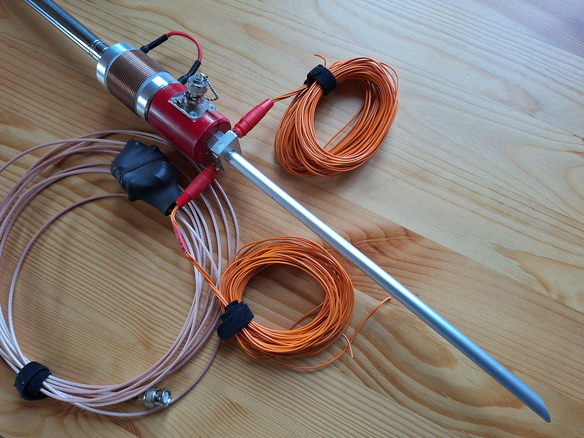

A while back I caved and got one of the Ali Express ‘red slug’ antennas that folks were using out portable.
It sat unused for ages as the one time I did take it out I had some serious QRM and had an awful experience with the radials.
Since then I bought one of those little ground plate discs and the 40m coil to try and see would it make an improvement. I also added an LDG choke I had in a box of parts and made up my own radials following some tips @MM0EFI discussed on a YouTube video.
That video was super helpful, I took a photo of the chart posted for different band settings for use in the field. Thanks Fraser. :+1:

I love this antenna:
  • easy to transport
  • lightweight
  • quick to set up
  • doesn’t take up much space when you’re on a summit
I use it with a 40m coil, a ground spike or a small tripod
73 Manfred DB3KE
I like your little tripod thingy there. Thats cool!

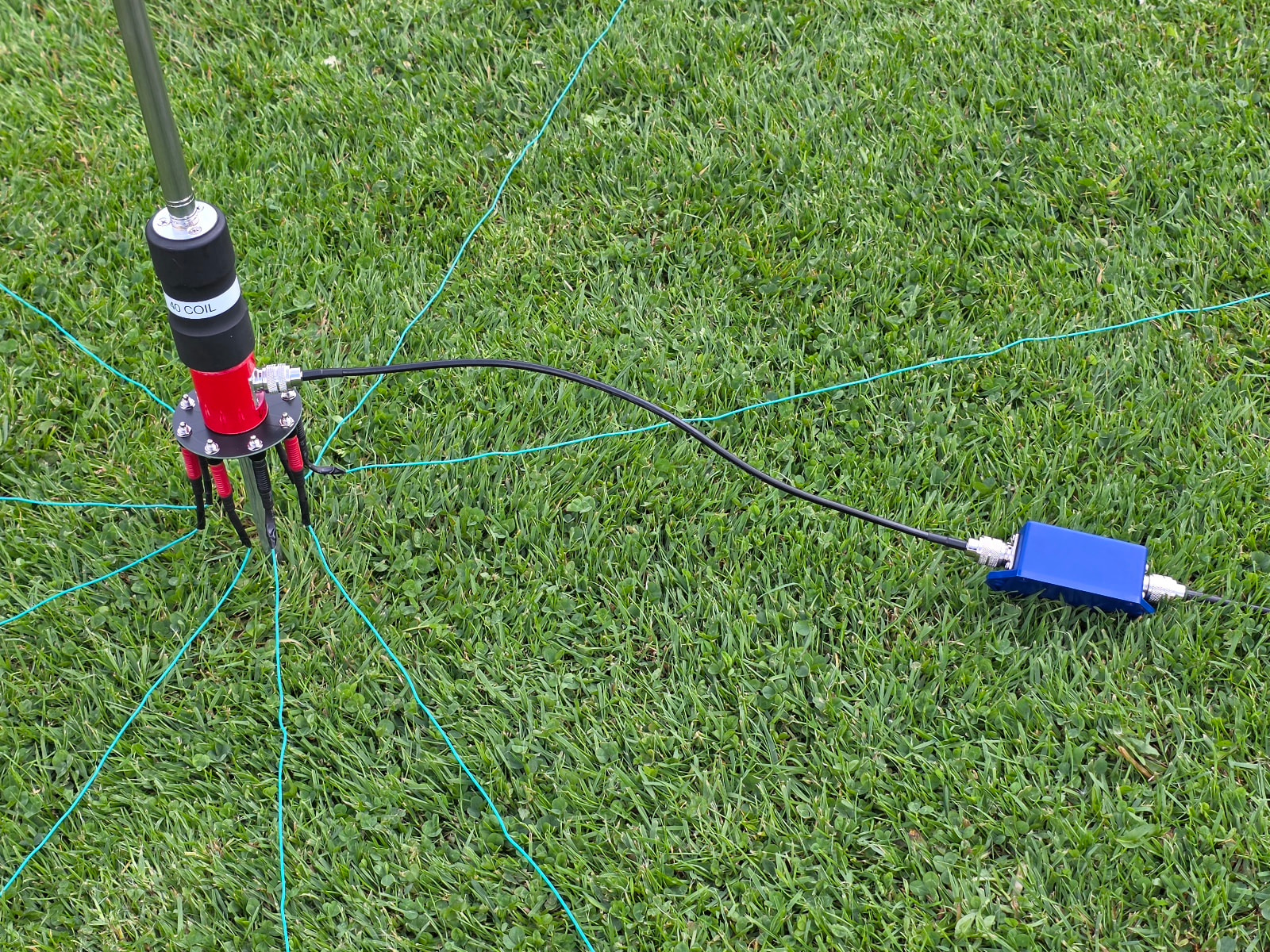

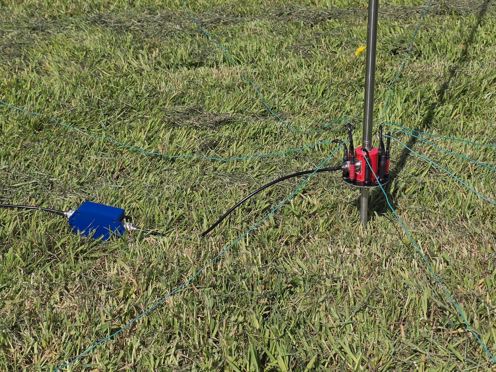

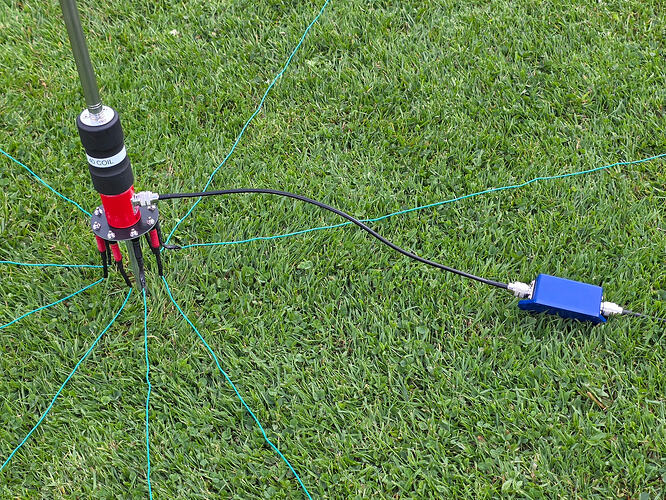

I went out this morning to earn my IE-0136 Repeat Offender award and deliberately set up the 40m Coil to test it out.
Does it work?
8d6eb1d5-b339-42f7-9da6-1138c3a400a0_text
My set up:
40m was hoppin’ this morning. 10 QSO’s in under 12 minutes, all on 40m, all CW. All QRP.

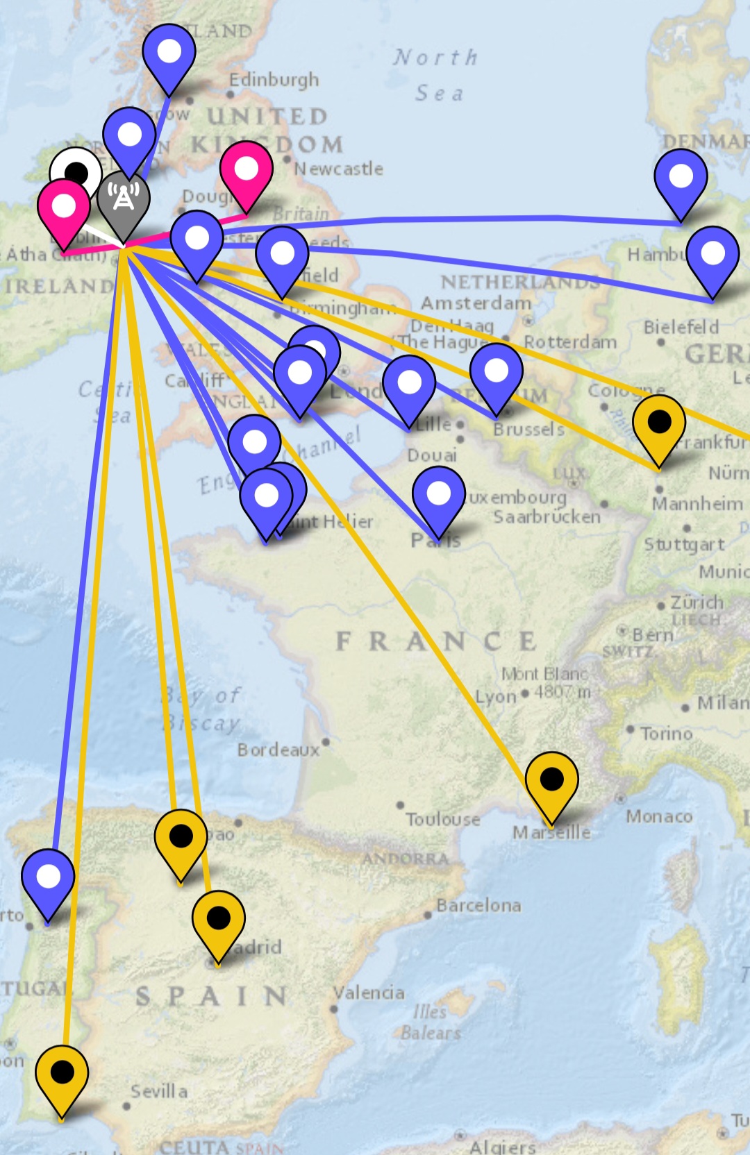

QSO’s below. All with Le Slug Rouge. 40m in Blue, 20m in Yellow, 2m in Pink, 70cm in White.
I think I am very happy with Le Slug Rouge and will definitely use it again. Maybe later today and also a SOTA at the weekend possibly.

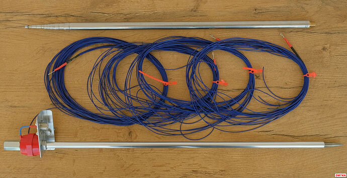

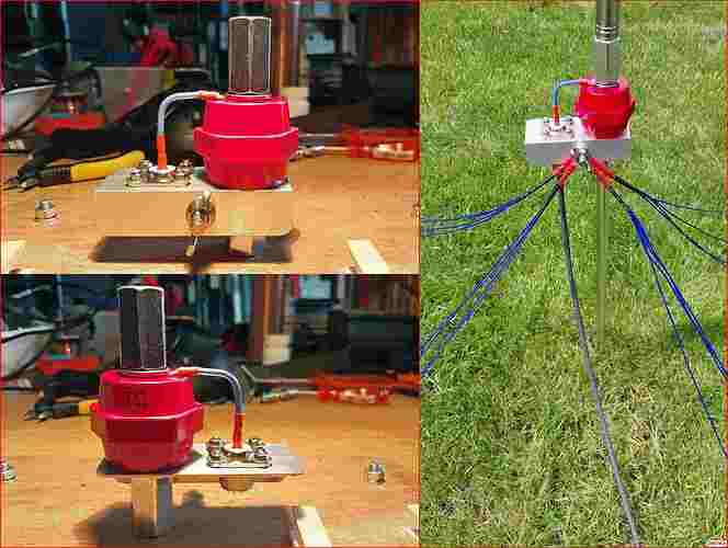

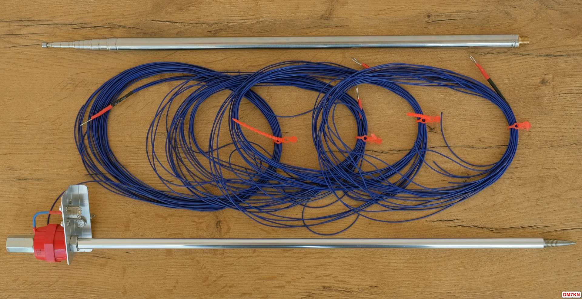

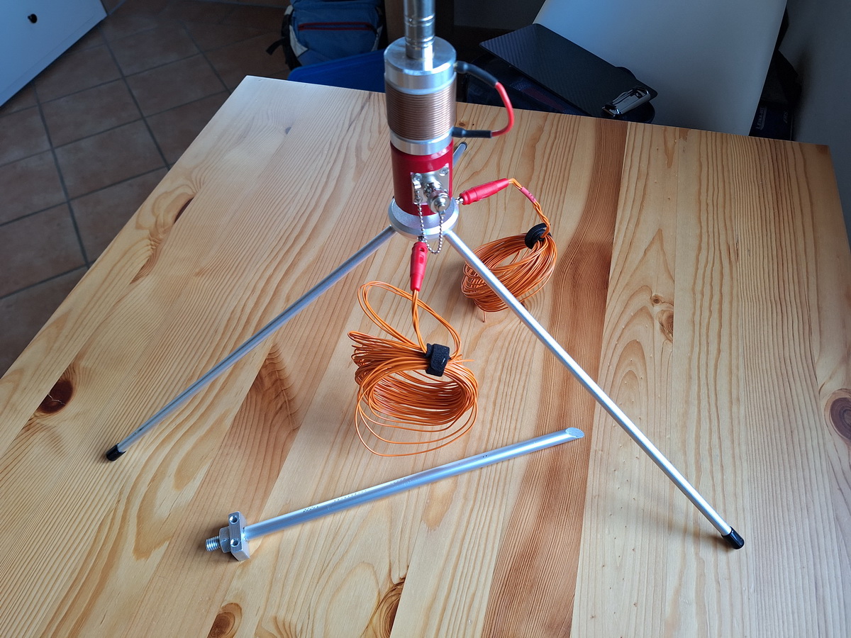

Here in Germany, we have a very active group of outdoor enthusiasts who activate predominantly POTA. On their website you will find a very detailed description on how to build such an antenna with readily available components. Unfortunately, it seems to be in German only, but loads of pictures speak for themselves.
My version was built according to their plans and looks like this:
This is my solution for summits with very limited space. Whenever possible I prefer to place my radiating antenna components further away from the ground, e. g. on a GFRP-pole or with a string to a tree. My first choice is still my 20 m long EFHW.

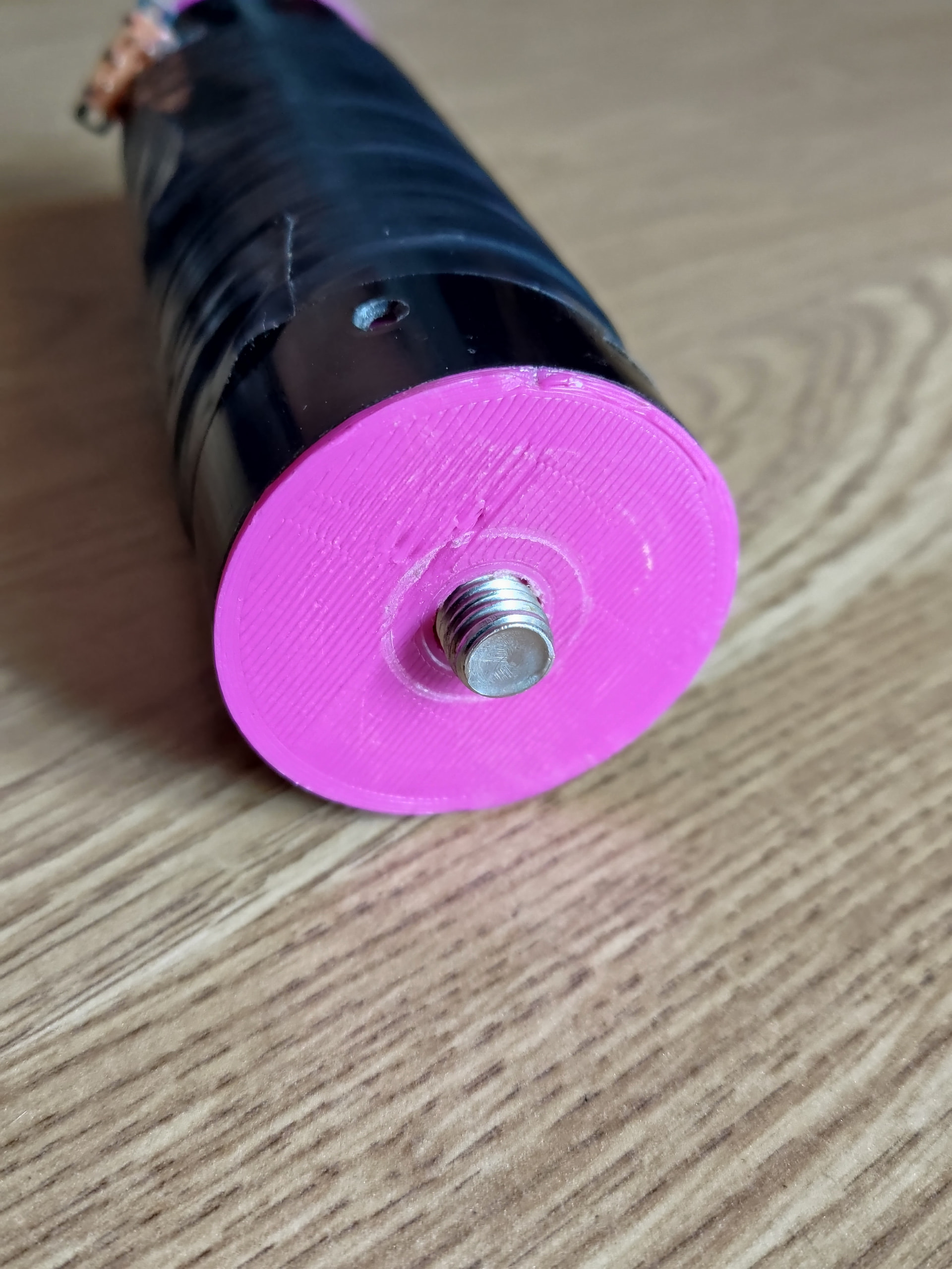

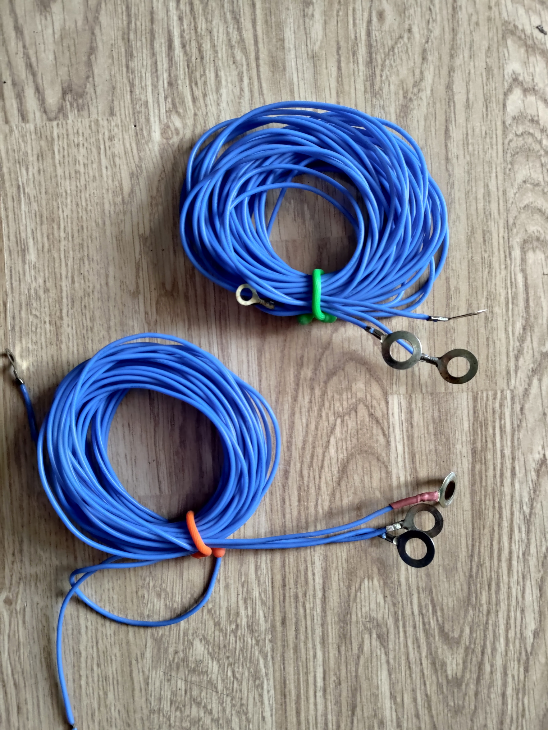

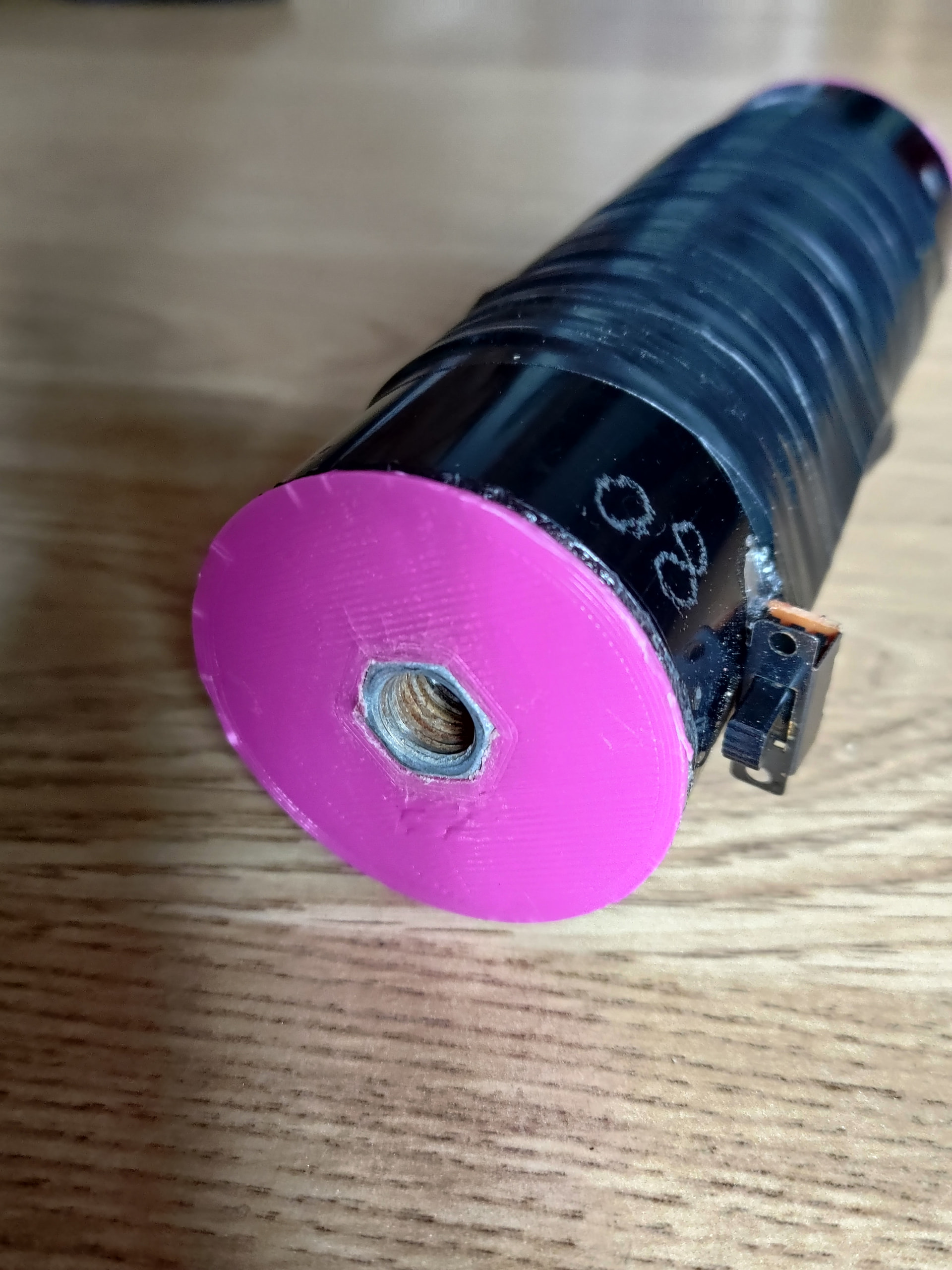

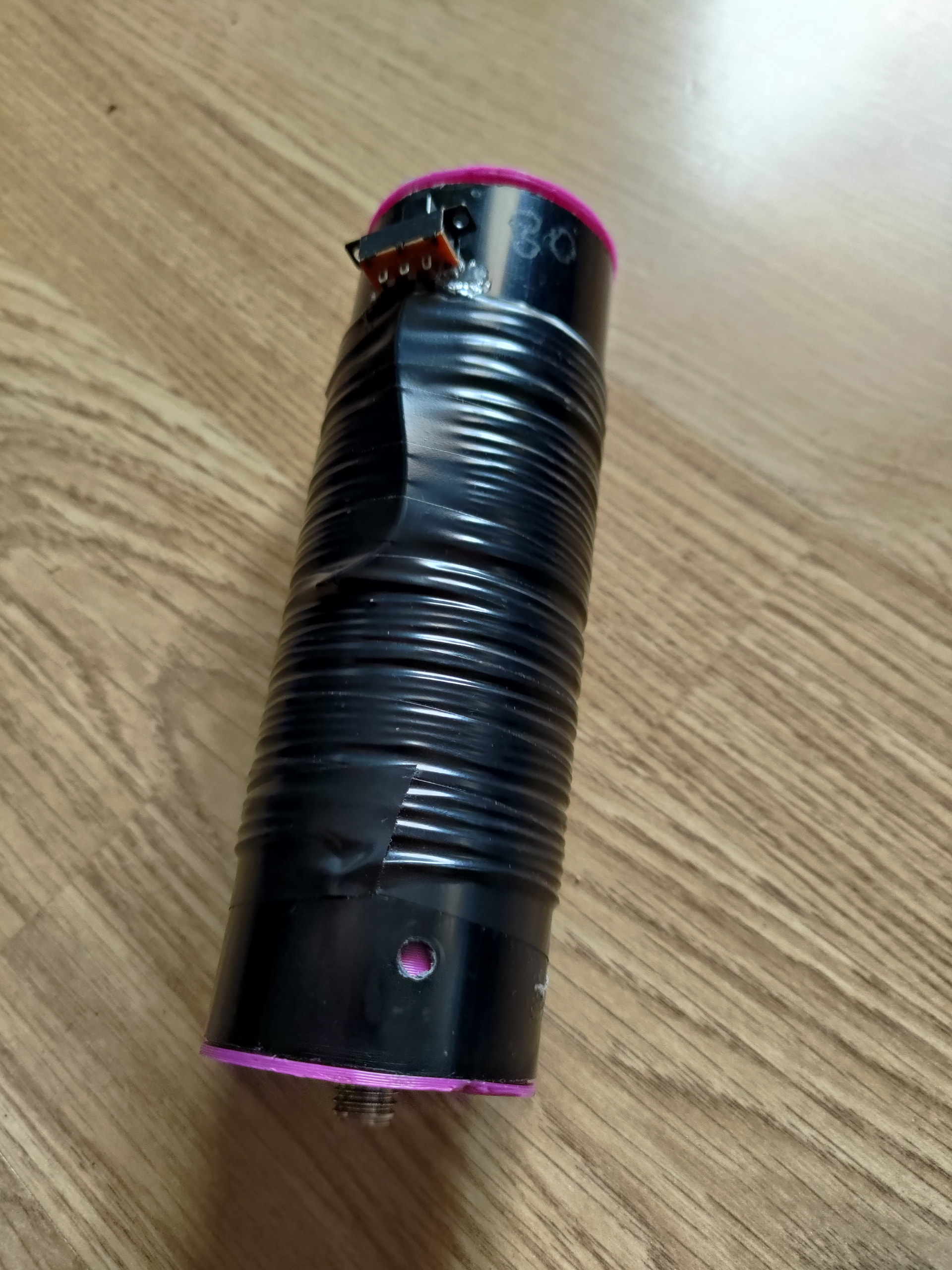

I ditched the terrible flat cable radials and made my own from some silicone wire. Not much science in the length: I bought 25m and cut into 6 roughly equal lengths and put a ring connector on each to fit over the ground spike. The silicone wire untangles easily.
I bought a 40m loading coil which works fine but as the man with the swiss accent says: we want more.

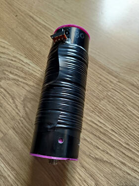

I made another coil by winding some enamelled copper wire onto a piece of 50mm PVC pipe connected to an M10 bolt inside the pipe (one of the bolts is screwed into an M10 coupler) then pressed into some 3D printed stop ends glued into the pipe.
Part way along the coil I soldered a tap which runs to the switch to choose between 60m or 80m.
It works great but the tuning is very sharp on 80m as expected for such a big coil.

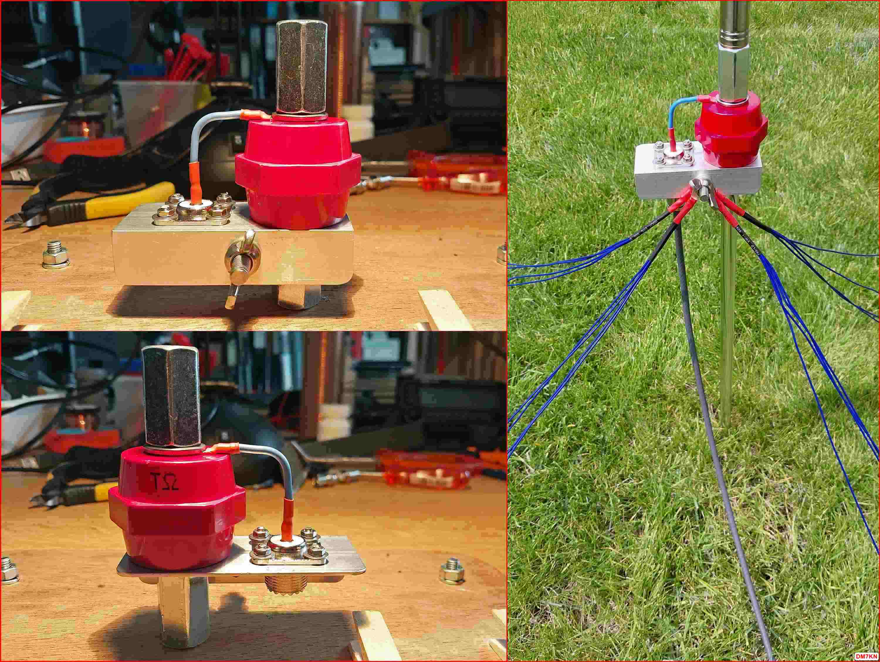

Hi Ian,
By zooming in on your picture, I see you have the red slug marked to show which side the whip goes and which side the radials.
I took my “Red Slug” antenna out to test it today (I originally bought two of the whips as they were dirt cheap and later bought the “slug” and the spike - both discounted from what they are in the complete kit) - having checked the antenna at home on the analyser and noting how many section need to be out for each of the bands between 20 & 6m, I was confident that it would work, first go.
At the same time I took my Diamond RHB-8B on a super small and low tripod, to test that as well. Blow me down the RHM-8B with it’s slider loading coil and 1.5m telescopic whip, far out performed the 5.3m quarter wave/Red Slug antenna! the Diamond has 6 lightweight radials, the Red-Slug 8 tried and tested 3m radial wires.
On taking everything apart to head home, it struck me that it is totally possible to put the red slug in either way around and its possible that I had it the wrong way around - as, as far as I can see, there are no markings on the slug, which I guess may be why you marked yours.
I’m about to head out into the back garden, to see if this was the problem and I’m taking a marker pen with me in case that was the problem and I will mark it up, so that next time I’m out, I get it right!
as regards modifications, I have made a plastic guy ring to sit towards the top of the whip, so that I can guy it if windy.
73 Ed DD5LP.

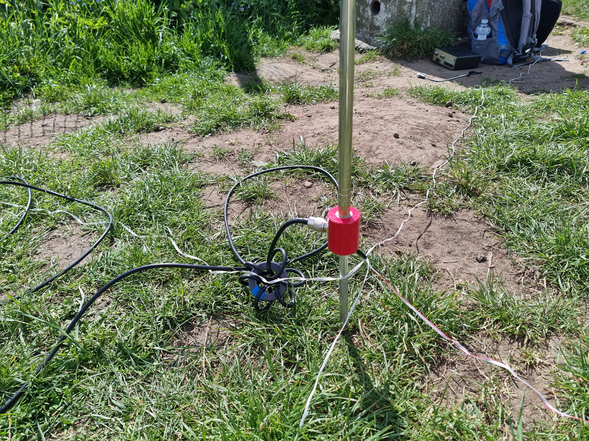

Update - that was my problem:
Slug wring way around:
Slug correct way around:
So, my NUMBER ONE modification is to mark the top and bottom of the slug!
Yep it is a pain with Le Slug Rouge that it has no markings to identify the correct ends. Glad you got it sorted! :star_struck:

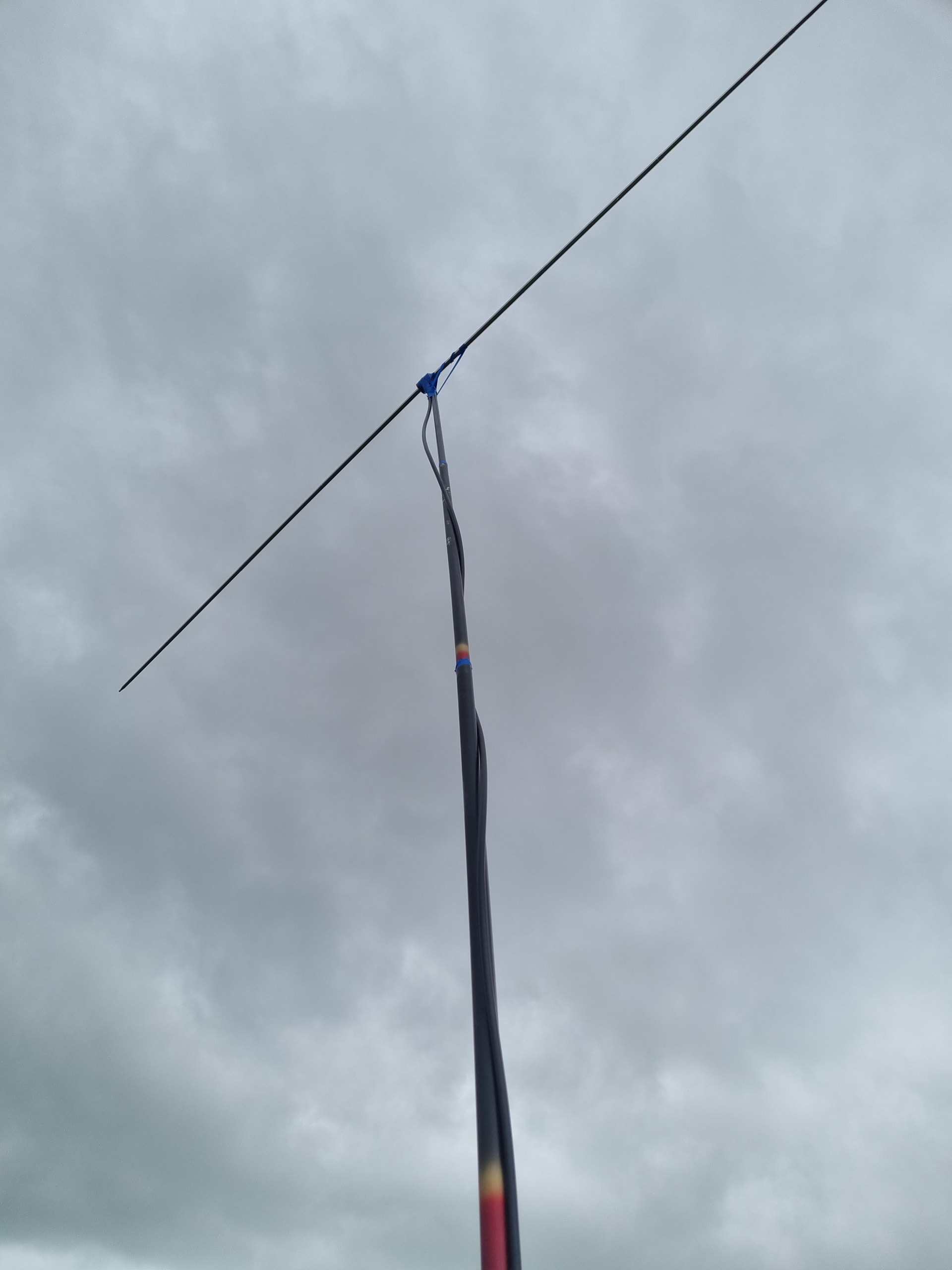

I found some pictures of mine
  1. Normal Configuration on G/SP-012
And with 2 whips as a 6m dipole on G/WB-005 on a hog roast weekend. Literally using tape to attach to the fishing pole.
Managed to work an Italian on 6m with it, so not totally hopeless.
