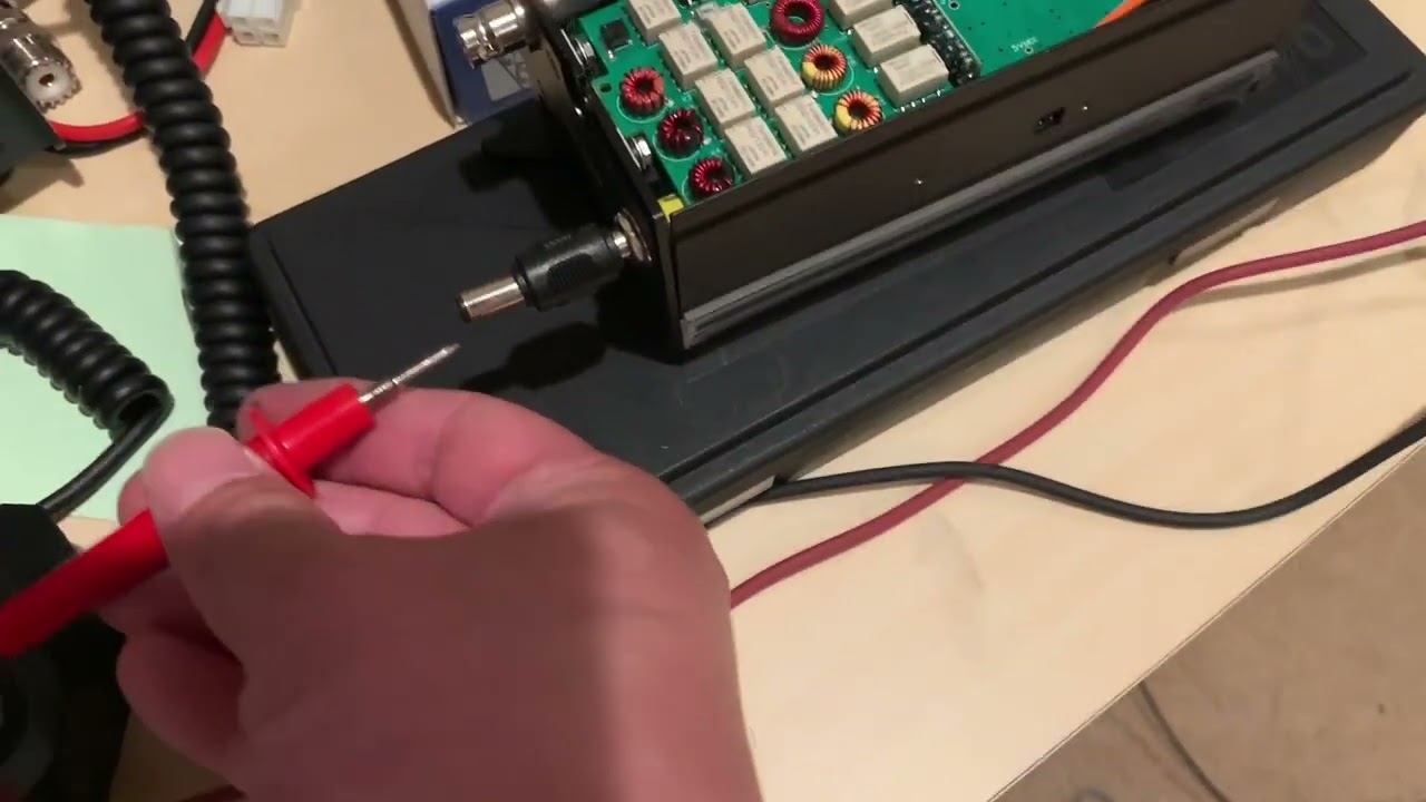

Maybe I’m installing my own external charger at the LED hole or like he modified his radio.
