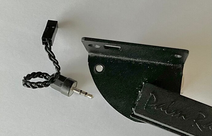

Stumbled upon a nice looking KXX* CW key port adapter. Does anyone know if you can get these in Europe, or anything similar? Even a 3D print version perhaps?

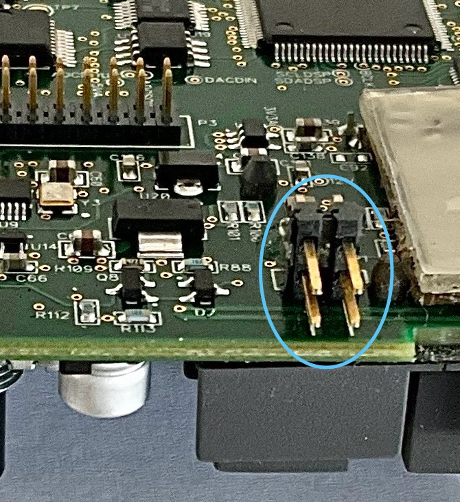

Good idea! What is the little connector the KX2 uses?
EDIT: Never mind. Looks like this?
https://www.aliexpress.com/item/1005004715339607.html
Need to check the pin wiring and then get a barrel pigtail and that should be that.

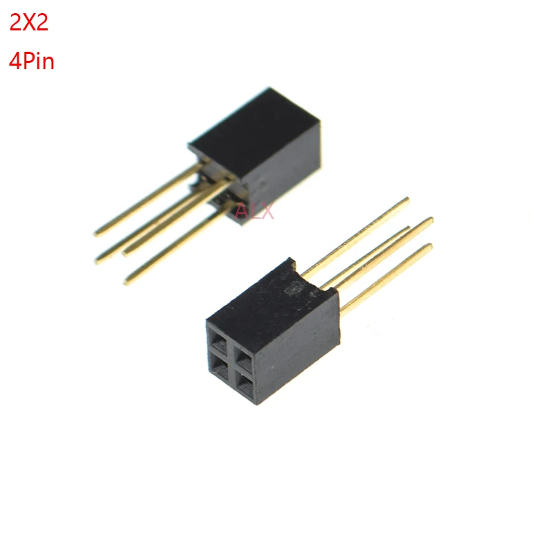

If you must use the difficult to use connector this is what you need, plus some veroboard and more wire.
https://de.farnell.com/en-DE/samtec/ssw-102-01-g-d/receptacle-2-54mm-dual-4way/dp/1668329

Hi,
I made it myself from an old motherboard audio connector
73 de José
I would put it this way, Andy: You can’t blame people if they don’t (yet) fully understand what they’re holding in their hands.
This small male onboard connector was chosen by the designer for the connection with their attachable KXPD2/3 paddles. It is therefore a plug connection within the system and is thus not subject to any mechanical stress.
The solution later offered by Palm Radio for using their Pico Paddles directly attached to the radio takes this into account with a very short, highly flexible adapter cable that doesn’t stress the onboard connector.

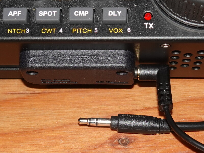

From this perspective, the 3.5 mm jack plug adapter offered by Pro Audio Engineering, which is permanently attached to the KX2/3, is an absolutely professional solution.

The Pro-Audio Engineering adapter is very thin. The thickest stereo plug that will fit is about 7.7mm diameter for the plastic. Most of my keys won’t plug into the Pro Audio Engineering adapter. The angle plug in the pic fits. The straight plug is about 8.2mm diameter across the plastic which is pretty thin but it binds before plugging in all the way.
The adapter and Elecraft menus let me configure the side jack as a paddle and the front jack as a straight key. It keeps dirt and grit out of the opening. To me it is useful and I’m glad I have the adapter. YMMV.

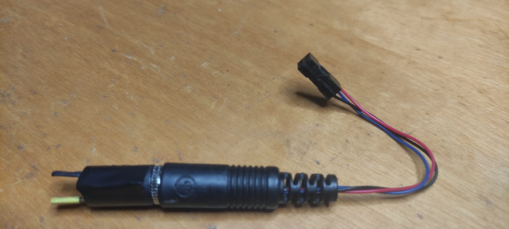

Also big fan of homebrew here
 this was my solution
I also used some PC motherboard connector like Jose, @EA7GV
