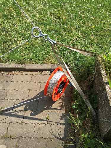

for my experiments with kite antennas I used my power sled with 6 sqm surface. This is for SOTA operations simply overdone but I had the kite at hand and so I gave it a try close to where I live.
The anchor I used and the line gave me sufficient confidence that both would hold the kite reliably:
Anchor
Line Data
Kite Line - lighter for size comparison
However, and to have the belt to the braces, I decided to follow the advice of DD7LP and kept the antenna separate from the kite line. The comprehensive description is - unfortunately - only in German but there are some pictures in it which speak for themselves. He employs a rubber cord between the kite and the antenna (" 1 m Gummiseil") for shock absorption. I think the bleeder box DD7LP shows in another picture on that page is also a good recommendation.
As a fly fisherman, I am used to slippery plastic lines and tried differend knots. With the kite line, although also plastic, a simple bowline hitch has proven to be reliable. This may be related to the “excessive” diameter of my specific line and not hold true for smaller diameters. At the end, this remains a trial and error game. :wink:
