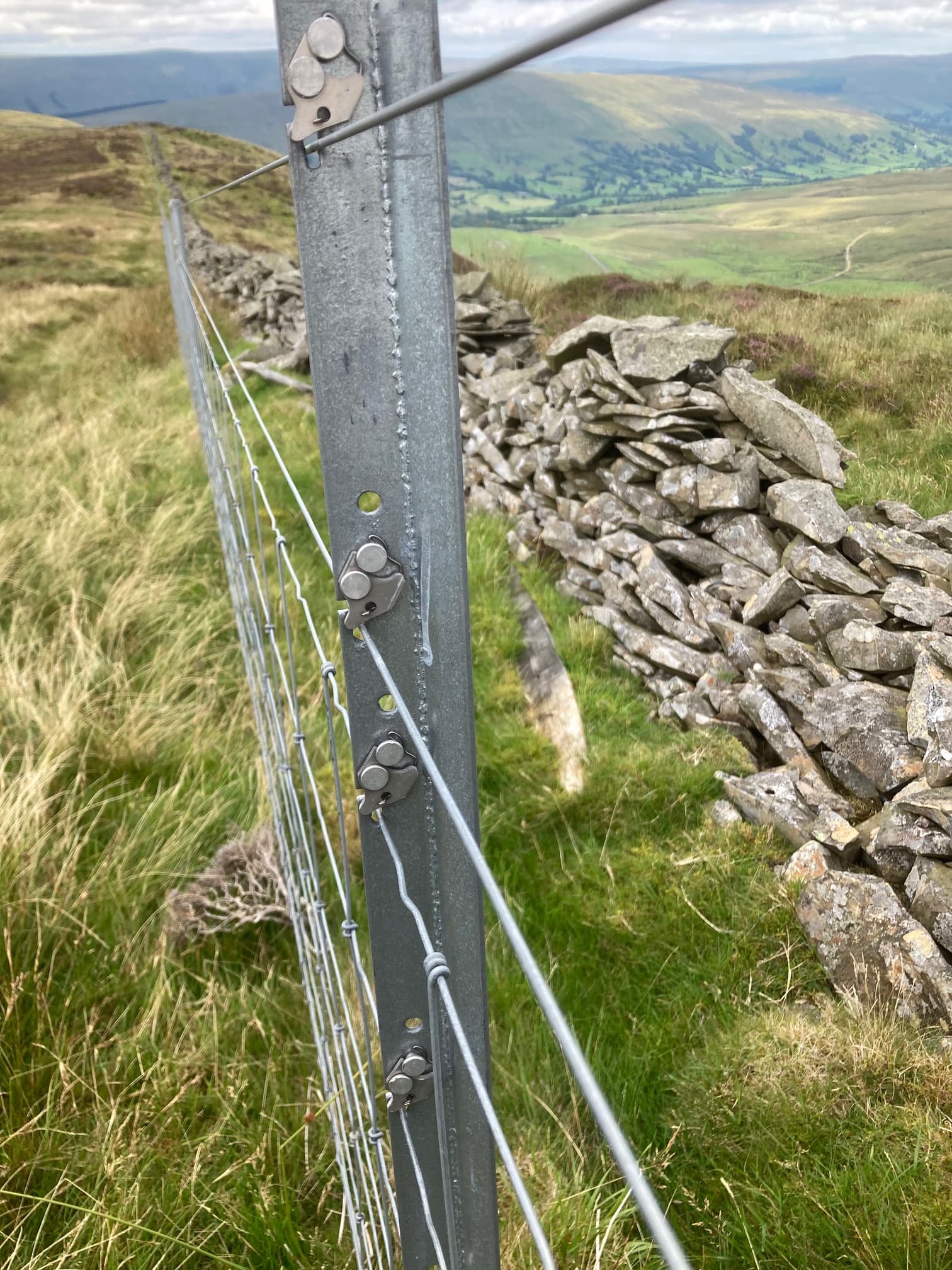

In the meantime, I looked for the device. Nothing in the fallen wall. Nothing near the wall and no sign of any ground disturbance either. ??? :thinking: Listening closer, the sound was not coming from within the rocks. I could hear it resonating/humming through a timber support wedged against the new wire fence, Ahh! getting closer! :thinking: It wasn’t coming from the concrete trig point either. Then as I pressed my ear against the new fence… Eureka :hushed: :upside_down_face: the low humming was coming from the fence. Not all of the length of fence but just around the summit area and several yards along the fence both ways. The noise didn’t quite disappear when I tried to press or alter the fence either. :thinking:

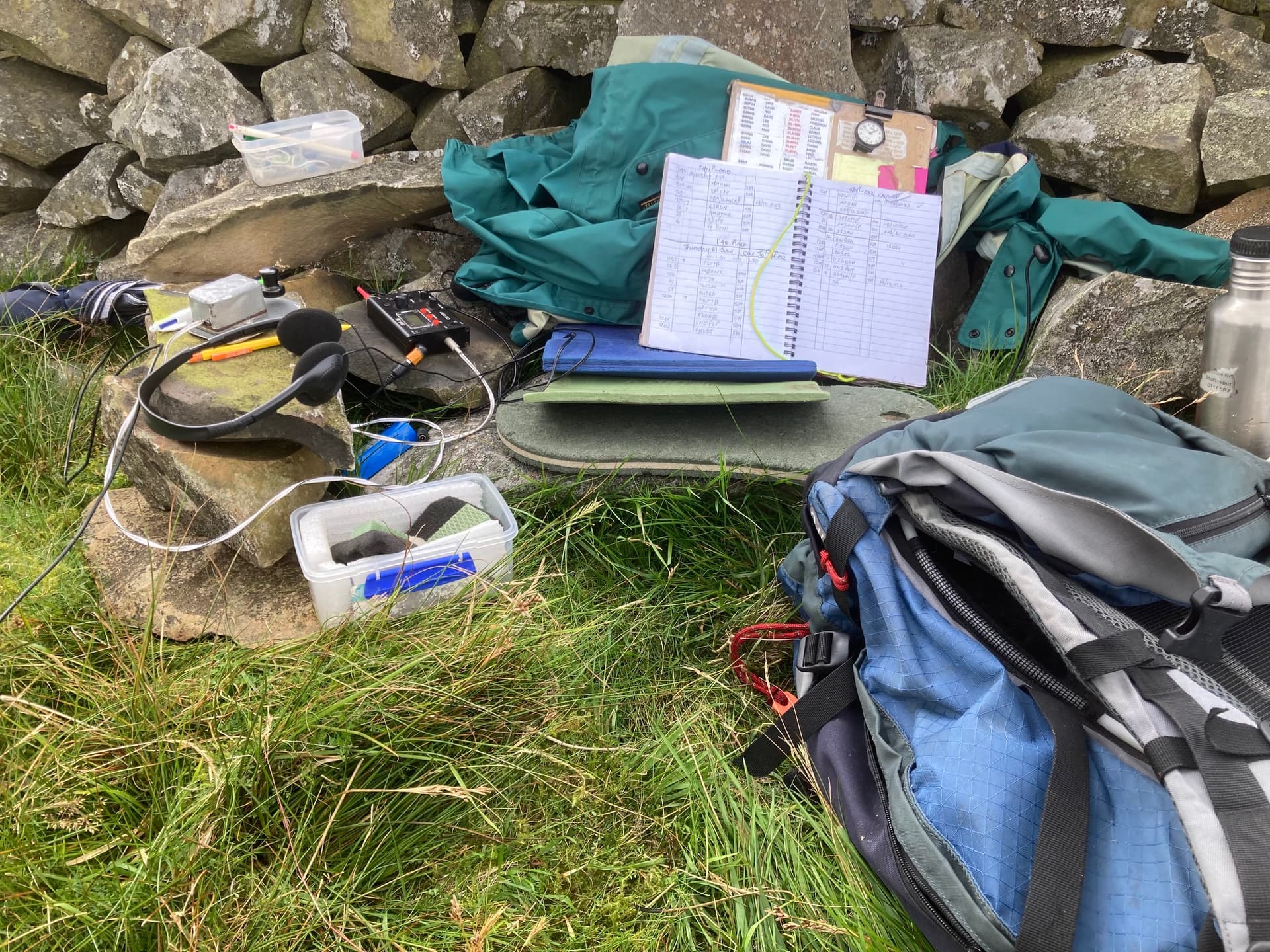

Here’s my office, and here’s the fence. Brand new, and very shiny, and the wire is held on by a type of clip I’ve never seen before which allows the wire to move freely along the whole of the fence length which must have been hundreds of metres or yards long and under very high tension.

So. Wind noise or static ?
I’ve heard that in the past on Tinto Hill GM/SS-064. It was near the bottom where there was long runs of fence wire no longer clipped to the fence posts that was vibrating in the wind.

Certainly heard that from wind on fencelines many times.

I suspect that this was Karman Vortex Shedding. I have been fascinated by this since first learning about it at University. Sometimes you see spiral projections from the top of circular towers to prevent this phenomena.
