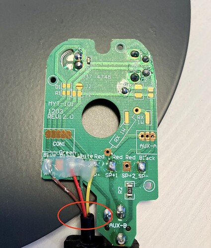

I did have issues with my audio/modulation. Despite that, I managed a reasonable number of QSOs on different bands. The G106 isn’t that bad - it works… but I really want to figure out the modulation/audio issue on 20m and 10m. Fingers crossed.

It’s most likely going to be RF feedback. So… you need another HF rig to do the tests.
Connect a dummy load to your rig and then listen to your transmissions on the other rig possibly using headphones. There’ll be enough RF escaping from the dummy load to give a nice signal for the other rig to use. If everything is nice and clean then it’s RF feedback on those bands.
If you don’t have another rig then arrange to do the tests with someone from your local club.

The Xeigu are notorious for RF feedback into the mic. I choke every antenna I use with the Xeigu x6100. There is a thread on the reflector with me moaning about this and trying to fix it on the x6100.

I’d try the coax choke like Tim suggested. With RG58, you’ll need a big torroid to fit the cable (like this one), and of course it’ll end up being shorter - just have to move closer to it! Or get another piece of coax.
I’ll put my “I used to do EMC compliance and approvals” hat on and state:
The issue is most likely going to be RF pickup on the microphone cable. So you need to stop that happening either by decoupling the assorted inputs in the cable, properly screening the cable, choking the cable.
Reducing common mode currents on the antenna feeder is probably a good thing but not necessarily the be-all and end-all of fixes.
I did wonder about that too - the included mic is a £1 jobby.
I don’t think it’s shielded at all - here’s a pic.

Well my first task would be to replace that cable with a screened one.
Having been around the block with these Xiegus… I am pretty sure its…
  1. Reflected RF down the ground of the antenna. Usually non-resonant antennas.
  2. RF Conducted onto the metal casing of the radio from RF ground.
  3. Metal casing of the radio is also the ground for the mic.
  4. RF from ground feed directly into the mic…
and Result: a rendition of Kraftwerk’s Autobahn straight from the 1980s…
This is conducted, not radiated interference…
Choke your antenna, using a torrid right at the feed of the radio (see pic below). For RG58 you need the Torrid @GM5ALX suggests. That will solve it.
Other solutions that I tried and that worked:
Choking the whole mic:
Choking just the ground of the mic:
Adding an 100uH inductor to the ground of the mic:
I wanted to try a cap to ground on the mic, but i found a final solution…
Final solution: Just went and bought a KX2… problem permanently solved
This is how i operated before the KX2…

Yes, but none of the system is actually truly grounded and all i’ve done is isolate the mic from unwanted conducted emissions due to the poor design.
