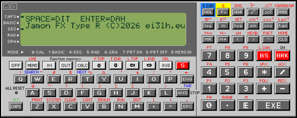

It is very much in the alpha stages (and will be for a while as Mark @M5TEA has now unkowingly made me get a Casio Pocket Calculator - so I bought one :sweat_smile:). The base software works but to be 100% with it I want to make tests on real hardware as well as the emulator.
Essentially how it works is it bypasses the RS232 and uses the 2.5mm headphone jack (which also doubles as a data connection!). Thus I’ve put together a program which will send your dits and dahs over the data connection either to something with a built-in keyer e.g. an Elecraft KX2, or, with the aid of something like a Picokeyer, it will leverage that to then send on your dits and dahs.
I’ve incorporated a straight key and iambic key at present. Not sure I can add a Bug option but I can try. Code is sent via key presses on the keyboard either by duration (straight key), or two preset keys (dit and dah). WPM should be determined by the external keyer.
Anyways, just a sneak peek at this to show it’s off and running. I have it working 100% via emulator, I just need the real thing to make sure all is ticketyboo first before I sink more effort in to it.

Screenshot of the (very much) alpha software:
