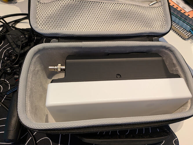

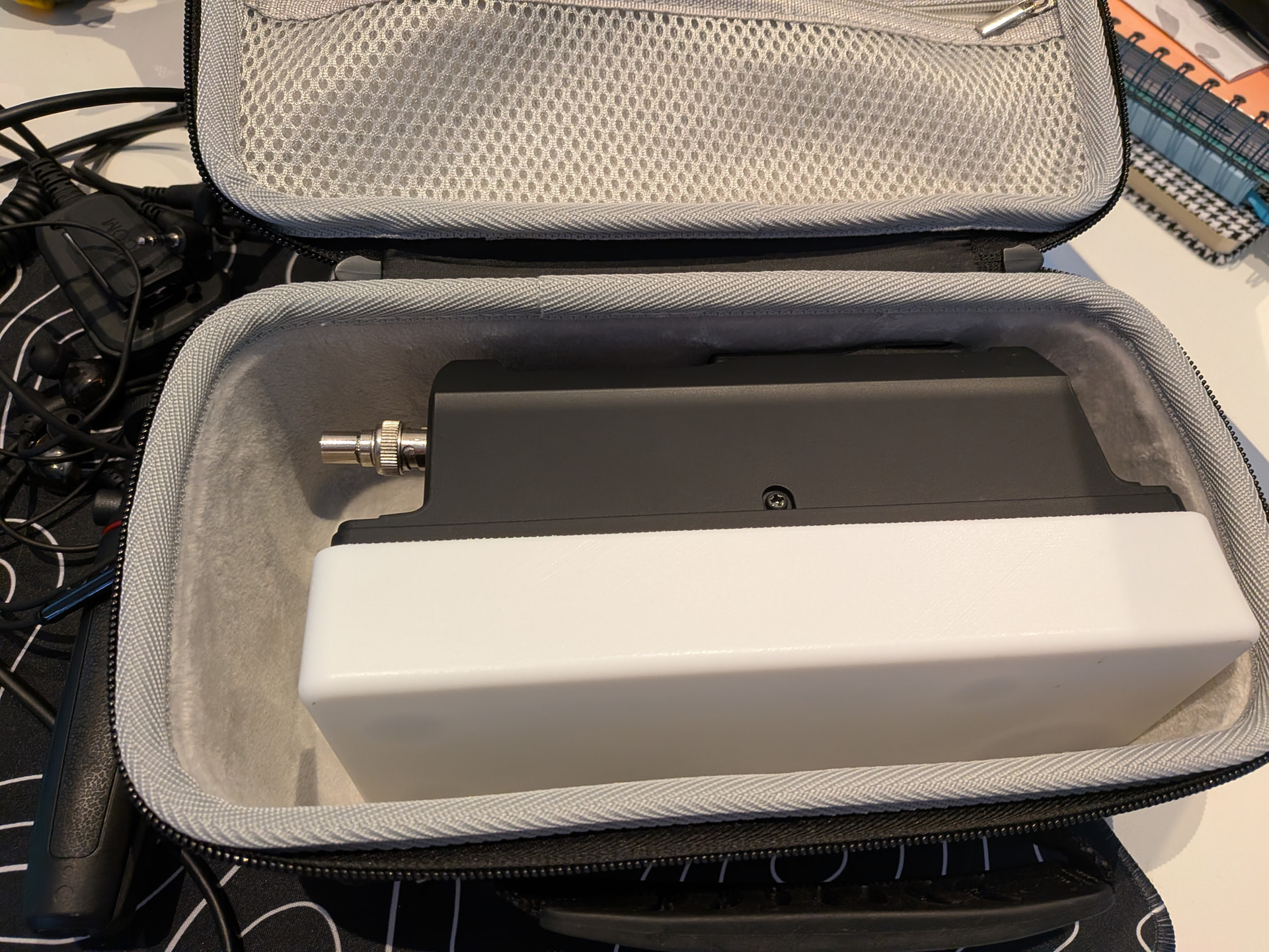

A case for a Bluetooth speaker
I read online, somewhere, that a case for the Bluetooth speaker Marshal Middleton makes a good case for the IC-705 (sorry but I don’t remember where I read that).
My review of it is that it’s a bit on the looser side. Maybe it would be perfect if I had the Windcamp cage, which I don’t. You can also use the hand-mic to pad the empty space.
If you’re curious, this is the screen cover. Much recommended. I ordered it from JLC3DP.

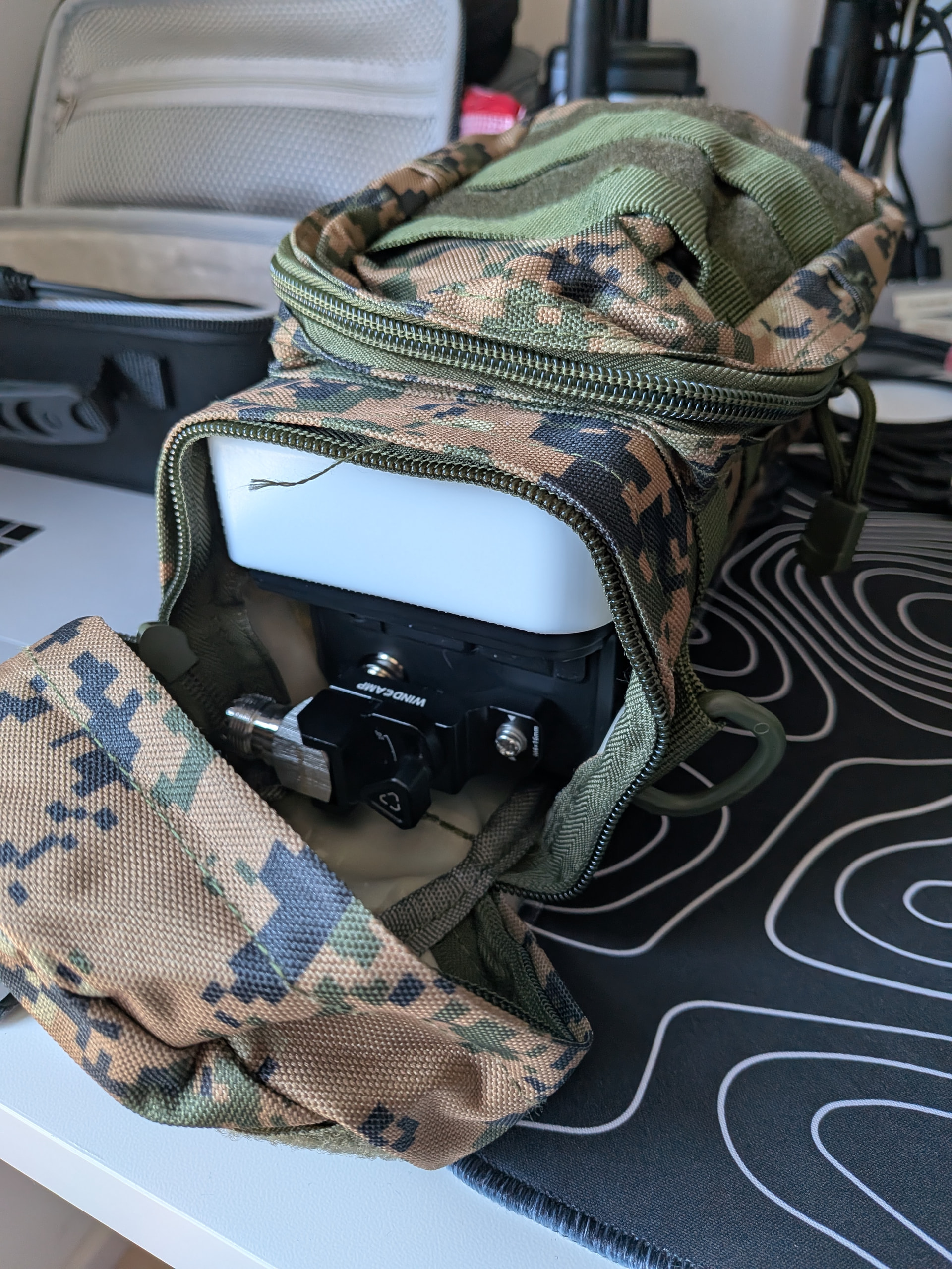

A water bottle bag
Again, somewhere around the internet, in a place that I also forgot where, I read that a water bottle bag is a good way to transport the radio.
I don’t agree. At least not the one I got from Aliexpress. It’s definitely too thin. I wouldn’t trust my radio with it, not even with the 3D printed cover.

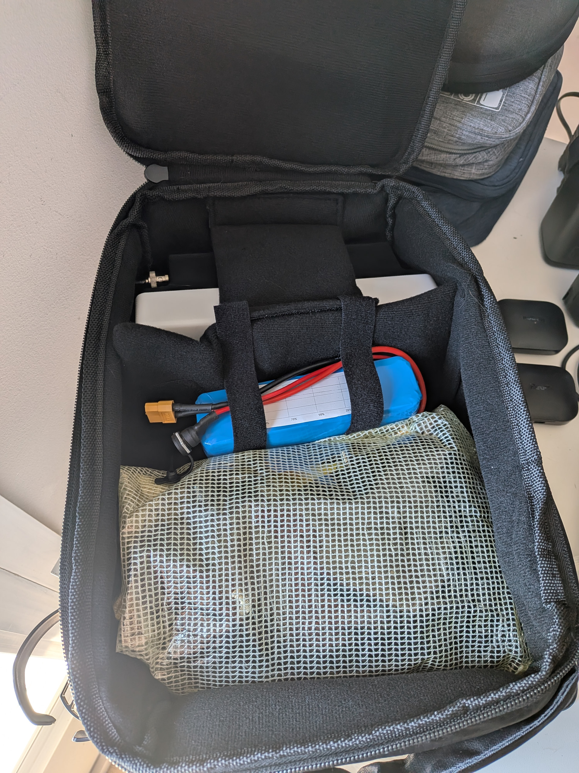

A camera bag
This is a good option, protection-wise. A thick-padded camera bag protects the radio quite well. I didn’t find one perfectly sized for the radio, though. So it’s a bit big and a bit heavy. On the up-side, it can transport most of my accessories as well, including my external battery.

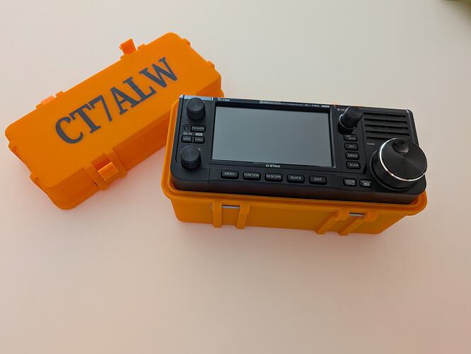

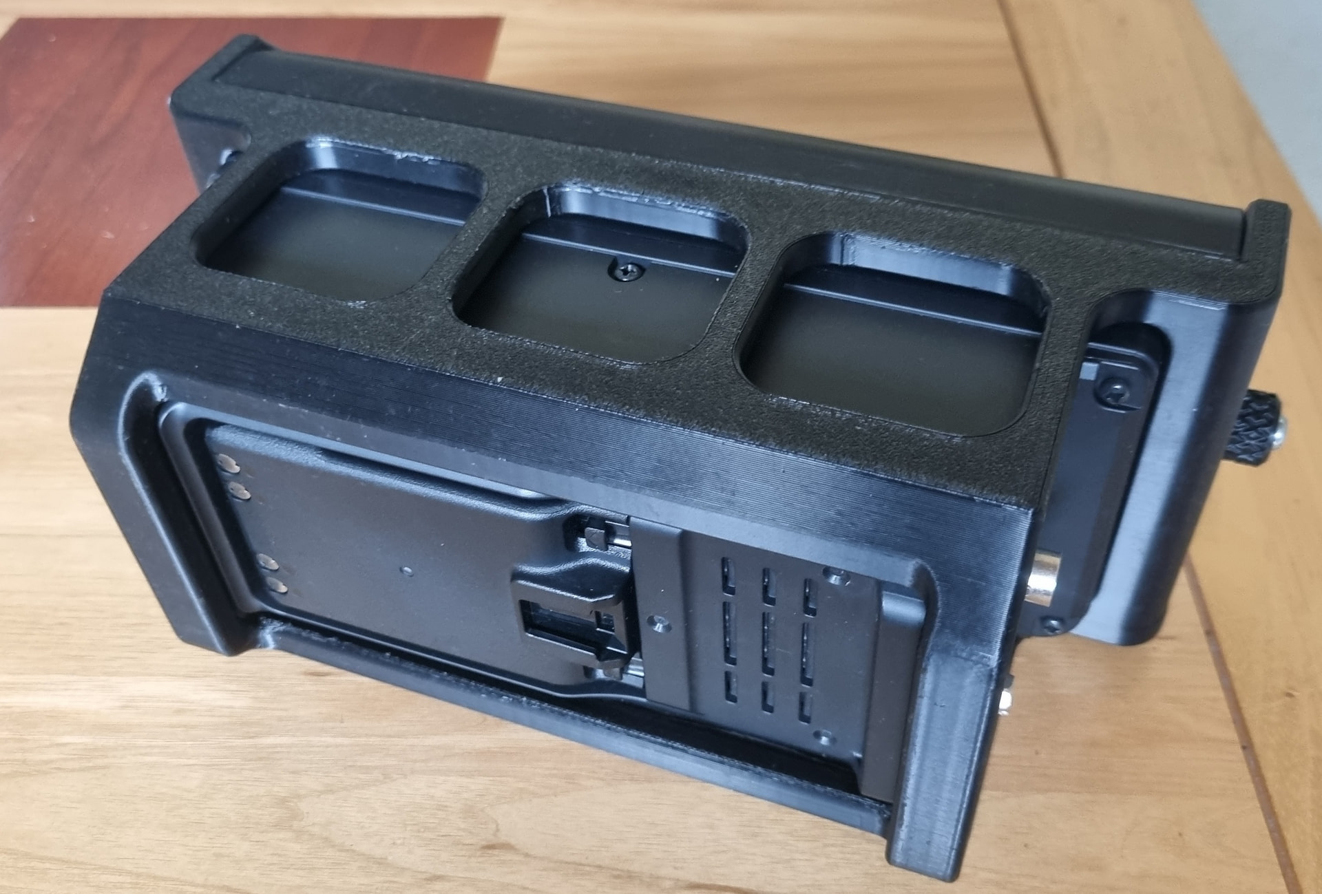

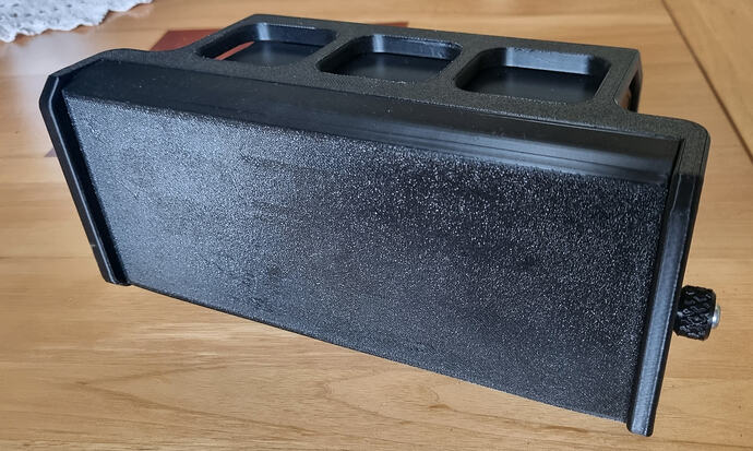

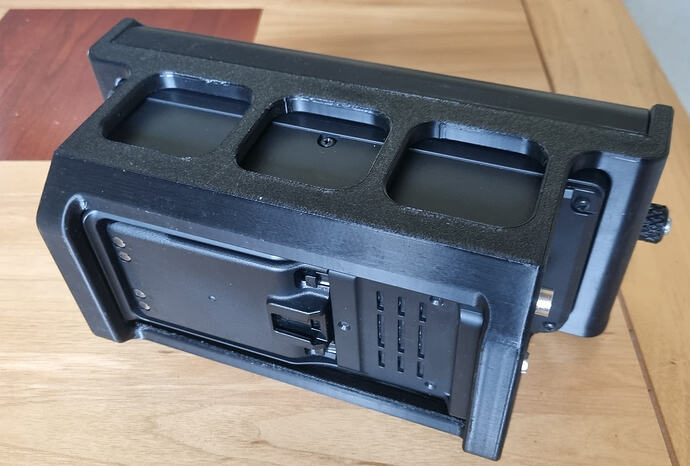

A dedicated 3D-printed case
This is my favourite so-far. This is the model. Since I don’t have an atual 3D printer, I bought a print from a Spanish colleage on Wallapop. I got it in high-vis orange, with my callsign printed on it.
This is what I will use in the next activations. The radio fits tightly and really feels protected. It’s not as heavy as it looks either.

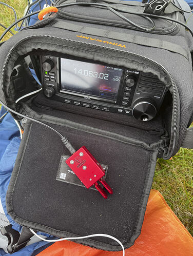

The Windcamp ‘Touring Series’ bag is pretty good and you can leave everything connected, but it would probably fit better with a cage installed.

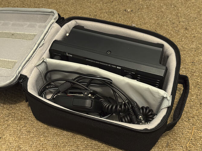

The Lowepro DroneGuard CS150 fits it like a glove and is much sturdier than the Lowepro bags that are sold for the KX2.
John EI3KA

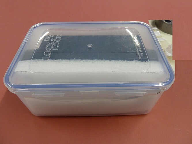

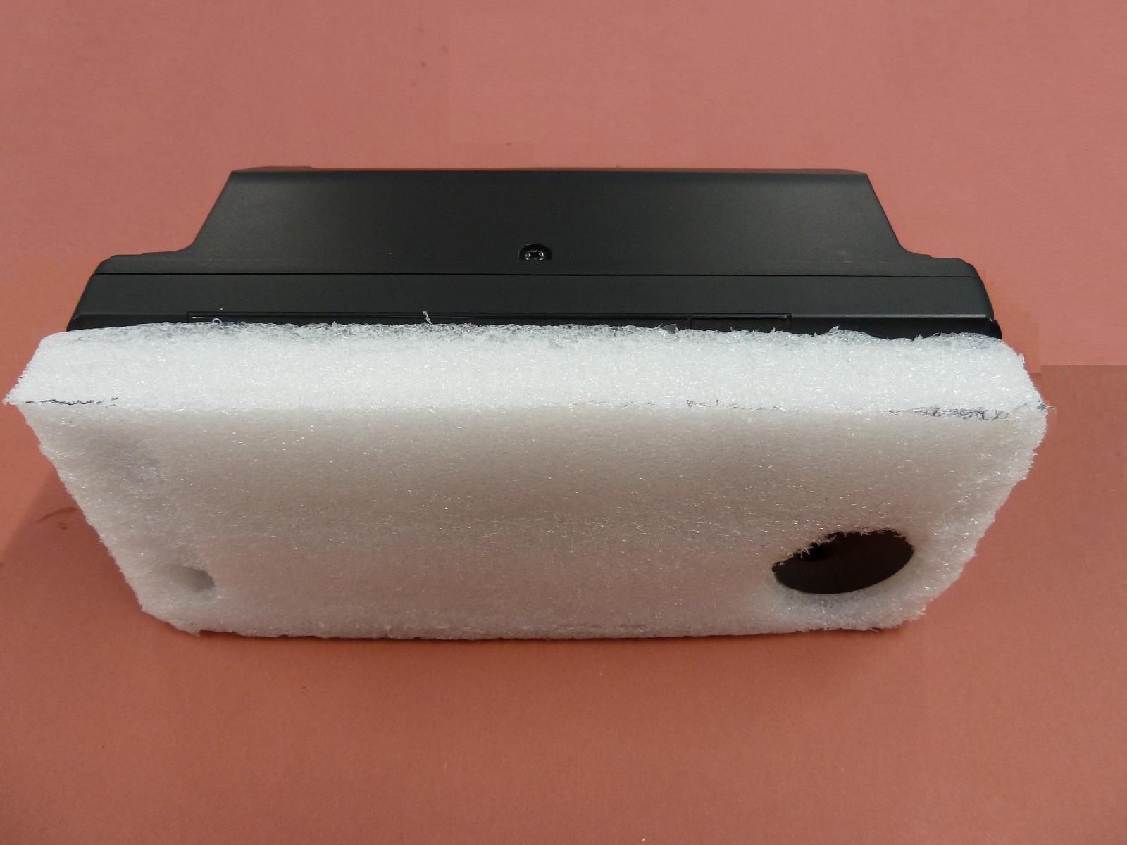

I just use a cheap “Lock n Lock” box and some foam packing with some adaptors & a patch lead. All the remaining accessories (power leads, Mike, etc) go in a padded envelope and then put the lot into my normal backpack.

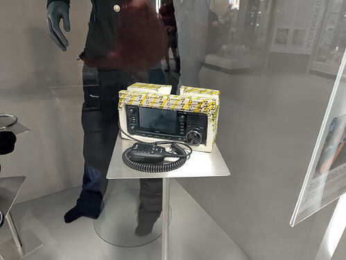

Just saw this one in the Technik Museum Speyer (DL) that has even used in space by an astronaut last year on board a Dragon capsule. Pragmatic solution for sure!
DL/PE4WJ

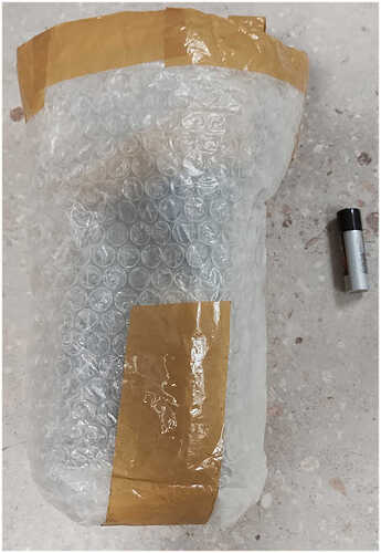

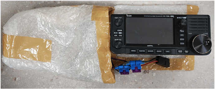

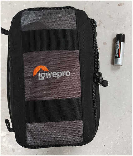

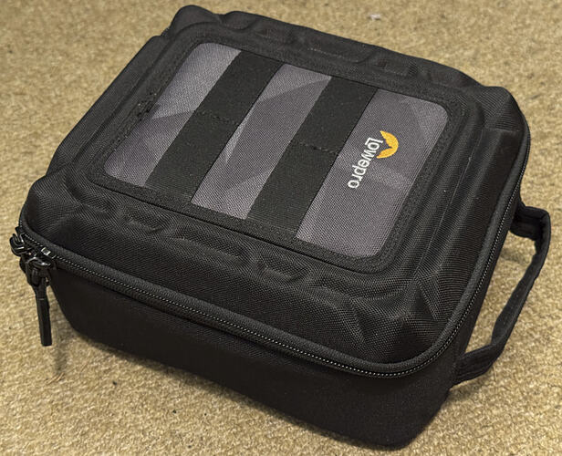

I splashed out a few months back and bought a nice Lowepro case for my KX2. Just big enough for the KX2 and its power cable. Mic and paddle live elsewhere in the bag. I need to get something for the 705 as it travels in a “super high quality” travel bag made from bubble wrap and wrapping tape. Seems to survive.
Pictures of KX2 and 705 with AA cell for scale.

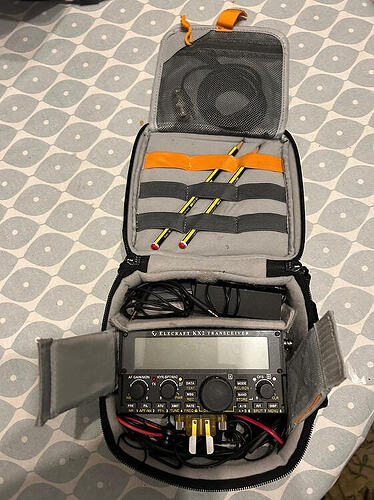

Now that you’ve started a general show-and-tell, here are my transport solutions:
  1. Dry-summer-only:

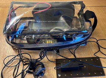

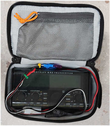

    Contents of my LowePro bag: KX2 with KXPD2 (attached), Palm Mini straight key (with extension 1m-long audio jack cable), Palm Pico paddles, 12v external battery lead, clip-over-ear earphones, two pencils, spare SO239-BNC adapter.
  2. Rest of the year:

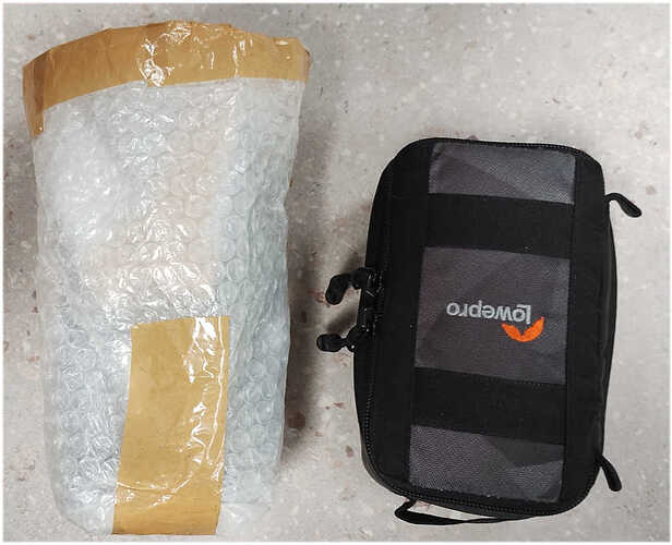

    During transport, the KX2 goes in the aforementioned custom bubble-wrap pouch (just like in Andy’s photo above accept my superior pouch has a flap that folds in to protect the end of the KX2).
I posted many times on ‘perceived flimsiness’ - whether it is my KX2 or FT817, carried triple-wrapped (bubble-wrap pouch, in dry bag/toilet bag then surrounded by other things in the rucksack) I’ve never had a problem.
The real risk is when you are operating where it could be dragged (by its cables by you moving) and falling onto rocks : always operate it low to the ground on something soft like your rucksack.
