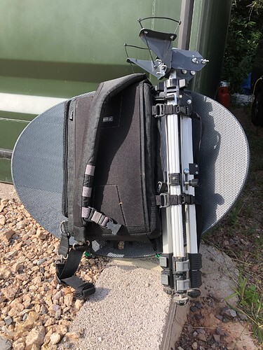

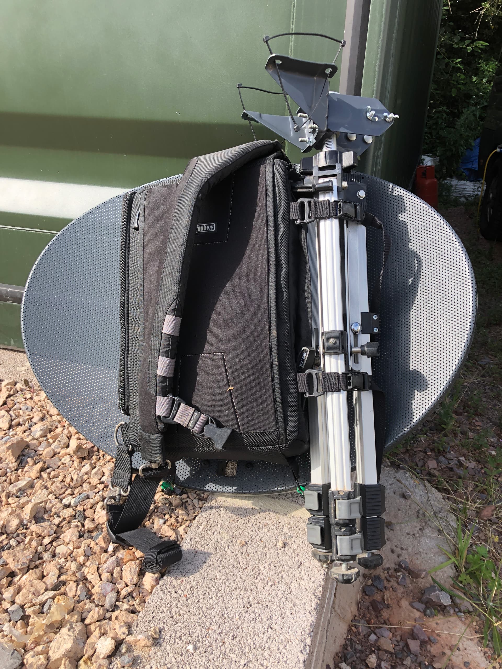

I have a /P setup for QO-100 which includes an 80cm dish. All the nuts have been replaced with winged nuts, making setup and take-down quite simple. And it all fits on / in a Think Tank rucksack.
It’s a CW setup, based on this… https://lipkowski.com/2021/02/07/low-cost-operating-on-qo-100-cw/ although I built a simple iambic CW keyer using an Arduino Nano to enable the PA module.
