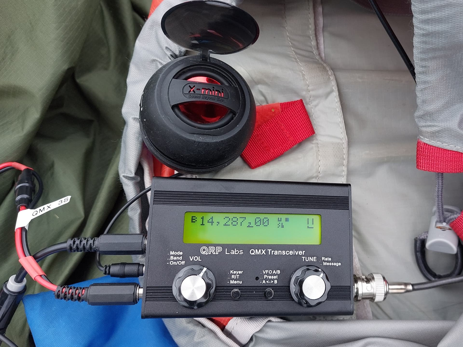

QMX from Qrplabs. $152 assembled (about ÂŁ115) plus shipping. Does SSB/CW/Digi. Only 5W but tiny.
Covers 80, 60, 40, 30 and 20m or
60, 40, 30, 20, 17 and 15m or
20, 17, 15, 12, 11 and 10m.
95 x 63 x 25mm excluding knobs.
I don’t have one but do have QCX (monoband CW only) and a QDX (multiband digi only) radios from Qrplabs.
Worth considering for weight/space limitedoperations.

Very definitely - unbelievably small and light for a 5 band radio.
Mine is on 200+ QSOs and counting. Another 3 s2s yesterday from G/WB-014 - only 12 QSOs on 7 and 14 MHz with the mid-band version and HWEF. Conditions were a bit up-and-down. 12V version running on tiny 3S LiPo 950mAh.
BUT needs great care with SWR and supply power.
Good luck, 73,
Rod

From talking to Hans at Friedrichshafen, adding SSB to the QMX took more time than the complete development of the radio without SSB up to that point.
Important to note is that he uses polar modulation (where SSB is created by splitting the signal into phase and amplitude components and then re-combining them in the final amplifier stages) which allows the finals to be a lot more efficient as they don’t have to be linear. So for say 5w output you don’t need 10w input to the final (and need to get rid of 5 watts of heat) probably closer to 7 watts - so battery consumption, for the same output, drops drastically.
He also employs controlled envelope SSB (CESSB) which effectively provides more “punch” from the same output signal. Similar to RF-audio-clipping processors you get an “effective increase” of around 100% on readability.
So in the end your 5w radio takes perhaps 8w from your battery as opposed to 12w and the SSB signal is as readable to the listener as if you were putting out 10-12w of RF.

+1 for the QMX. VK3JBL and I did an activation recently only using the QMX. We had to carry a light load and had a ways to hike, so QMX it was. The QMX went surprisingly well on a loaded EFHW and we qualified quickly on SSB. Great value radio, but as always it depends on your use case.
Glenn VK3YY.

The QMX+ uses the same firmware as the QMX, so the SSB implementation is the same in both - just more bands in the physically larger “+”.
The rig is very robust, although I suppose it could be argued that the knobs are vulnerable. The knobs aren’t any more vulnerable than say with an FT857 or FT817. Hans is now selling side rails for the QCX mini / QMX (same product will fit either radio), so the knobs will be afforded some protection with those.
The display is of the most readable out there - the backlight is arguably too bright but you can turn that off. In sunlight the contrast of the LCD characters is very good.
