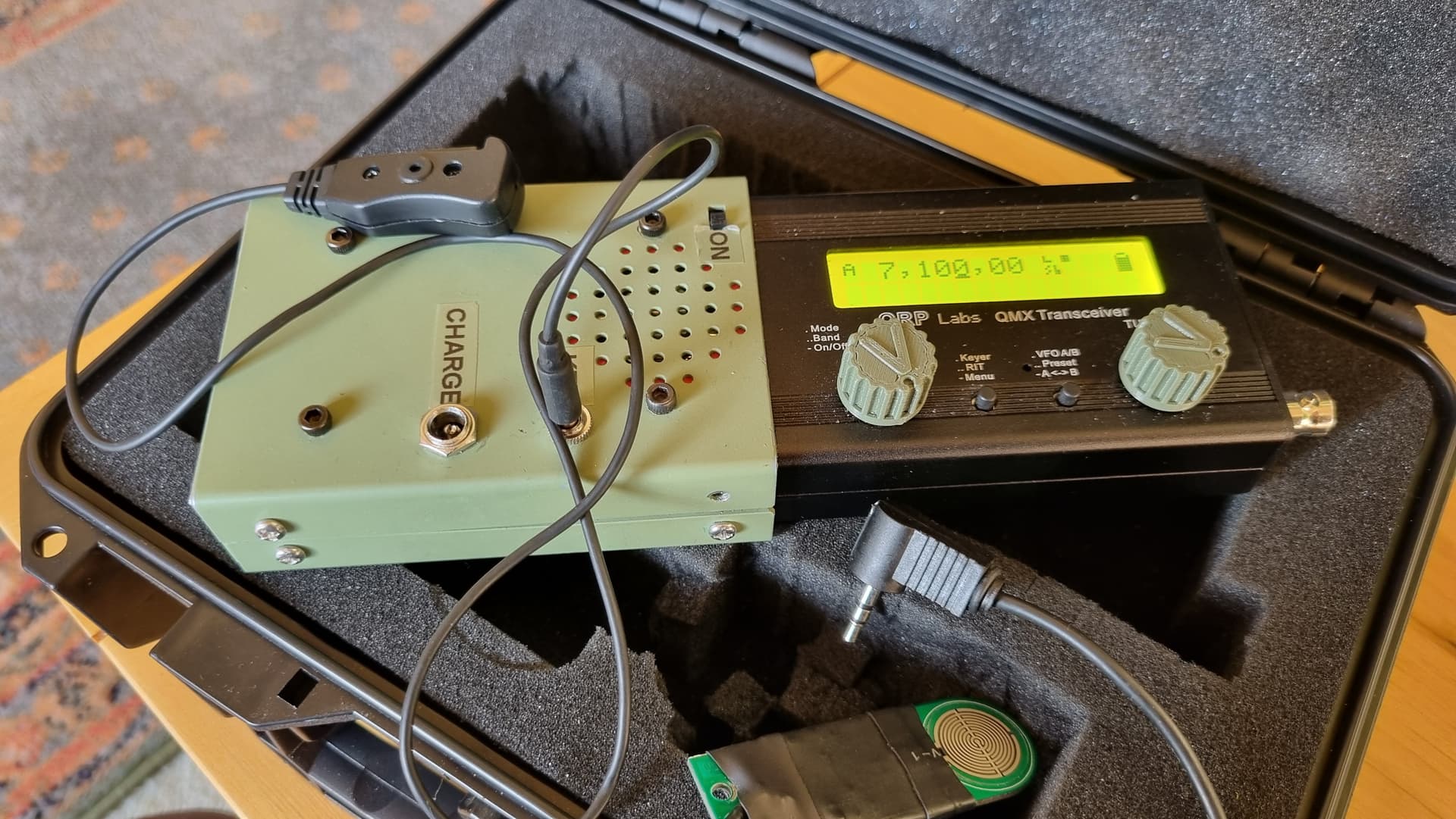

The display is very readable in bright light. A bolt on speaker and battery box were added to my QMX to keep everything together.
All up it weighs about 440g without the antenna. I’ve also 3d printed a slightly lighter battery and speaker box.
