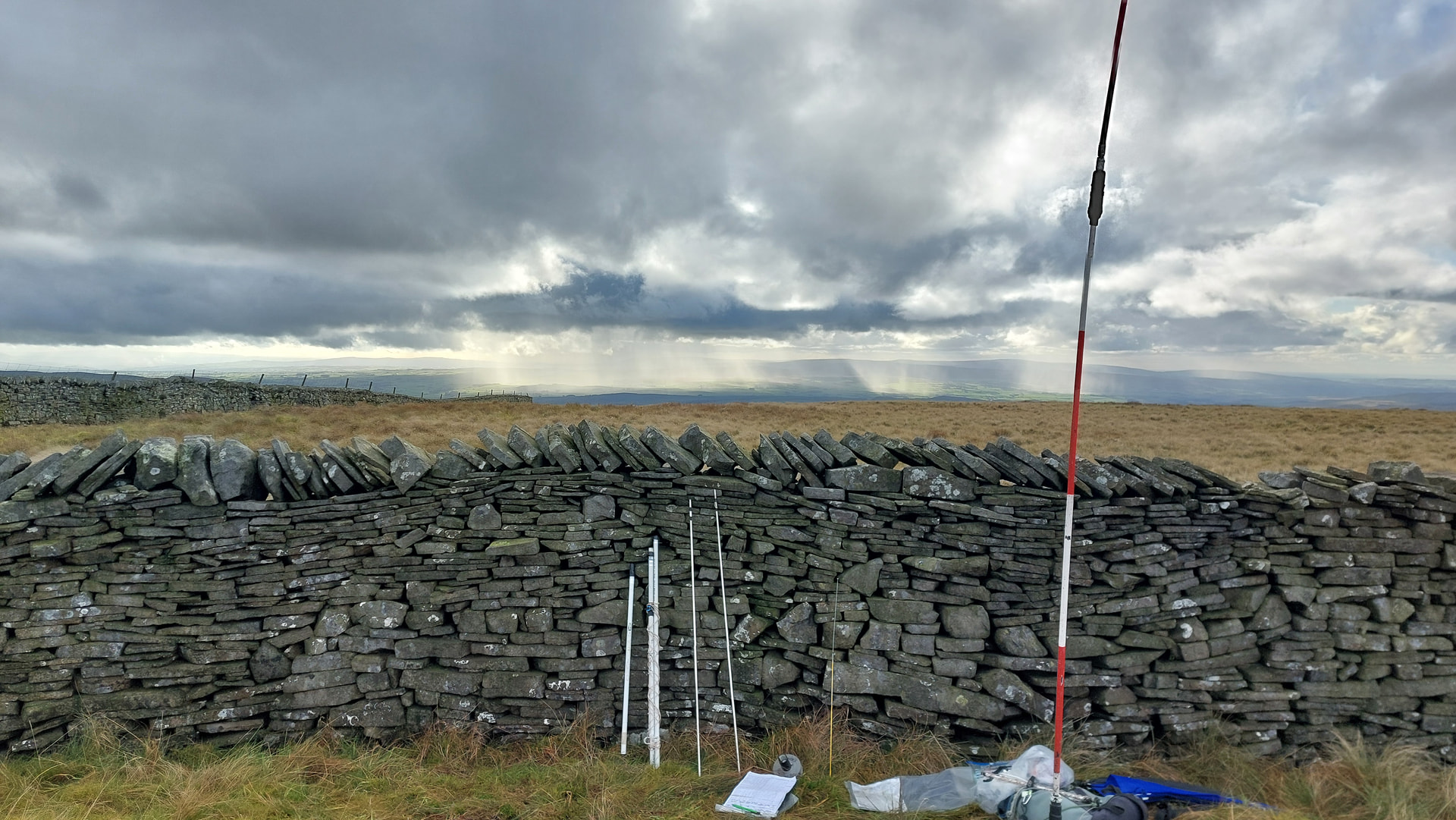

Setting up:
I tried to find the least soggy spot at the north side of the wall, eventually settling for SD 8634 7161. I was to find out later when deploying the dipole that there was standing water a few inches deep. Fortunately the good old Scarpa Ranger GTX’s kept it out completely which is more than can be said for my experiences later on while sitting or kneeling.

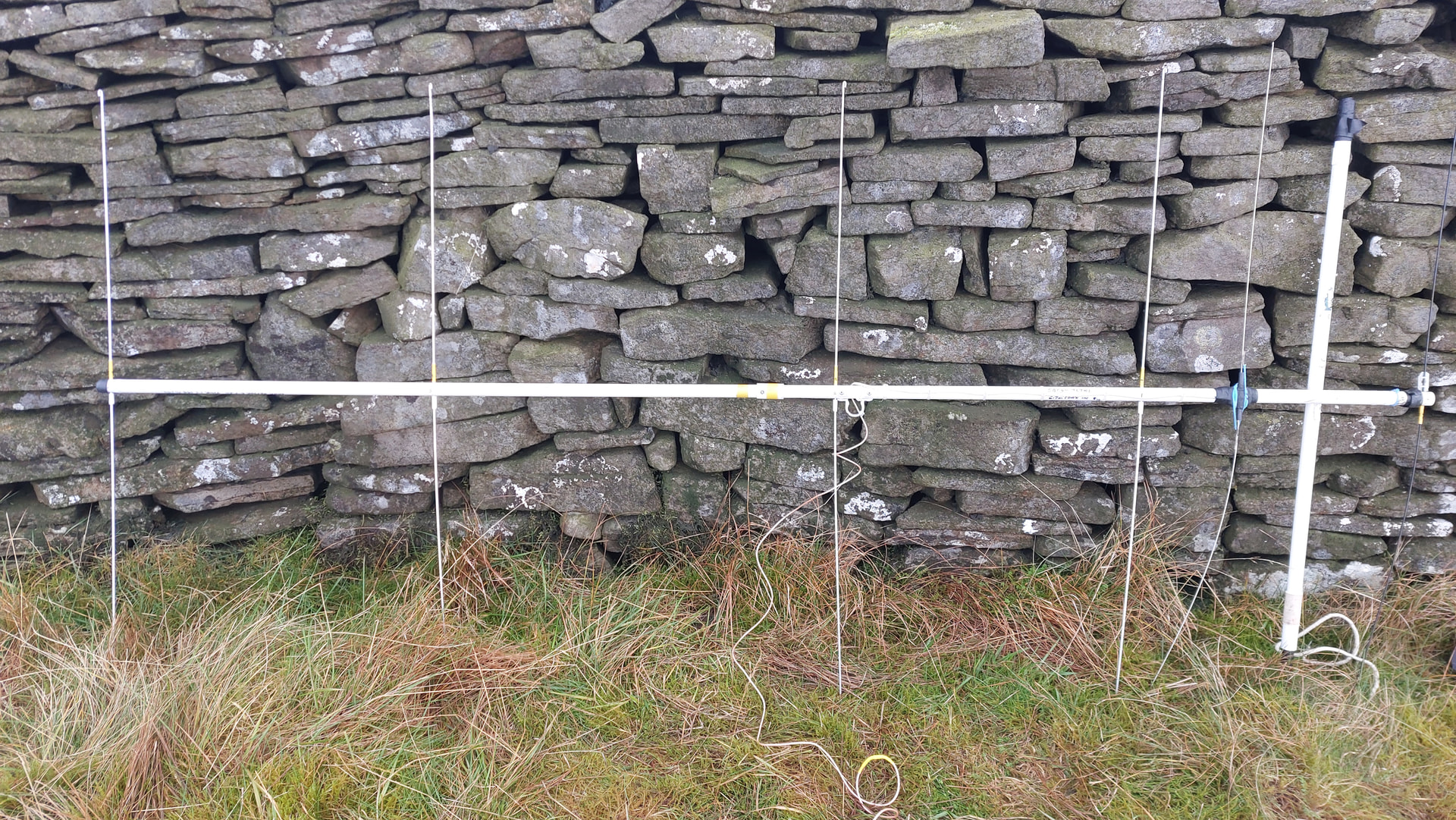

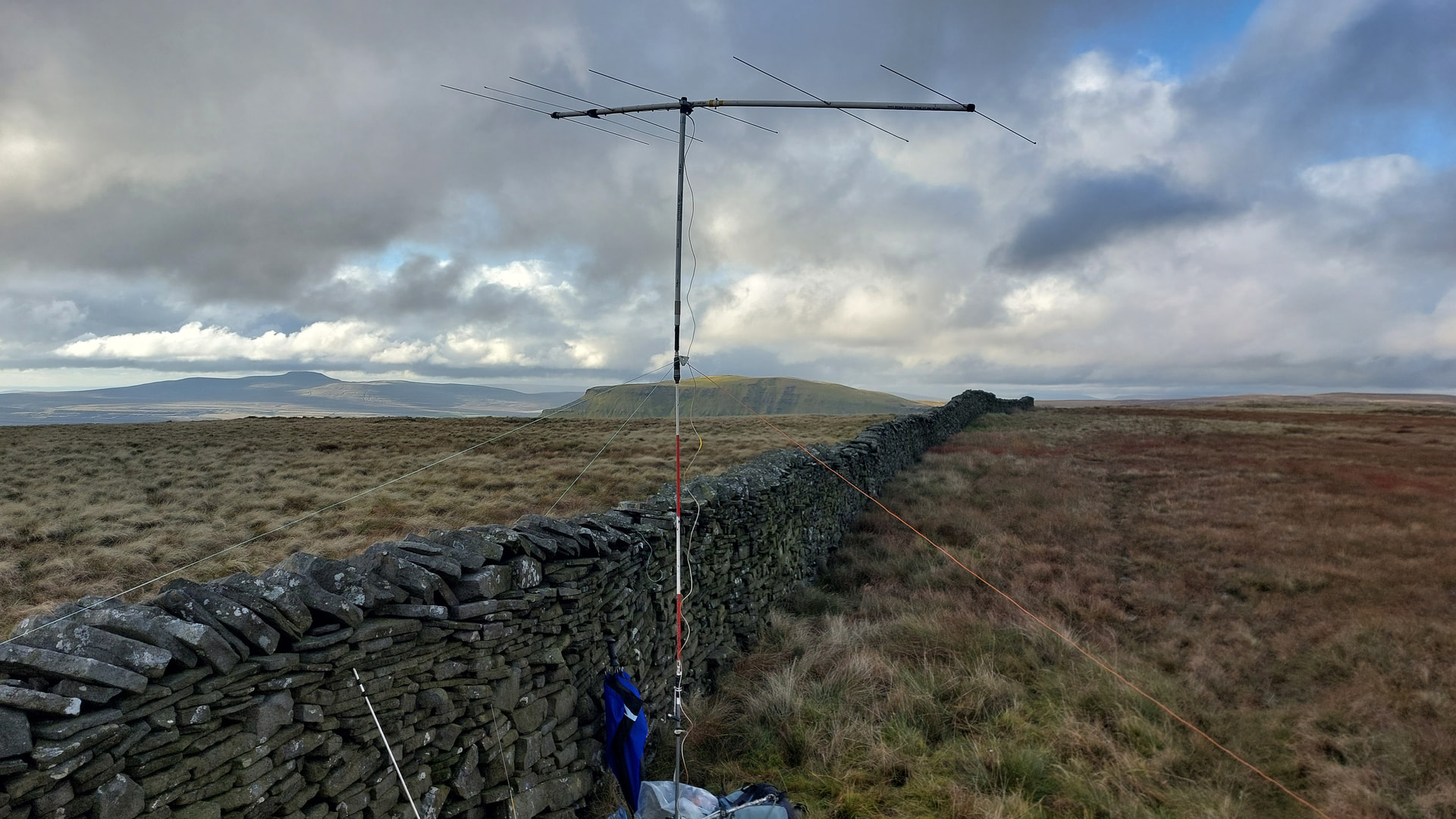

It took the best part of an hour to pack away HF and set up the 6-ele beam for 2m SSB. First it has to be assembled, then mounted horizontally on the two lower aluminium alloy/ carbon mast sections with a plastic conduit section added above for when the antenna is turned vertical.
It was windy which made guying necessary. For this I have a home-brew guying kit with a centre that fits over a mast section with three guys and three tent pegs. The big problem was the wall. It was catch-22. It had to be near the wall so I could rotate it but then I could only use a peg on one guy. The other two had to be tied into the wall top. I tried wedging them between heavy stones but they kept slipping. The wind was blowing the whole issue and the resulting setup continually looked ‘drunk.’ This caused most of the delay and was very frustrating but tenacity won in the end.
By 15:00z, all was ready and I was hoping for greater success than my last 2m-SSB activation in the Netherlands - zero QSO’s. Before starting I checked the compass and placed two unused mast sections crossed over on the grass to make a compass rose properly orientated. It helped significantly.
I also sorted out my sitting arrangements. After 3-hours my sit-mat had sunk below the water table which had overrun it and soaked through my trousers. As can be imagined, this had been causing a significant distraction along with the associated reduction in morale. An armful of sphagnum moss gathered and placed underneath the mat made things more bearable for the remainder of the activation but every time I had to get up, I got wet knees.

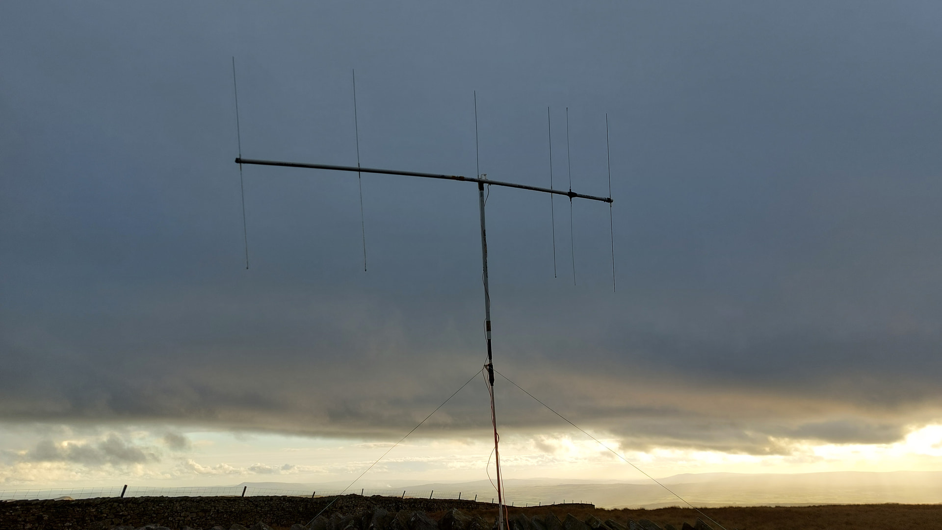

Three hours later I returned to 2m for an SSB/ CW session using 50W and my 6-ele. It could have been a different world but to be fair it really wasn’t. Apart from two QSO’s with Barnsley, I could have worked everybody with the earlier setup. Had there been anyone listening further away, provided they’d had good working conditions, my station could have worked them. I know this because in the UKAC contests, it’s been proven.
For the final session it was back to vertical polarization with the beam and FM, which at 50W is brutal on the battery. Once again it’s likely that all stations could have been worked with more modest equipment. Was it worth the effort of lugging up and assembling the more capable station? On this occasion possibly not but I could perhaps have helped the situation by providing timely alerts. Trouble is, I have something of a problem with alerts.

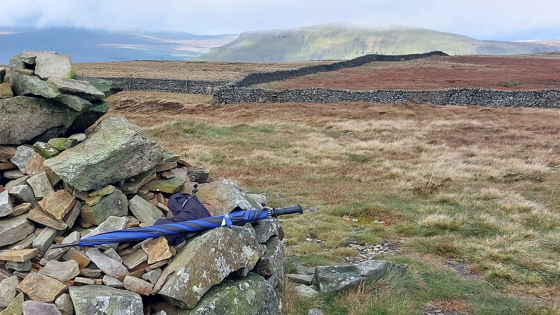

Above: Summit of Fountains Fell G/NP-017 with Pen-y-Ghent behind

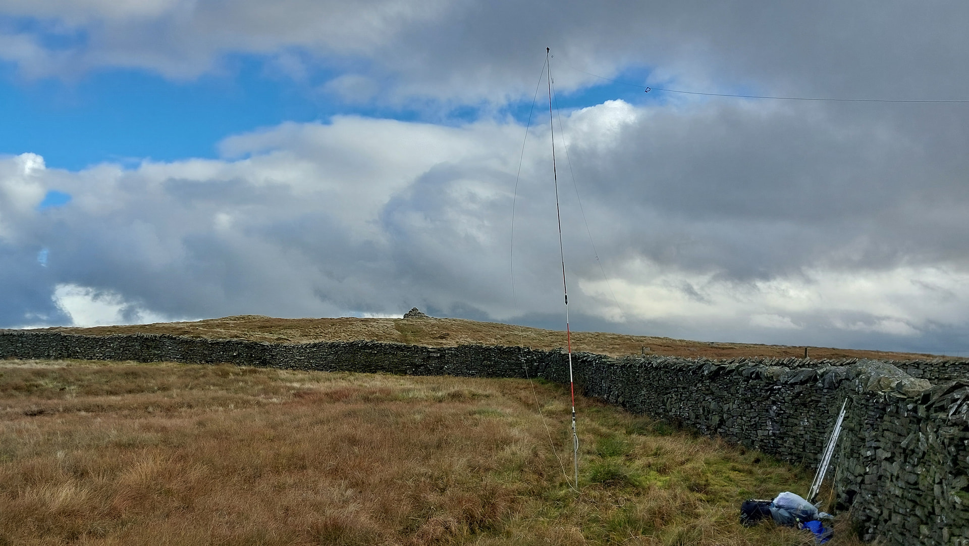

Above: Activation on HF

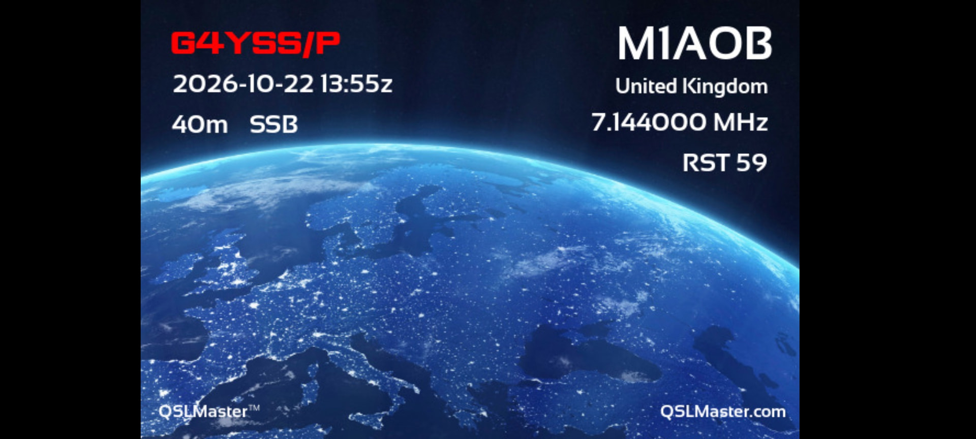

Above: This QSL card from M1AOB arrived just 10 minutes after working him! Thank You Richard.

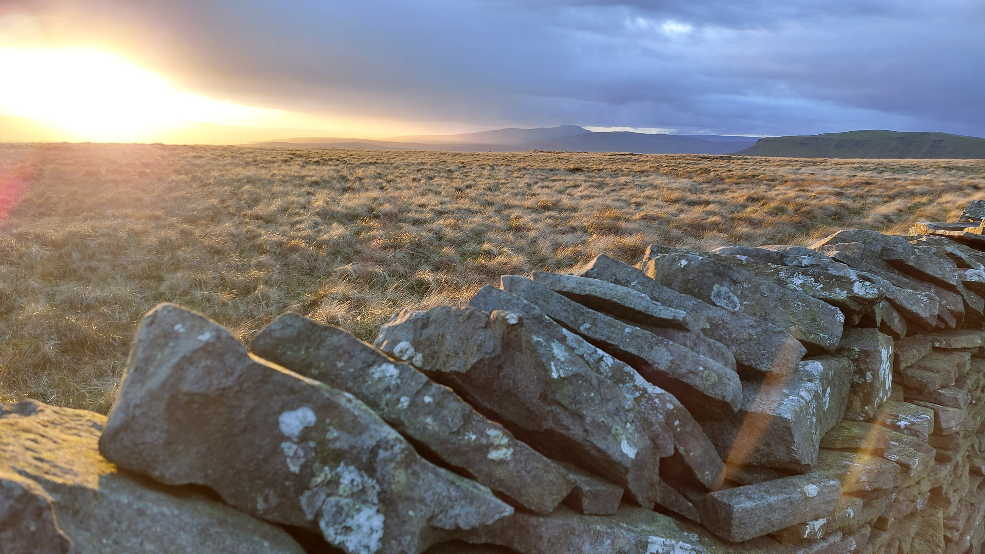

Above: A parting shot just before sunset

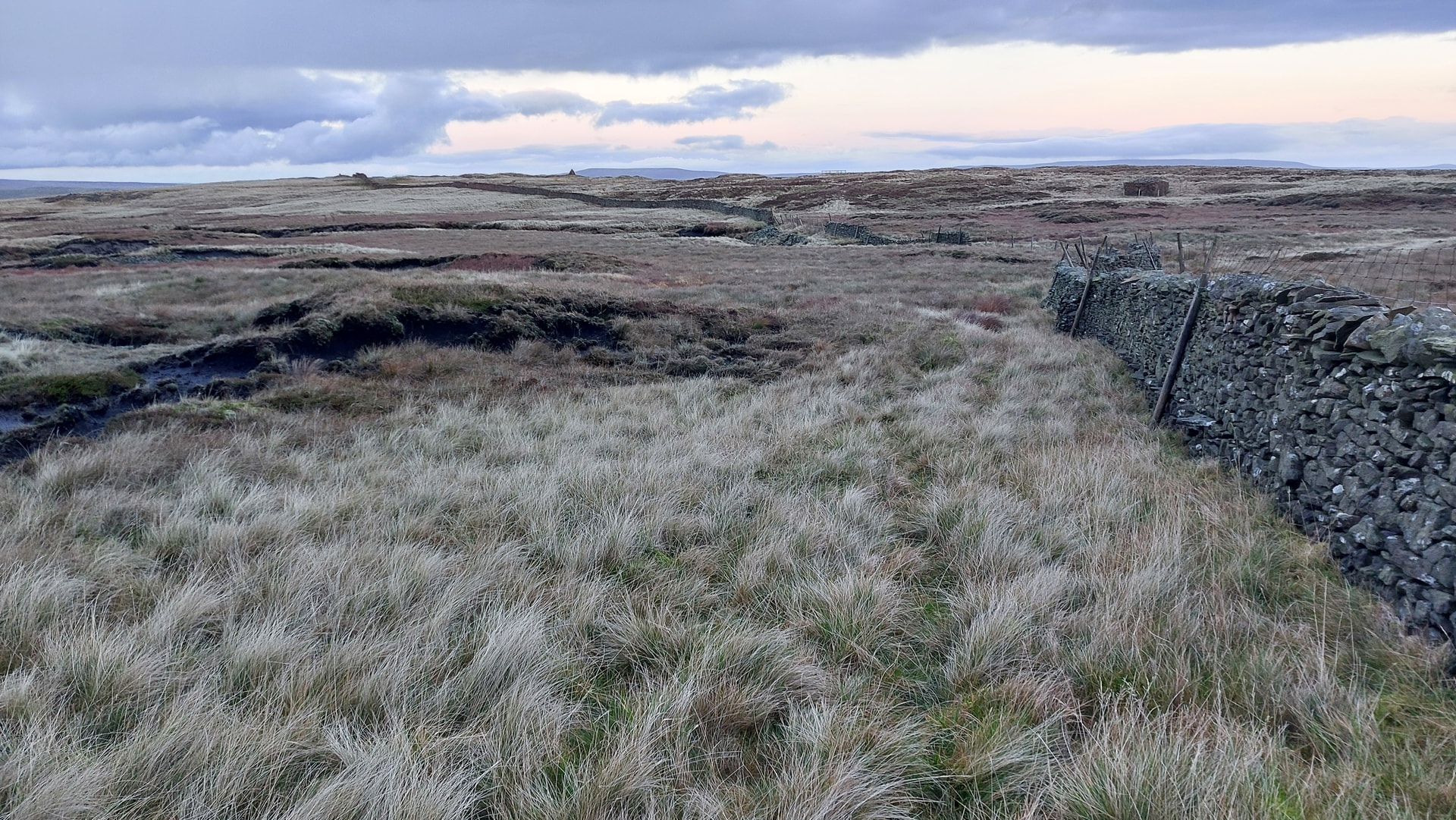

Above: The poor path on the NW side of the wall with trouble ahead in the form of deep groughs. Coke oven is on the right in fading light
