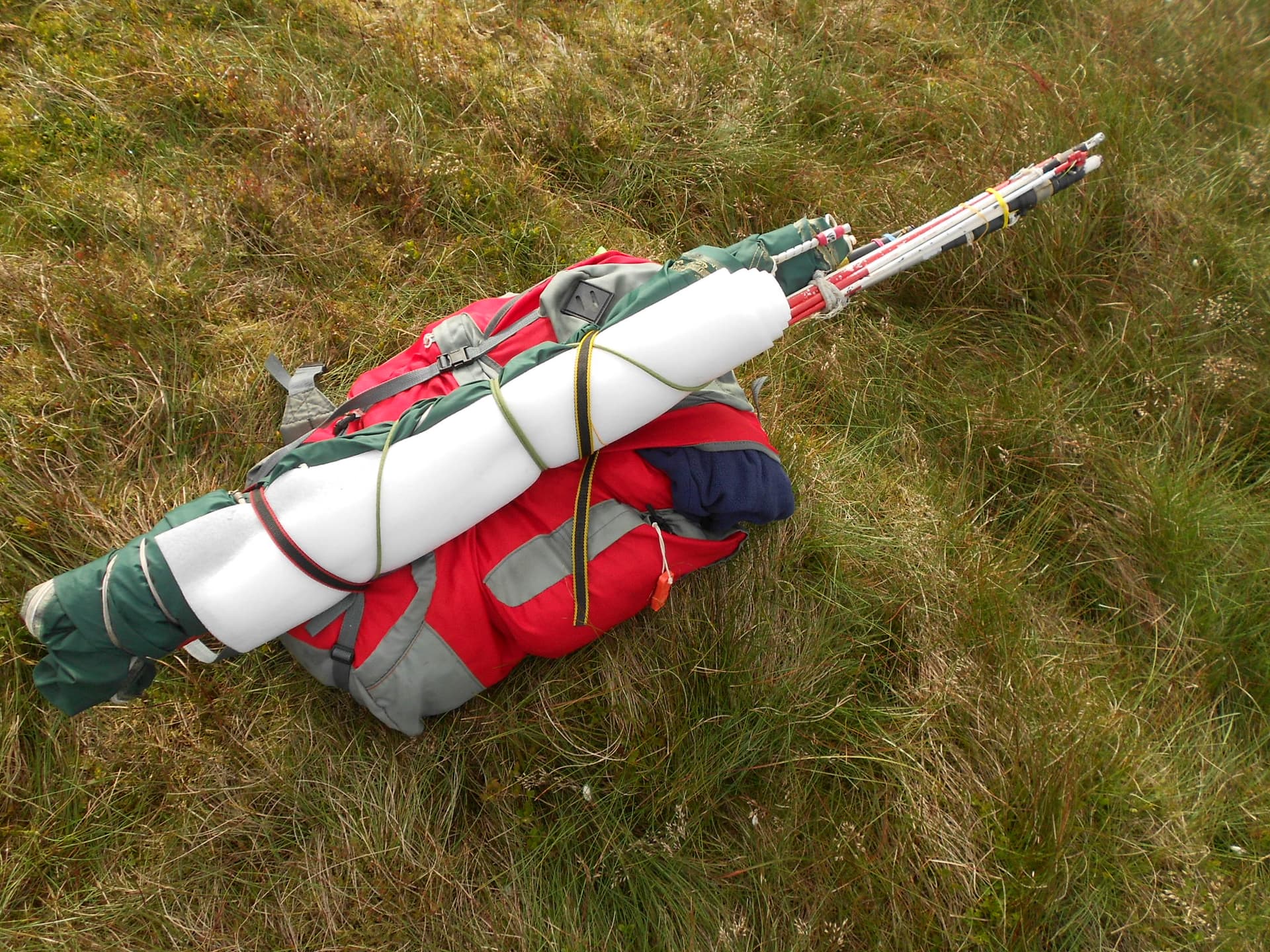

85 litre rucksack including 3.2kg of antennas, poles & flysheet on outside
15.3kg (33.7 pounds) inc. 0.25 ltr Ice; 0.25 ltr ENO; 0.5 ltr shandy & 0.5 ltr water

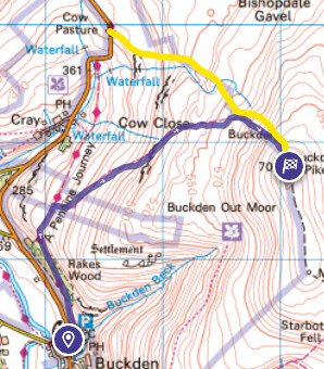

From the quarry parking place in Bishopdale (SD 9455 7996/ 413m ASL) the way is initially north up the tarmac, right through a gate at SD 9454 8000 then through a second gate at SD 9475 7979. A level path across pasture land connects the two.

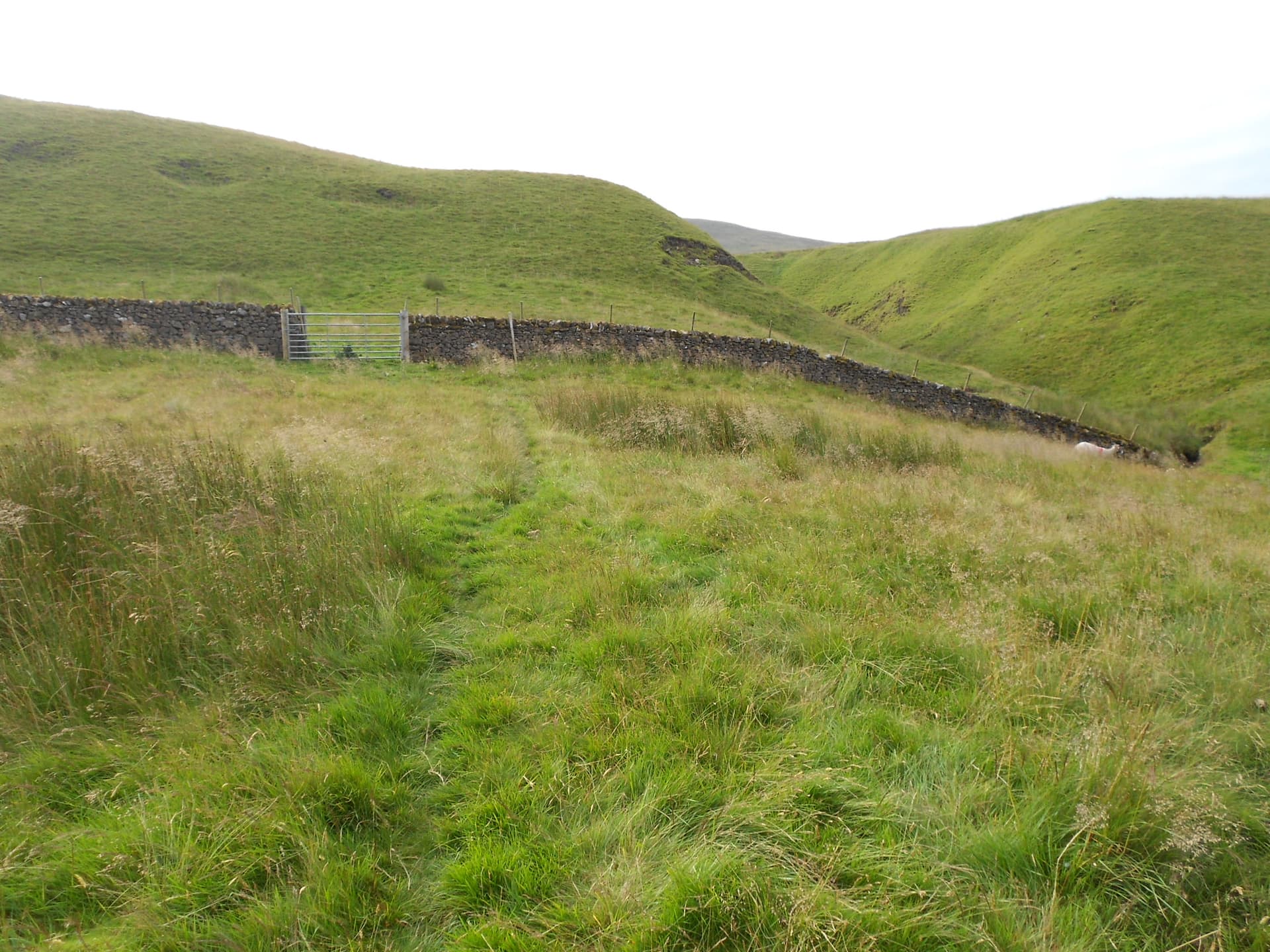

Follow a sheep path via: SD 9479 7975, SD 9486 7977 and SD 9507 7981 (at the latter point it is a quad track). Go up to a wall corner at SD 9516 7975 and then on to SD 9521 7966. Pass through a newly fitted steel gate in the wall at SD 9534 7954 and up steep ground to SD 9539 7951. Cross Cow Close Gill (usually dry) beside by the wall at SD 9546 7947, loosing a few metres in the process.
From the Gill crossing, swing right (south) to pick up the meager path again at SD 9547 7936 and SD 9551 7933 with the wall on your left. Less than 300m later this ill-defined wall-path joins the main path from Cray, at SD 9565 7921. Follow this path (some of it newly stone slabbed) via SD 9609 7885 to the trig point at SD 9608 7879.

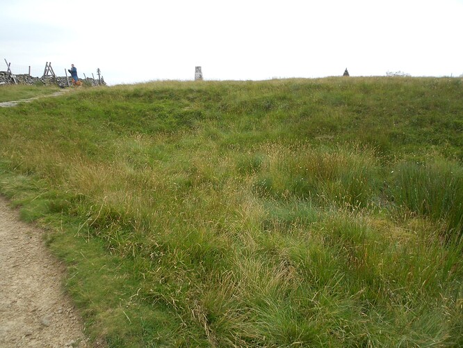

It was a relief to top-out but talking to a Hull man with his dog near the trig soon had me chilling in the cool breeze. Time to find a place to camp, open the rucksack and put on a fleece.

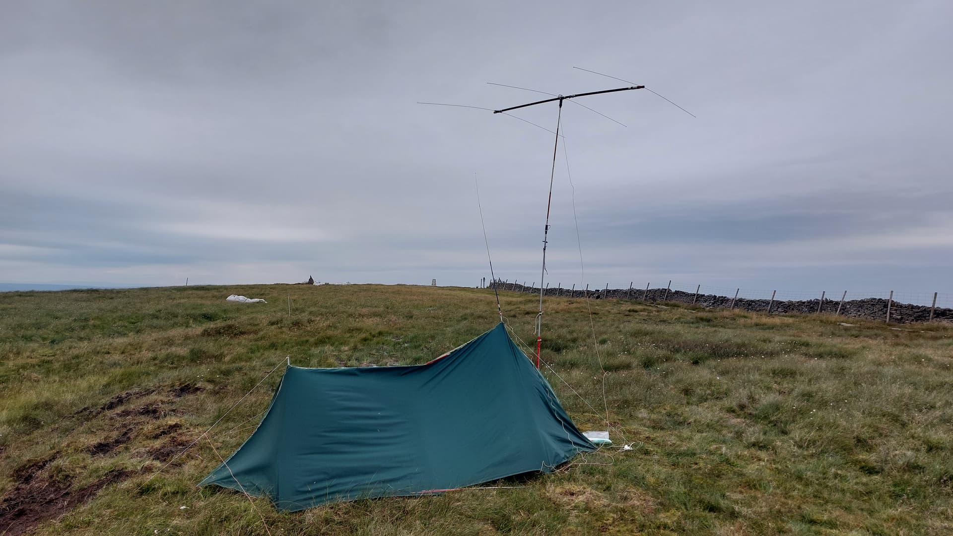

After a lot of walking around, the tent and radio station were set up about 40 metres north of the east-west running wall at SD 9606 7869 and about 100m south of the trig point. I have yet to find the ideal spot for camping because so many times in the past I’ve needed to be close to a wall for shelter. That was especially true for the new-year camp-out of 2019-20. This pitch was less lumpy than usual after quad bikes had rolled it somewhat. Almost everywhere was wet but at least here was a minor high spot, if only by a few cm. All around the summit is like a peat bog, especially after the amount of rain we’ve had lately.
After the tent and meager groundsheet, the dipole was next up with coils in place and resonated in between 1.832-CW to 1.846 MHz-SSB for later on. It would be taken down along with the top two mast sections and laid on the grass for the duration of the VHF contest but not before I’d opened the inner links and tried for some QSO’s on 20m. More of that later.
BUCKDEN PIKE, G/NP-009, 702m, 6pts, 17:01 on Thursday 18-July-24 to 07:47 on Friday 19-July-24: 18C. 10 mph SW wind decreasing to zero overnight Mainly overcast both days. No low-cloud or rain. Very poor Vodafone coverage – nil or delayed self spotting. LOC: IO84XE, WAB: SD97. Trig: TP-1744.

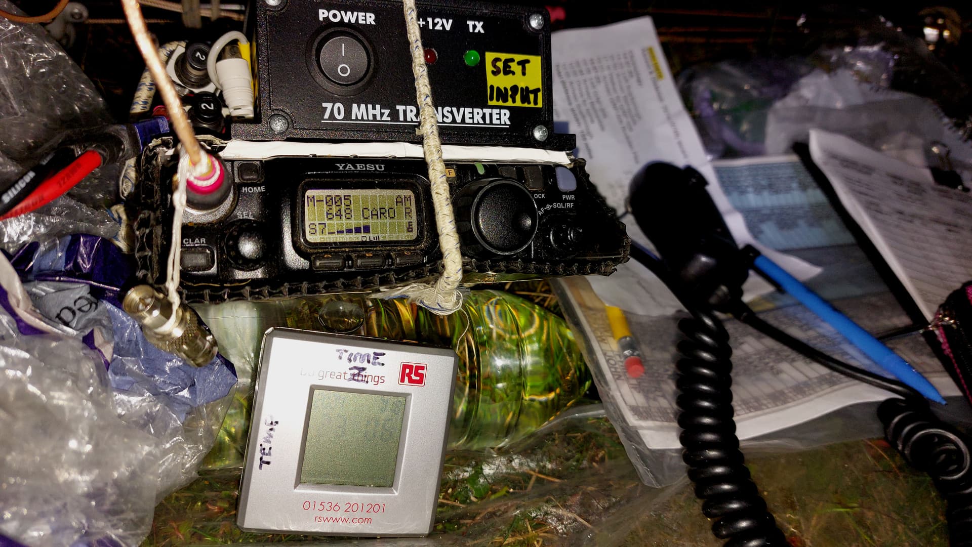

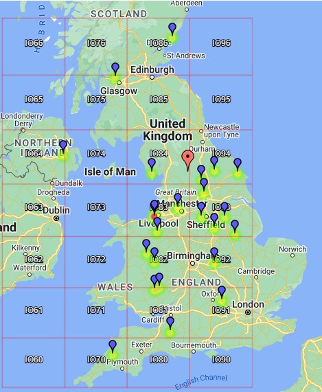

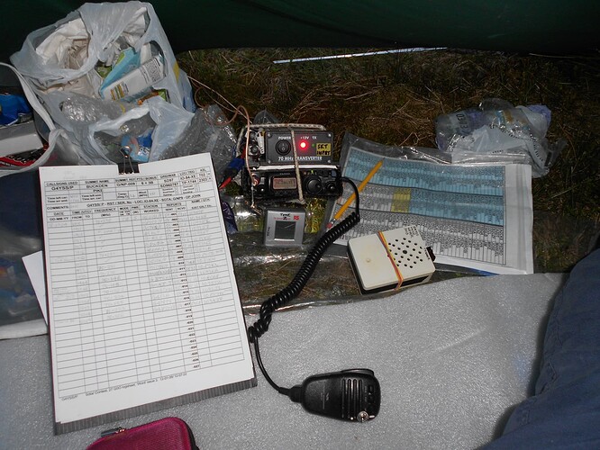

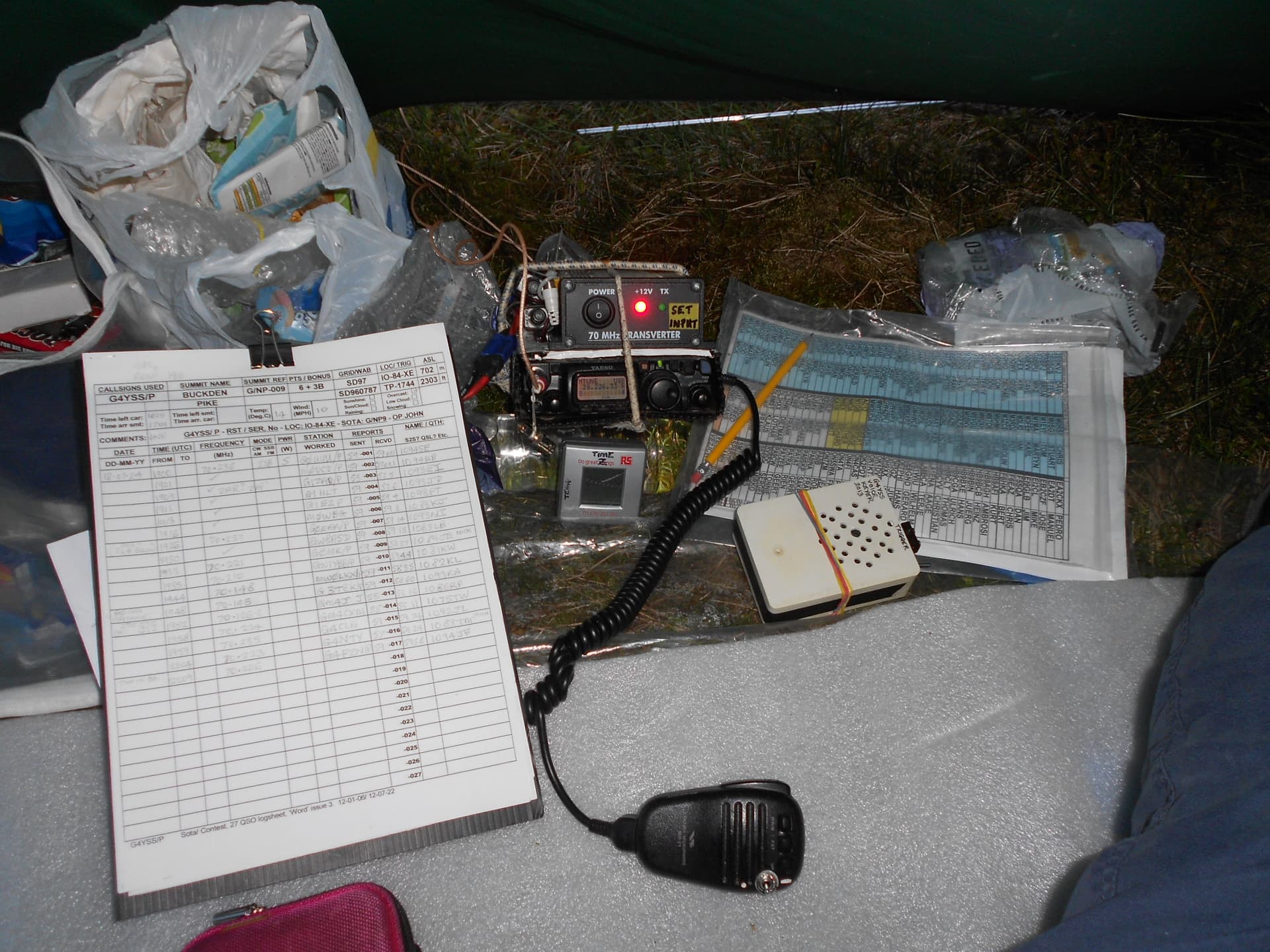

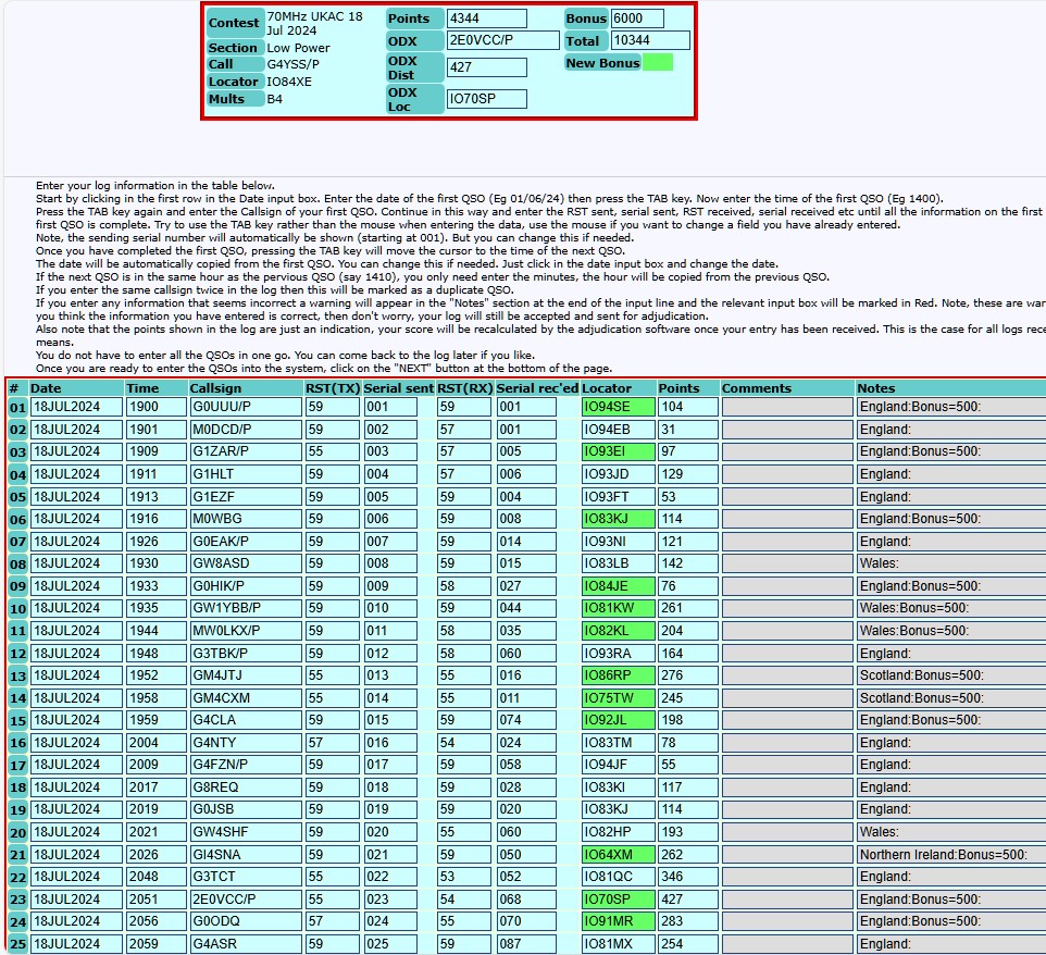

UKAC 70MHz Contest 19:00z to 21:30 z – 25 QSO’s:
I didn’t log them as separate QSO’s but just before the contest a sked was arranged on 70.236-SSB. Sure enough son Phil G0UUU/P and XYL Bev had now reached their IO94SE portable location on the Yorkshire Wolds. With our respective Ukrainian 10W transverters and two 3-ele home-brew beams pointed directly at one another, we exchanged at 59 both ways. M0DCD/P Andy also called in (52/ 57) so we primed him for a contest exchange at the stroke of 19:00z.
The start time duly arrived and I worked Phil again, this time with a proper contest exchange of Phil’s IO94SE for my IO84XE and 001 serial numbers. At 19:01z as arranged, Andy M0DCD/P bagged both our squares. In the absence of a phone signal, Phil kindly posted me on Sotawatch so I stuck with 70.236 for a while and called CQ using my home-brew voice keyer. The trouble is, how many SOTA chasers have 4m SSB facilities and a horizontal beam? Very few I don’t doubt.
Even if I’d had the phone working, I can’t spot myself because, unlike VHF-NFD, I intended to put in an entry to help the sagging fortunes of 807 ARO. Phil and I are two of an ever decreasing number of members. The remainder have either given up or joined Northern Fells. Three years ago, led by an enthusiastic Robert G3BUN, 807 topped almost everything in VHF UKAC’s. Now Robert is not so well and has had to step back. Would anybody like to join 807 and help bring it back to glory days? Let me know!
The rest of the contest - still on 70.236 MHz:
G1ZAR/P Stuart - a seasoned SOTA activator with 93 summits to his name - in IO93EI; G1HLT Ian in IO93JD; G1EZF Mick in IO93FT; M0WBG Neil in IO93KJ. Phil turned up to say I was too close to G4CLA so I nudged up 1kHz in response. However I only worked two more on the new fixed frequency - G0EAK/P Steve in IO93NI and GW8ASD Tony in IO83LB.
For success in the remainder of the contest - a hunting we had to go:
G0HIK/P Nick in IO84JE Nick; GW1YBB/P Steve in IO81KW; MW0LKX/P Wayne in IO82KL and G3TBK Dave - LOC IO93RA. Now pointing north: GM4JTJ Jon in IO86RP and GM4CXM Ray in IO75TW.
Two more: G4CLA Pete - LOC IO92JL and G4NTY John in IO83TM. That used up 16 of my serial numbers but it had taken over an hour. Slow going but after all this was 4m and I only had QRP.
G4FZN/P Chris was booming in from nearby IO94JF at the top of Sutton Bank. He’d been appearing all over the band, always working someone else but I finally nailed him down on 70.206. G4OBK Phil gave an account at Scarborough Amateur Radio club about Chris and here it is:
Would-be thieves on Sutton Bank:
Early in the year on a dark contest evening, two shady looking characters were spotted by Chris’ XYL. They were engaged in an earnest attempt to steal his generator, which he places some distance from his motor-home with the wiring in between. Lucky for Chris but sadly for them it was chained to a gate post. He chased after them and they sped off in a car! During a QSO, I asked him about this event and his reply was, ‘Now I have two chains.’ How about modifying it to live chassis, Chris?
From 20:17z to 21:00z:
I worked G8REQ Frank - LOC IO83KI on 70.266. Phil G0JSB broke in. ‘G4YSS, pse QSY ten down to 70.256,’ which I duly did to collect IO83KJ, then it was the turn of Steve GW4SHF (nice callsign) in IO82HP.
GI4SNA Dave, who can be regularly heard on the VHF bands, gave me IO64XM and serial number 50 (262km). Moving on: G3TCT Graham in IO81QC; 2E0VCC/P Darrell in IO70SP; G0ODQ John - LOC IO91MR and lastly Dave G4ASR in IO81MX.
For the final half-hour of the contest I managed to work precisely nobody. It wasn’t for the want of trying but the band got quieter and there were fewer people left to hunt. Calling CQ on ‘my’ freq of 70.236, for ten minutes at the pre-alerted time of 20:30z, hadn’t added anything to the log and I tried it again at 20:50z, also without success. I did get three stations in my sights including G7LRQ/P and M7DQO, carefully lining up the beam on them one by one but none came back to my calls. That wasn’t down to a pile-up, they just didn’t hear me so I will now need to bench check the 4m transverter output.

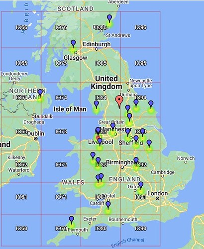

Best distance was 2E0VCC/P in Cornwall at 427km and at 74, just an hour from the start, the highest serial number I was given came from Pete G4CLA. That’s quite normal and unsurprising. I’m told Pete has a 7-ele on 4m, 4 x 10-ele on 2m and 4 x 28-ele on 70cm. 10:30 arrived and the feverish activity on 4m stopped abruptly until next month. Plenty of time to replace its lost ether.

I found the contest enjoyable because 4m is my favourite VHF band. Phil G0UUU and I were activating summits on the band long before SOTA came along. 10W to a 3-ele is never going to set the band on fire but added to the camping gear and HF, it’s all I can carry.
The voice keyer got quite a lot of use on the fixed frequencies but only a third of the contacts were gained in that way. Tuning up and down the band got most QSO’s. With this modest setup, it has proved very difficult to work outside the UK on 4m. In fact I don’t think I’ve managed it yet. Best distance was 2E0VCC/P in Cornwall at 427km. Next best was GI4SNA at 262km.

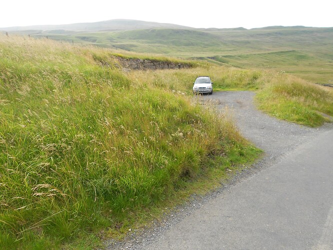

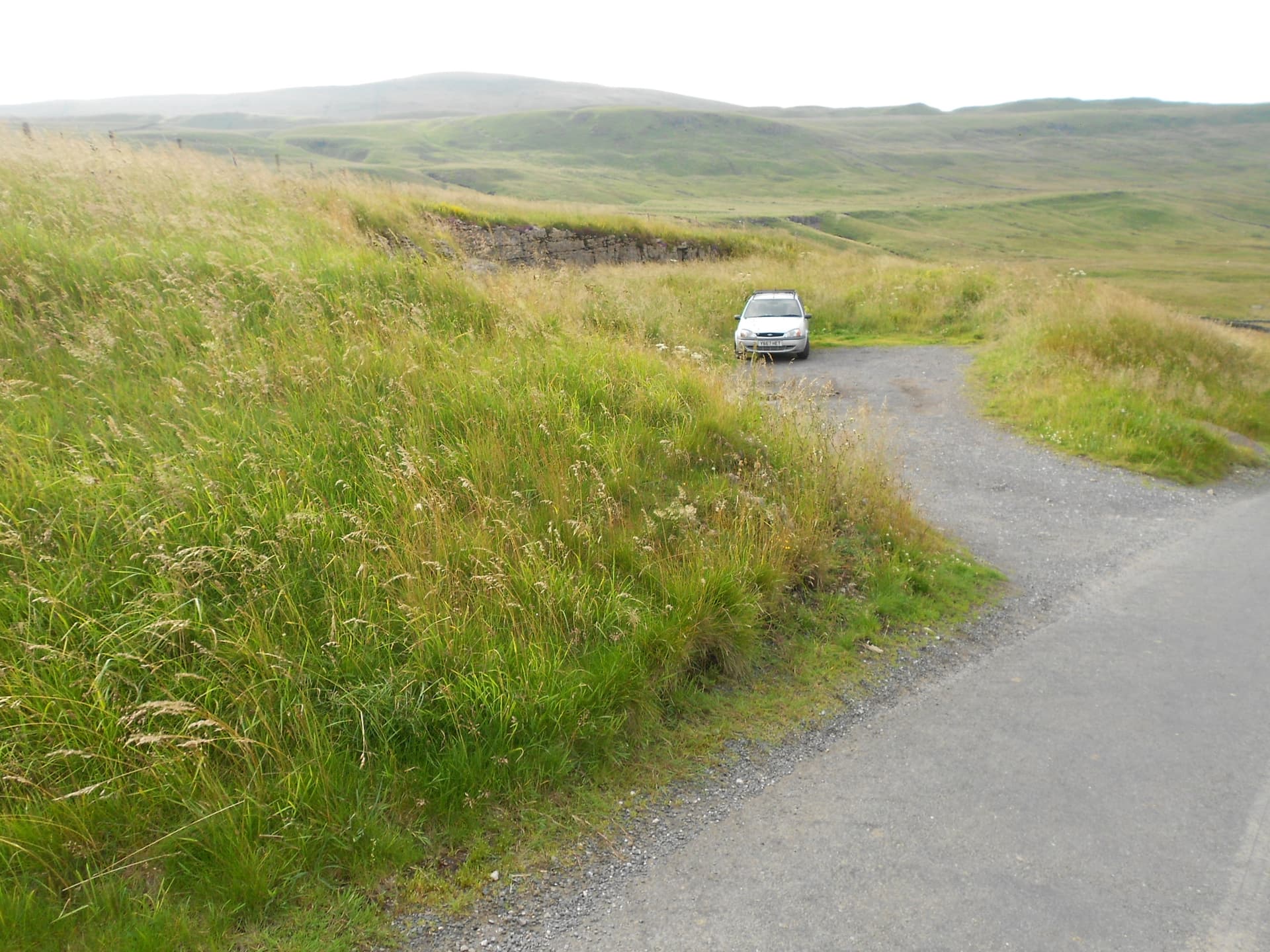

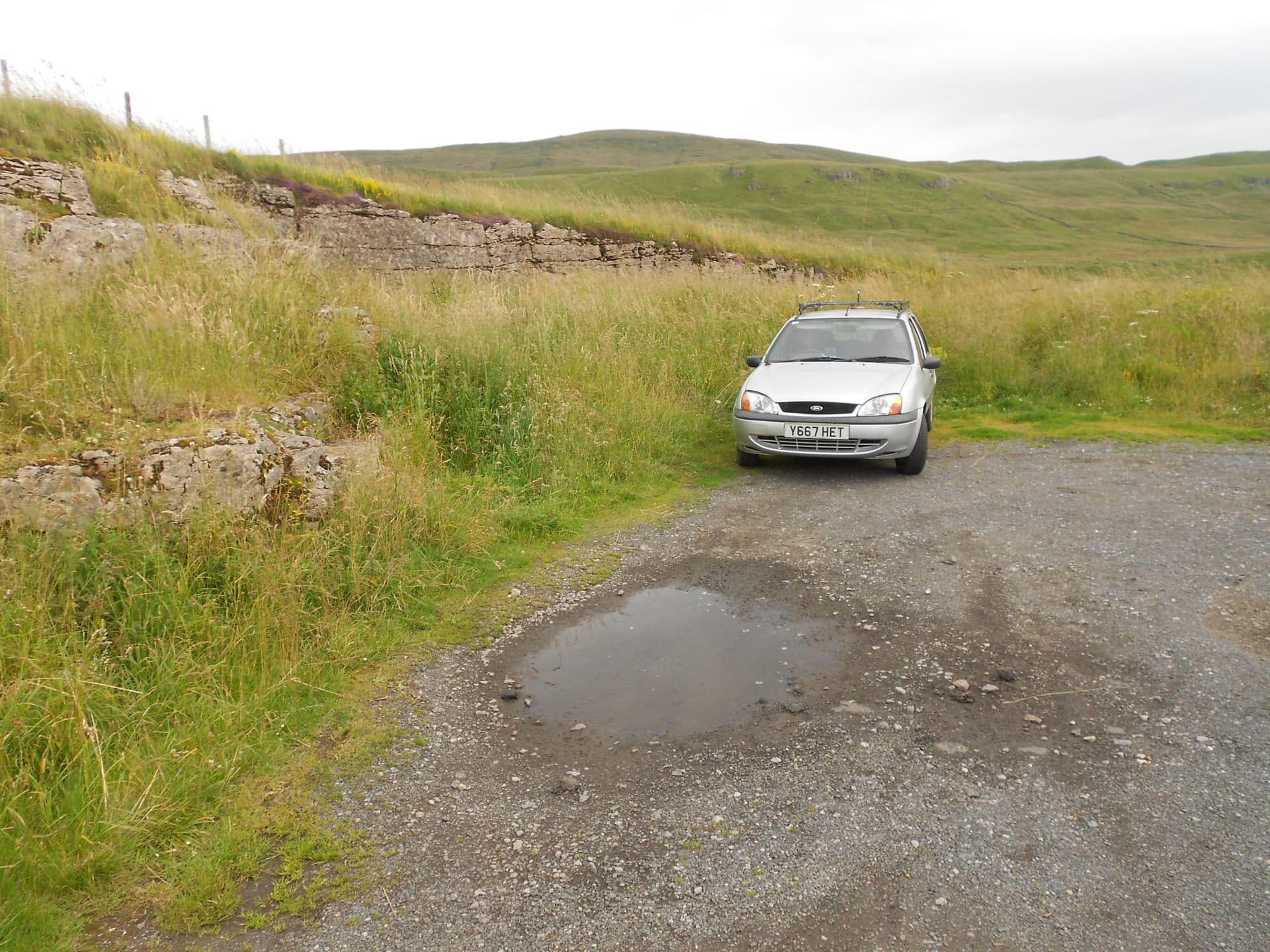

Above: Parking in the old quarry, Bishopdale B6160 at SD 9455 7996

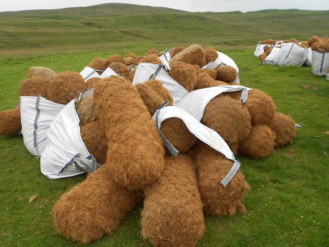

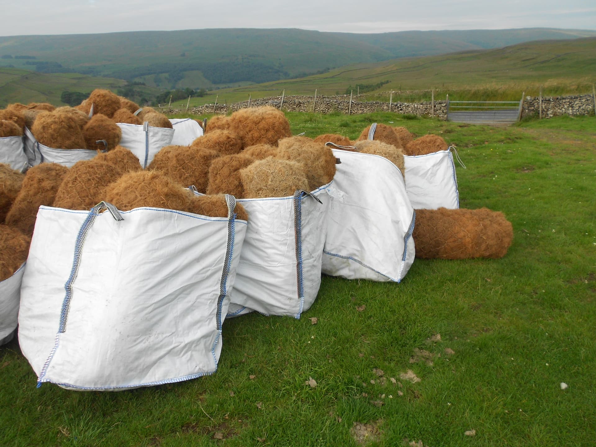

Above: In the field just off the road. Fibre bundles destined for the upper fell
Above: A new gate has appeared at SD 9534 7954. Until this year you just went through a gap in the wall

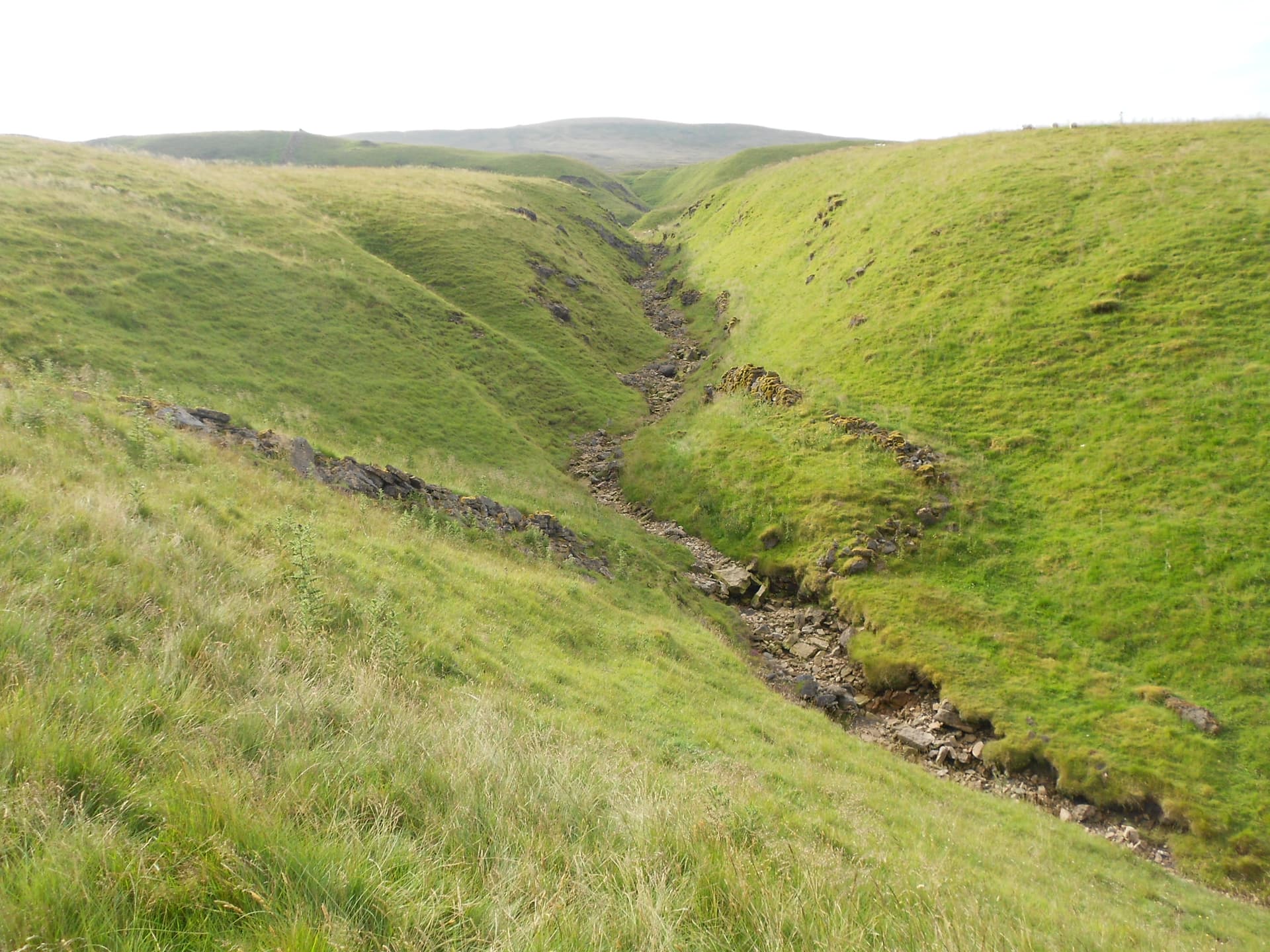

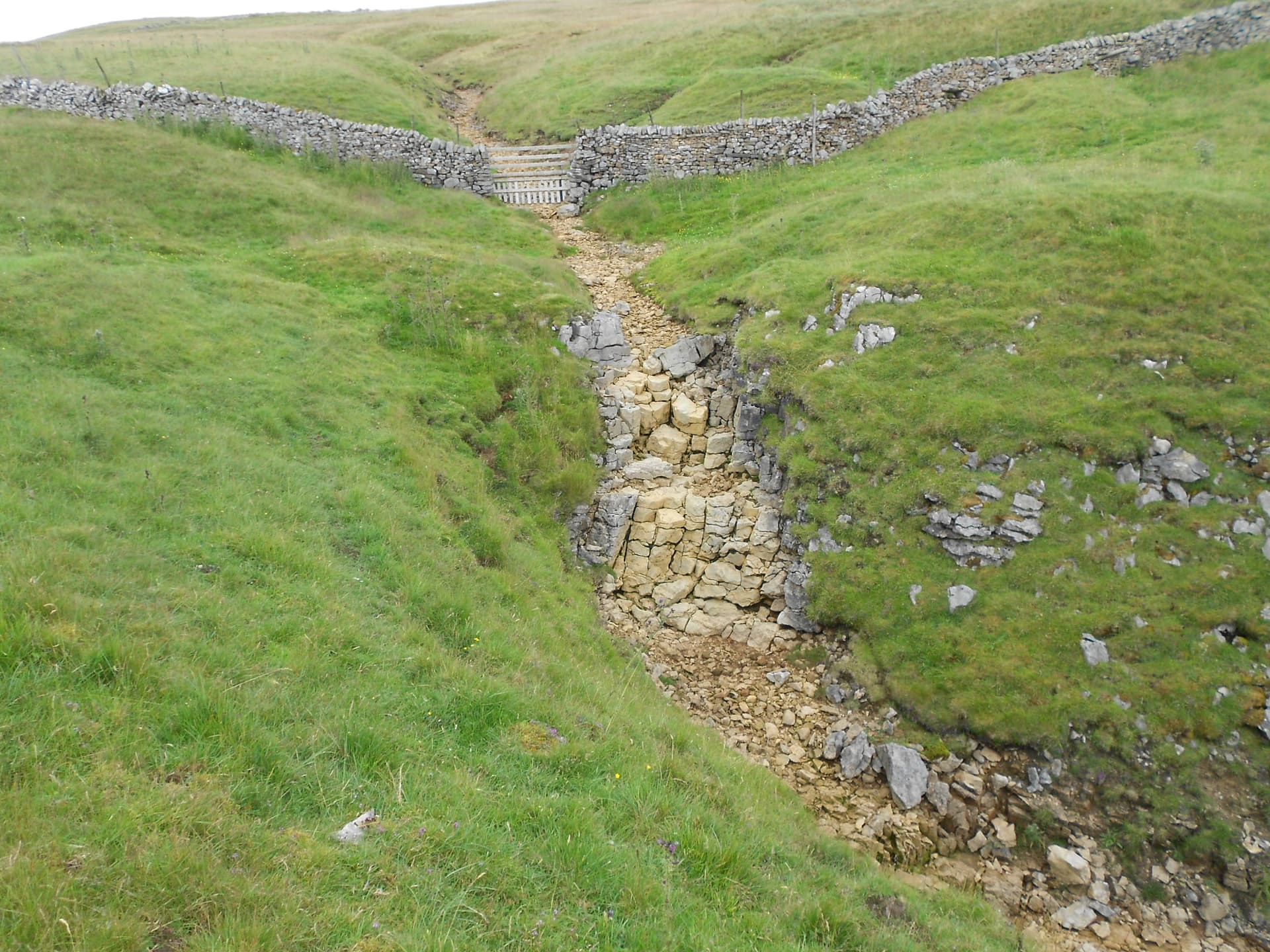

Above: Cow Close Gill crossing point. Dry as a bone as usual despite all the rain.

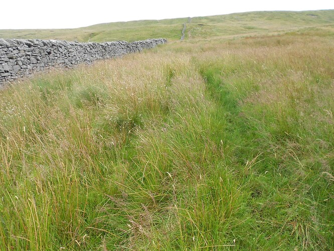

Above: A path of sorts follows the wall up to join the main path from Cray village

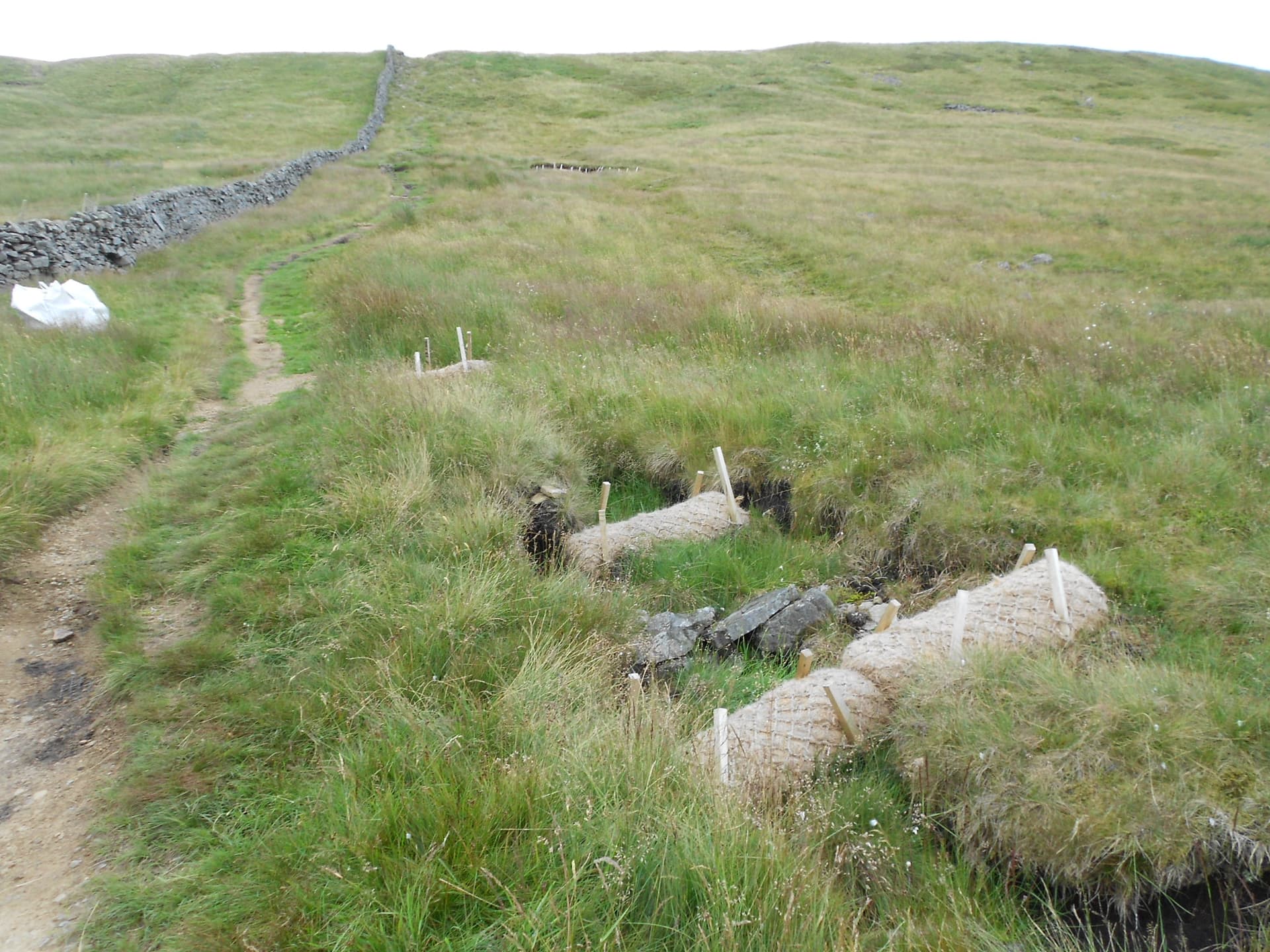

Above: The fibre rolls staked in place

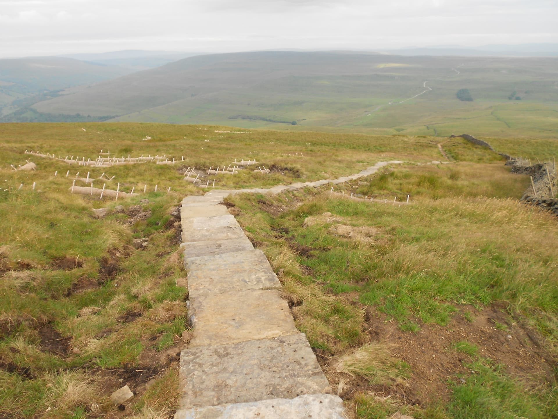

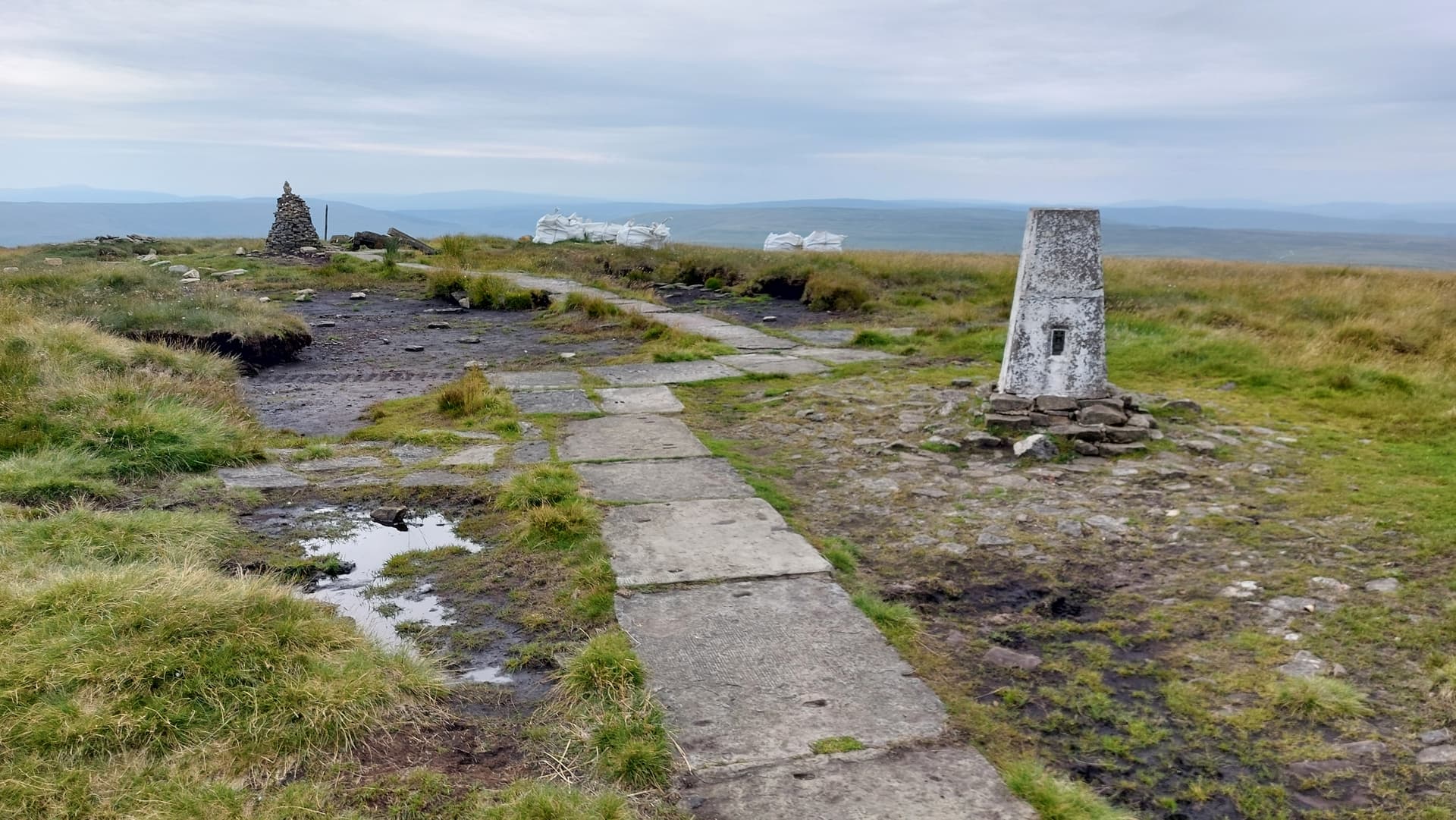

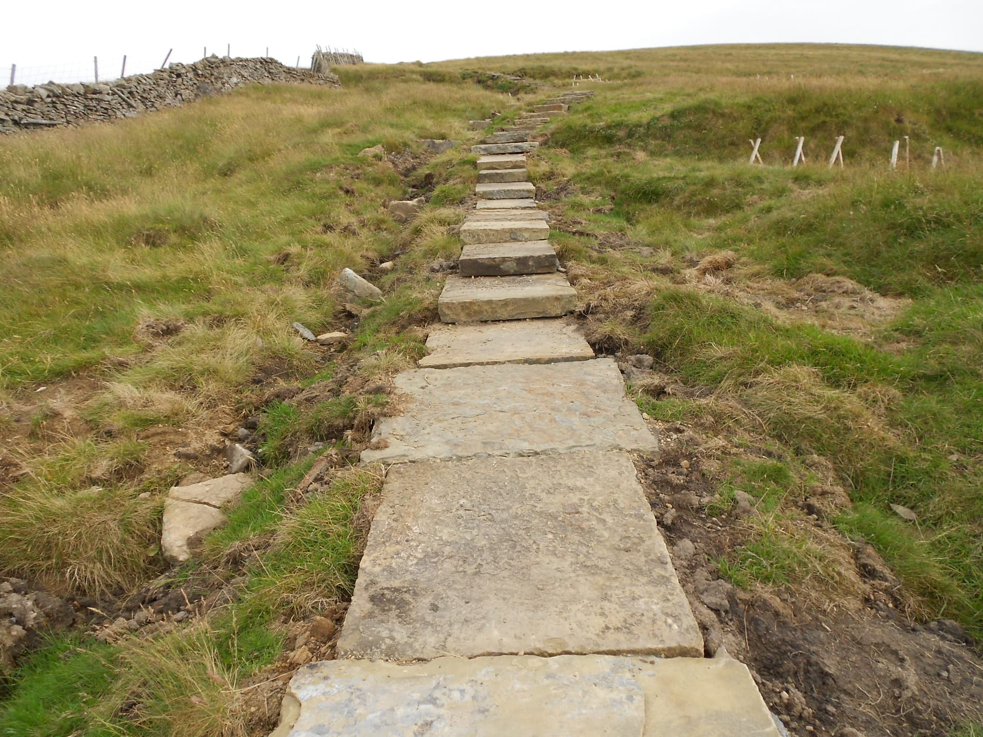

Above: New slabs - much work since last year
Above: Topping out on Buckden Pike

Above: My home for the night. Summit of Buckden Pike G/NP-009

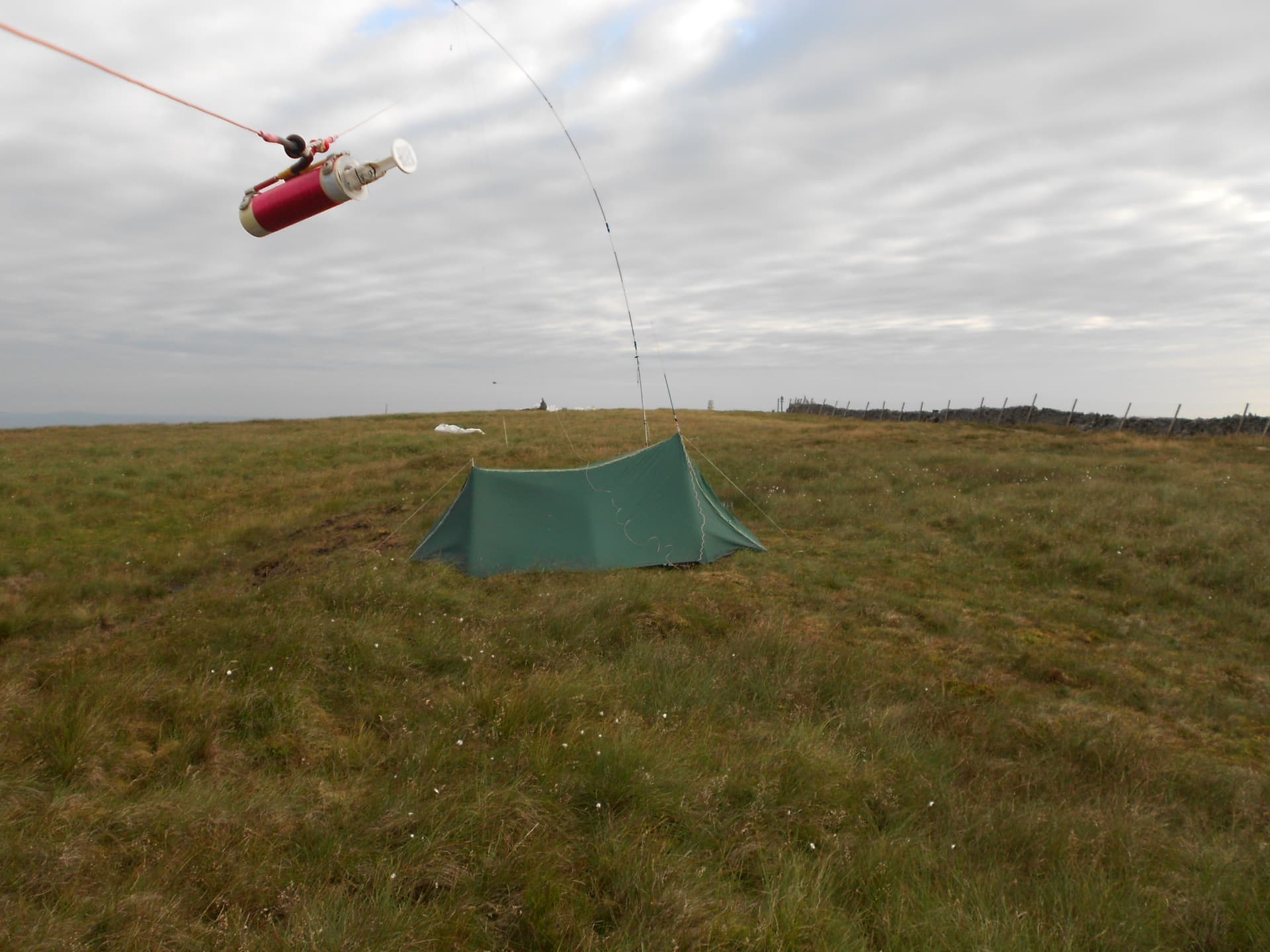

Above: The best ‘Hotel’ available tonight with 70MHz Yagi and dipole laid on the grass for later
Above: Activating NP9 in the 70MHz SSB UKAC contest

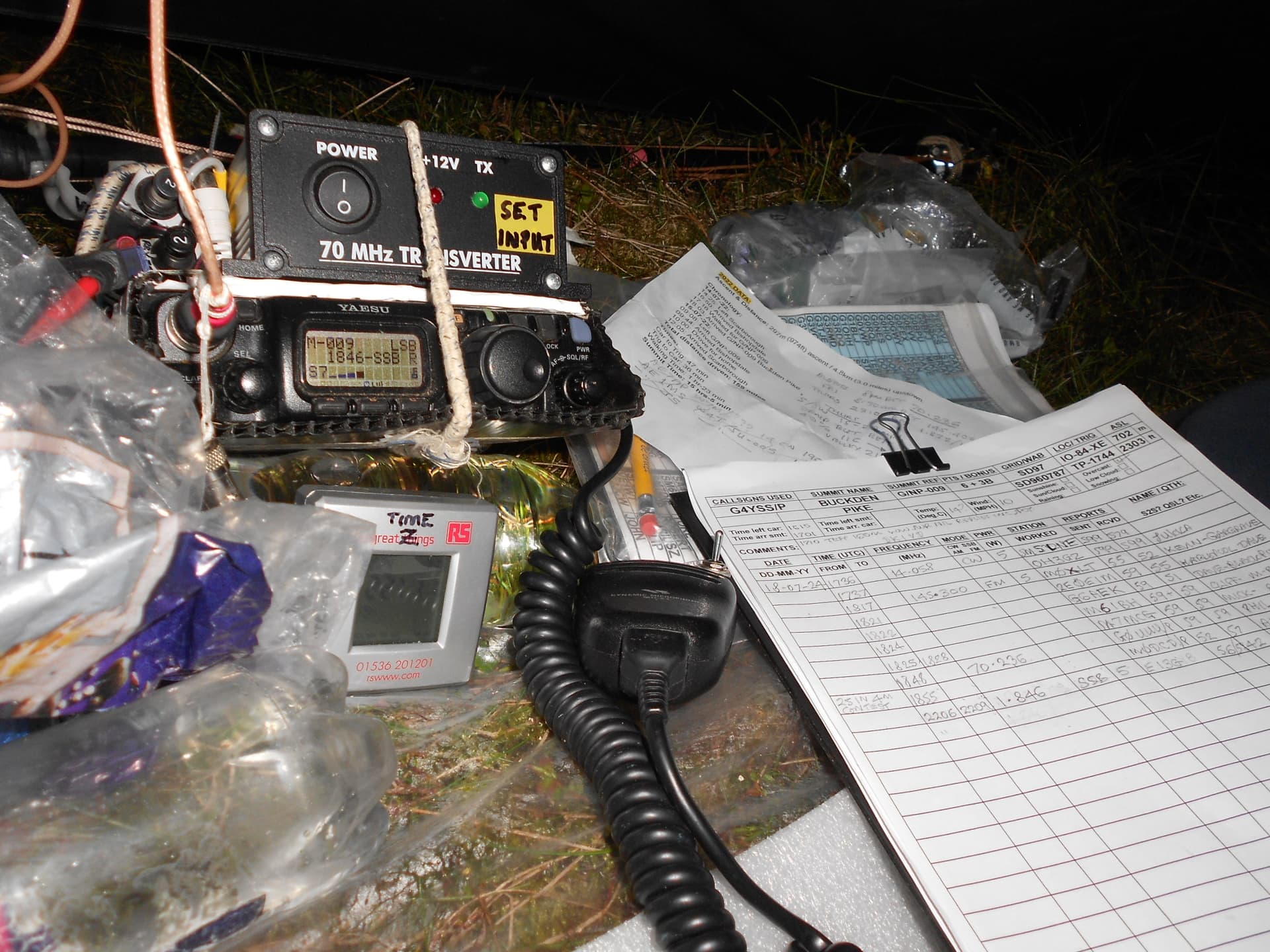

Above: Activation on Top Band 160m-SSB and later CW QRP

Above: Ready for the descent. The 85 ltr rucksack, thankfully not quite so heavy as the day before

Above: The 4m contest log kindly entered for me by Phil G0UUU/P.
Above: 4m contest map also courtesy of Phil. Many thanks.

These are to prevent drainage. They swell up to keep the water in. There’s a big move on many peat moors to reverse the years of drainage that is damaging to the peat. Peat bogs are an excellent carbon store.

John, thanks for providing your route details (approx. yellow line on map clip). I’ve done some G/NP summits 5 times in 5 years as they’re only 35-60 minutes’ drive away. I’ve never done Buckden Pike (85 mins drive) but I’m hope to this year.
(C) Ordnance Survey 2024
I had intended to walk from Buckden village (blue line on map clip) which OS-Maps estimates is about a 1hr50 walk. Your route is shorter and I assume quicker though more complicated. I might try following your list of SD map references. Does the route go via that wooden stile (over drystone wall) in your photo (or to the left on the flagstones)? My new rescue dog is still a bit nervous and easily spooked but I think I might be able to persuade him to follow my 12yo dog up and over the stile if need be.

Thanks. Why didn’t I realise they were for retaining moisture? It’s the first time I’ve seen them.

Hope you do have a crack at Buckden Pike which is quite special to me. My first time I breaking 2000 feet as a young 1960’s teenager. Actually it was your reply that gave me the kick I needed to spend an evening replying to the replies, while watching the Olympics. You needed an answer.
The answer is: Yes, your yellow line is about right. No, you don’t need to cross that stile. ‘Turn left on the flagstones’ yes, if that’s referring to leaving the summit. The route keeps the wall to your left as you go up and vice versa. Apart from three gates low down, you end up at the trig without crossing a wall. My old route, parallel and to the north of this one, involved climbing walls so I abandoned that.
I can’t claim originality. It was a SOTA op who told me about the ‘quarry route’ but I can’t remember who? Yes, it’s quick, mainly because you start high but it’s also the shortest route too. 110 minutes from the village – no three quarters of an hour with a fat rucksack. Much easier, though steepish in places and almost pathless in others. Your young dog should like it OK but there are sheep lower down.
I can send you a route via email .gdb (Garmin) or even .gpx if you wish?
Otherwise, here are some more waypoints:
SD 94550 79955; SD 94535 79995; SD 94749 79792; SD 94931 79639; SD 95208 79657; SD 95343 79536; SD 95460 79470; SD 95467 79355; SD 95651 79213 – join surfaced Cray path and follow up to top.
