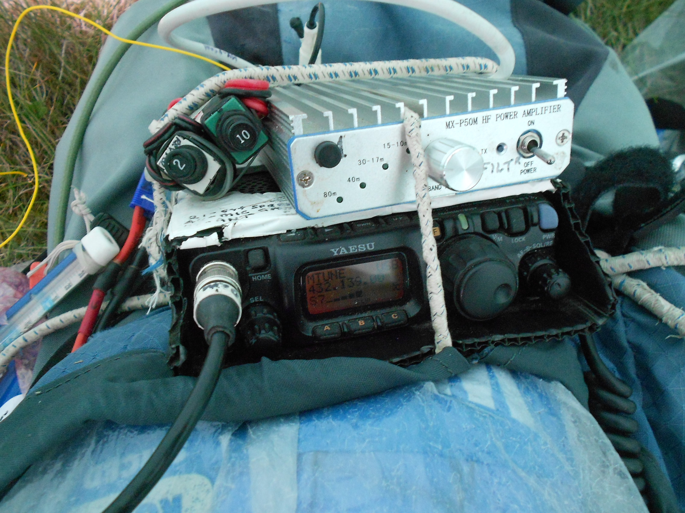

MX-P50M, 50 Watt HF Linear Amplifier
Link dipole for 80m thru’ 20m on a 5m CFC mast with 1m end-sticks
Home-brew tunable loading coils for 160m
5 Ah Li-Po battery

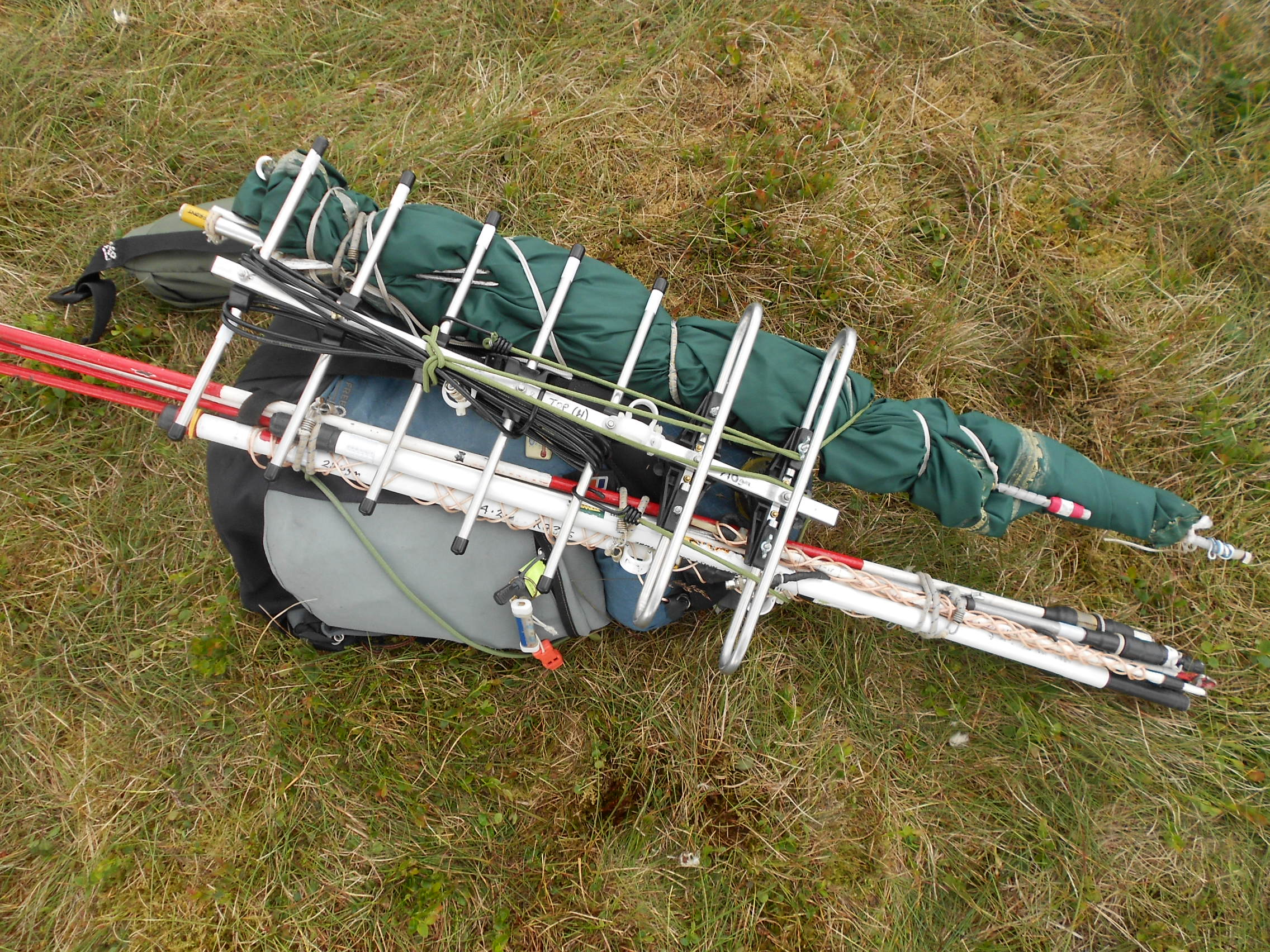

As per last year I took the 25 litre rucksack with mast, tent and beams tied to the outside. Weight was under 30 pounds again rather than 50 or more for an overnight stay. To the apparent loud objection from several pairs of nesting lapwings and intense stares from cows, the walk started at 06:20 but by then the cloud was down.
Half way up a heavy drizzle started which is when I realised I hadn’t picked up the umbrella, so a two minute stop to root out a rarely-used rain jacket was needed. The trig was gained in 41 minutes with a further 5 minutes to reach the usual QTH, 270m northeast of the summit.
By now the rain had stopped and with almost no wind the roomy 2-man flysheet was soon up as was the 2m SOTA beam. Thinking I might need to leave in a hurry, the HF dipole was left until later.

Using QRP in the contest left lots of battery power for HF later on and even with 30 and sometimes 50 Watts of HF, the 5.5Ah didn’t quite run out, which was quite surprising. Had I taken the IC706-2G I’d have needed two or three times the battery capacity for the 70 QSO total. The FT817ND/ MX-P50M 50W HF amp has proved an efficient combination. Yes the PA device blew once but it was easy to replace. Another issue is remembering to manually set the LPF for each band. Experience has shown that if you work on 20m with the filter set to 80m you will not have a good day (Ben More).

Above: The original but slightly modified SOTAbeam for 2m-SSB
Above: 70cm but the performance of this ZL beam is questionable

Above: FT817ND meter responding to quite severe noise on 70cm. Note ground spike and (yellow) wire which made no difference

That QRP Labs 50W PA looks the part John. When I wanted something like that years ago nothing was available, though I did build the Cirkit one for 15 Watts. I put it in a 3-band (80-40-20) CW-SSB rig I built from Kanga kits about 1990. I didn’t notice any duff keying – apart from maybe my own as I send on a toggle switch. Sorry you had to wait so long. I am not the fastest of ops by a long chalk but there were a lot of callers – the weekend I suppose. And yes, I was surprised to work that many G stations on 20m. It doesn’t happen too often.
