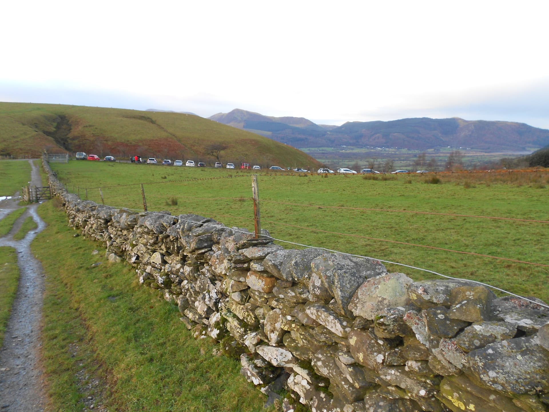

It seems like I was not the only one to identify the 26th as an only chance. The Underscar car park was full and when I arrived they were starting to line the sides of the narrow approach road. By the time I returned cars were scattered in passing places almost as far down as the buildings. I have never seen it so busy winter or summer. I was lucky however. Some ‘early bird’ vacated a space just as I arrived.

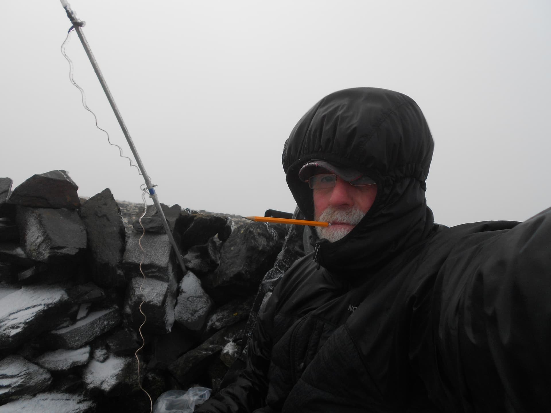

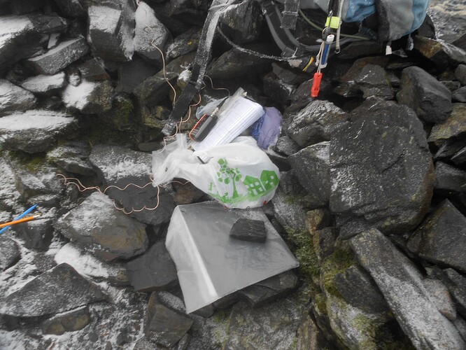

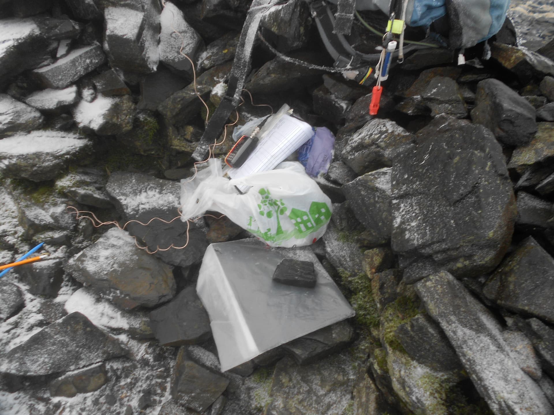

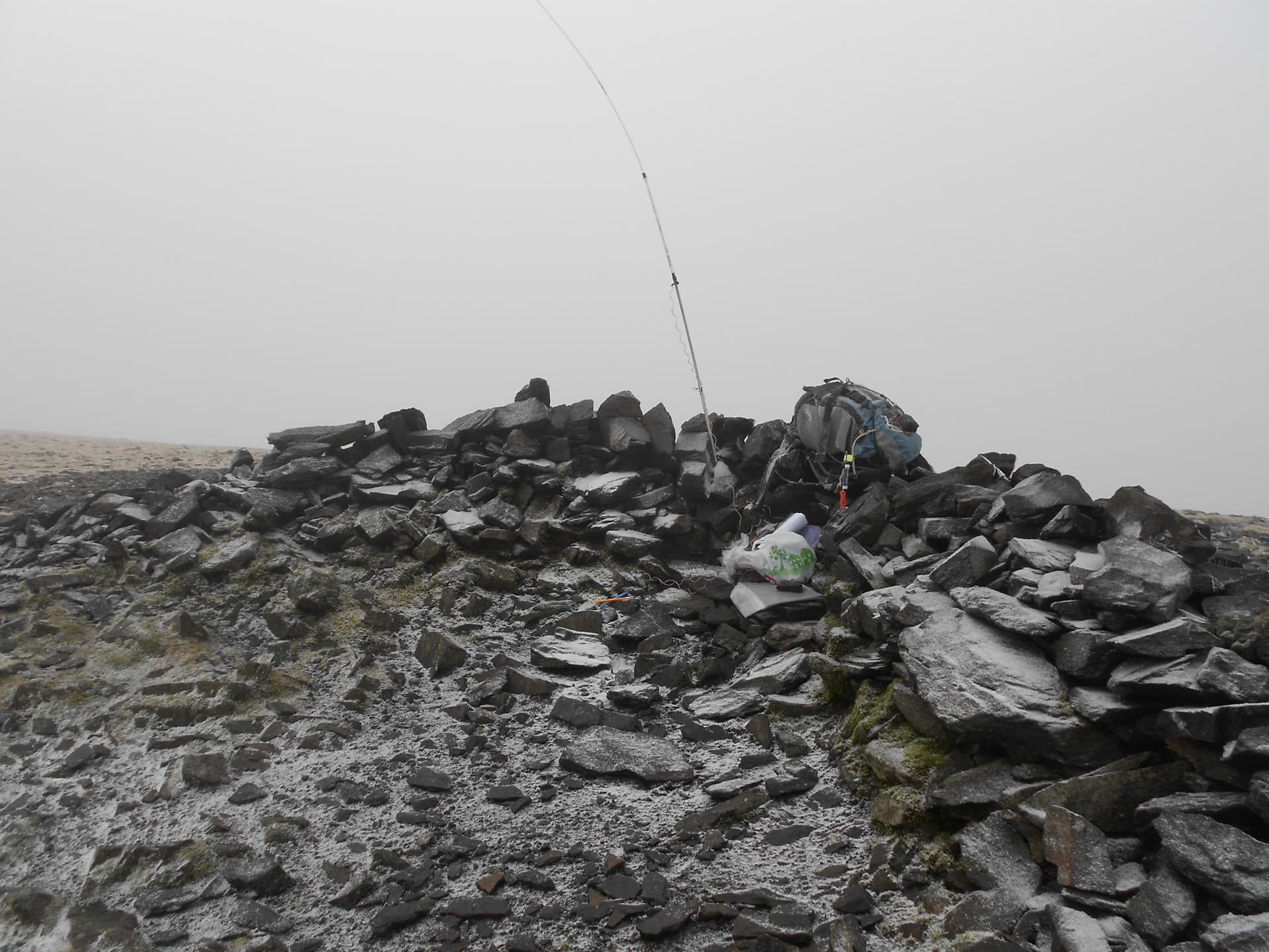

I fired up the 25W MT270M and J-Pole, coupled via the big PYE filter. I could hear people calling on S20 but the second I pressed the PTT it shutdown. After checking connections it was no better. The snow was stinging my face like needles and filling up the carrier bag containing the equipment. I had a choice of numb hands or numb gloves. After fiddling around far too long I was forced into the second option but soon gave up. The mobile rig wasn’t ‘coming to work’ today.
No worries, I’ll use the handheld; one of my IC-E90’s. Because of the mittens there followed a frustrating ten minutes and it was even more frustrating when I realised that this setup was doing almost as badly as the previous one despite it being completely independent. I could only get around ten seconds of transmit each time before the rig switched off.
Geoff GM4WHA, attentive as ever, must have heard the ‘goings on.’ He called me and we exchanged 59’s on S20 ASAP but I had to turn the rig back on several times to achieve even that. After a QSY to S22 (145.550) suggested by Geoff, I was able to explain in staccato fashion, the nature of my troubles. Geoff kindly put a spot on Sotawatch for me with an explanation and warning to potential chasers. This help was invaluable. This got me out of another hole but I seem to be making a habit of it recently.
By dropping carrier every time, before my ten second limit was up, I managed to carry on. Maybe it was the cold affecting everything or more likely condensing conditions inside the rigs wetting the circuitry? I broke out a couple of those handy hand warmers like the ones I was forced to use on WS1 in February 2006. One went into the left mitten and the other was rubber-banded to the rear of the handheld. Gradually the ten seconds increased until I was managing over thirty but by the end it was failing again. However I still managed to log the following stations on S22 after multiple returns to S20 and many PTT drops:

After a charge over several hours in the hotel room, the IC-E90 handheld appeared to work perfectly. I tried it with it’s own antenna and also linked to the J-Pole as per the summit setup. Both these tests used 90 seconds transmit with the rig set to 5W. It didn’t cut out or shutdown. The same test on the mobile rig using the full setup including the j-pole revealed no fault.
Cold or damp then, or a combination of the two? By the middle of the activation I did notice that the inside of the display window on the IC-E90 had ‘steamed up’ somewhat but I’ve seen that before with no ill effects. It would seem that the rigs need to be kept warm before use and not stored in a rucksack in a car boot for three days prior to use in wintertime.

Above: Activation of LD4 on VHF from the southernmost shelter
