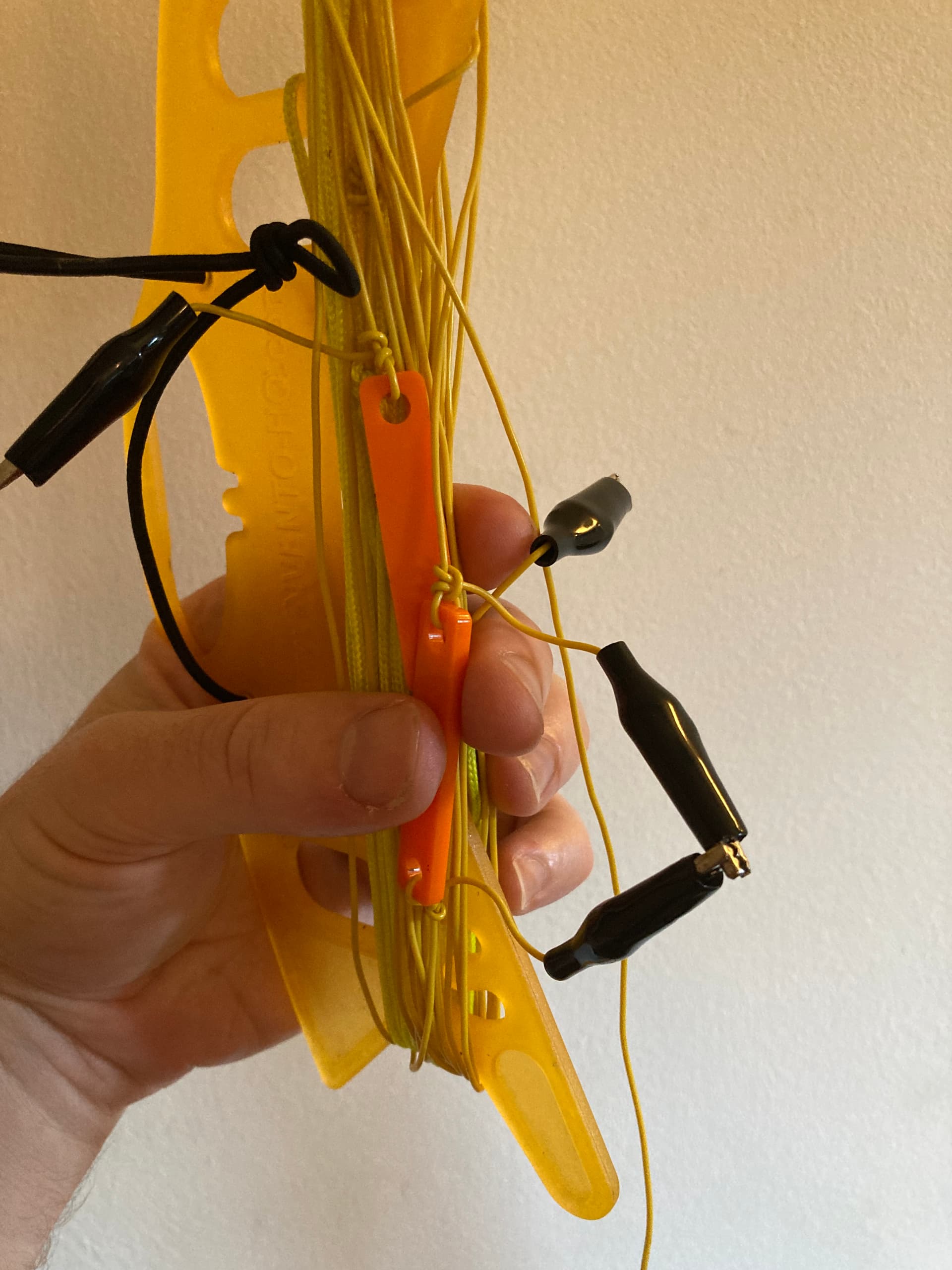

I had a quick listen around the band first, and I could hear plenty of stations, so things were looking promising. Not for long! The SWR reading on my ICOM 7100 went to maximum every time I tried to transmit. I lowered the antenna and had a good look to see if there were any breakages, but everything looked to be in order. I re-raised the antenna in hope more than expectation, but got the same result. I just couldn’t understand it! The last time I had used it, everything seemed to be in perfect working order.

I found myself with some spare time after lunch and thought I would have another look at the dipole to see if I could find what the problem was. And sure enough, the answer was staring me in the face!
For some reason I had closed the first of the links on either side of the dipole, so it was resonant on 30m rather than 20m! I have used this antenna many many times, so I knew what I was supposed to do! The only explanation for my gaffe must be an attack of summit brain!
