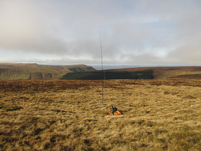

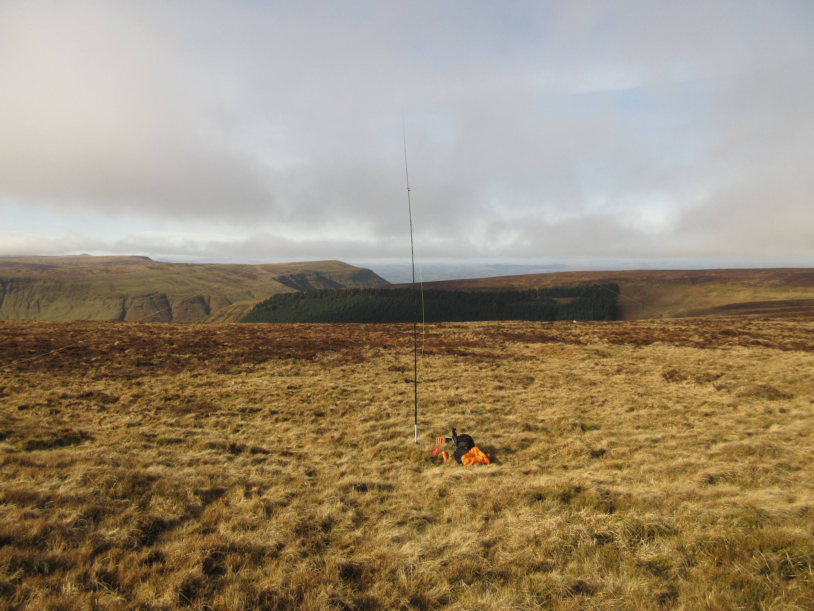

I operated from G/DC-001 on 19 February 2023 and this is a short video of the activation. It is mostly CW but I have tried to present it in a way which beginners like me might find interesting. I’ve used the sound recording program Audacity to show the CW in a visual form.
At about 9:30 it changes to FM which will be easier for non-CW operators. Experienced CW operators may prefer this section too. :slight_smile:
