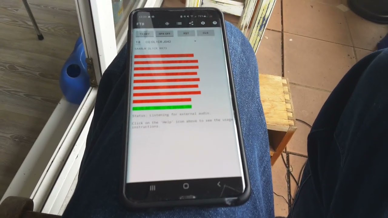

Lars gave me the idea of using FT8 on the summit. I don’t really like the digital modes that much, nor do I feel like taking a laptop with me on the mountain.
Now there’s an Android app that can do FT8: FT8 Radio
The first test without a cable connection only via audio was successful
