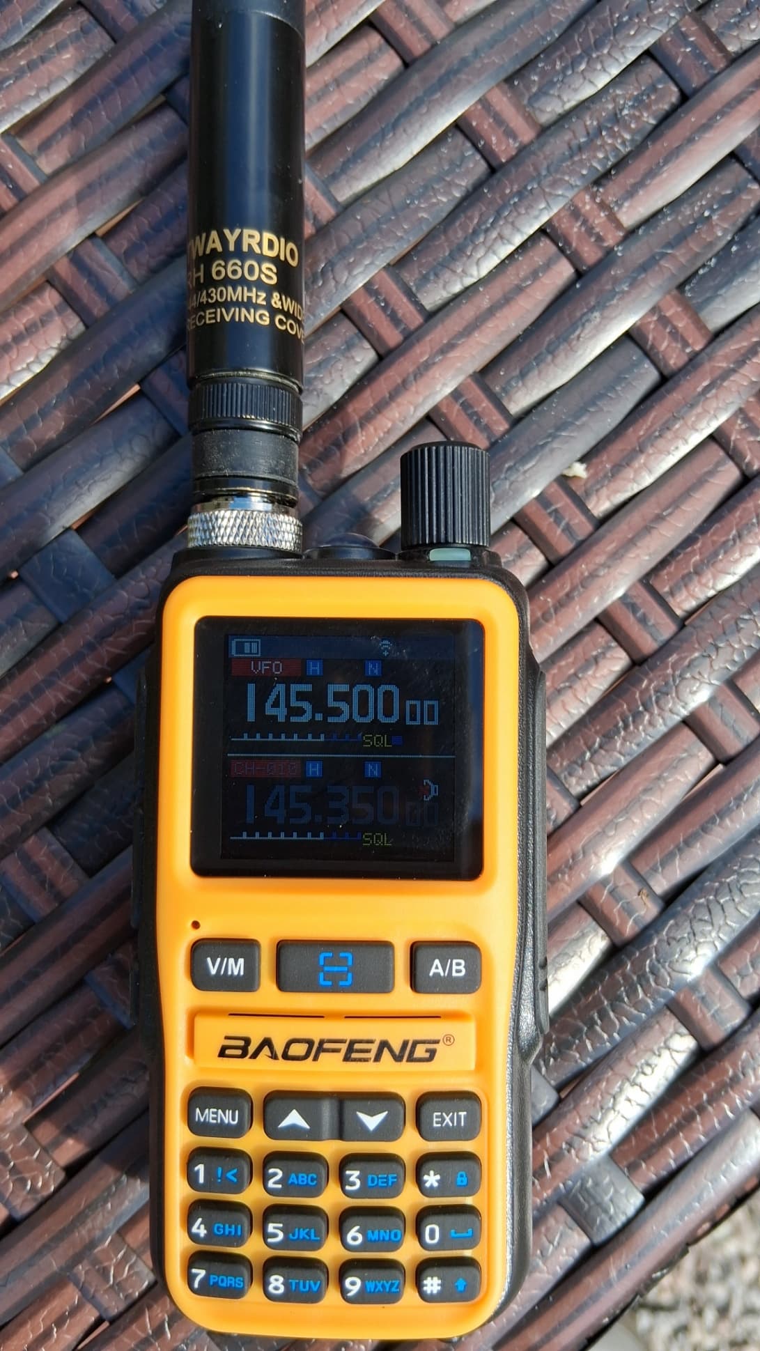

250g including antenna
If anyone can find a lighter and more compact 5w HT, then let’s all hear about it.

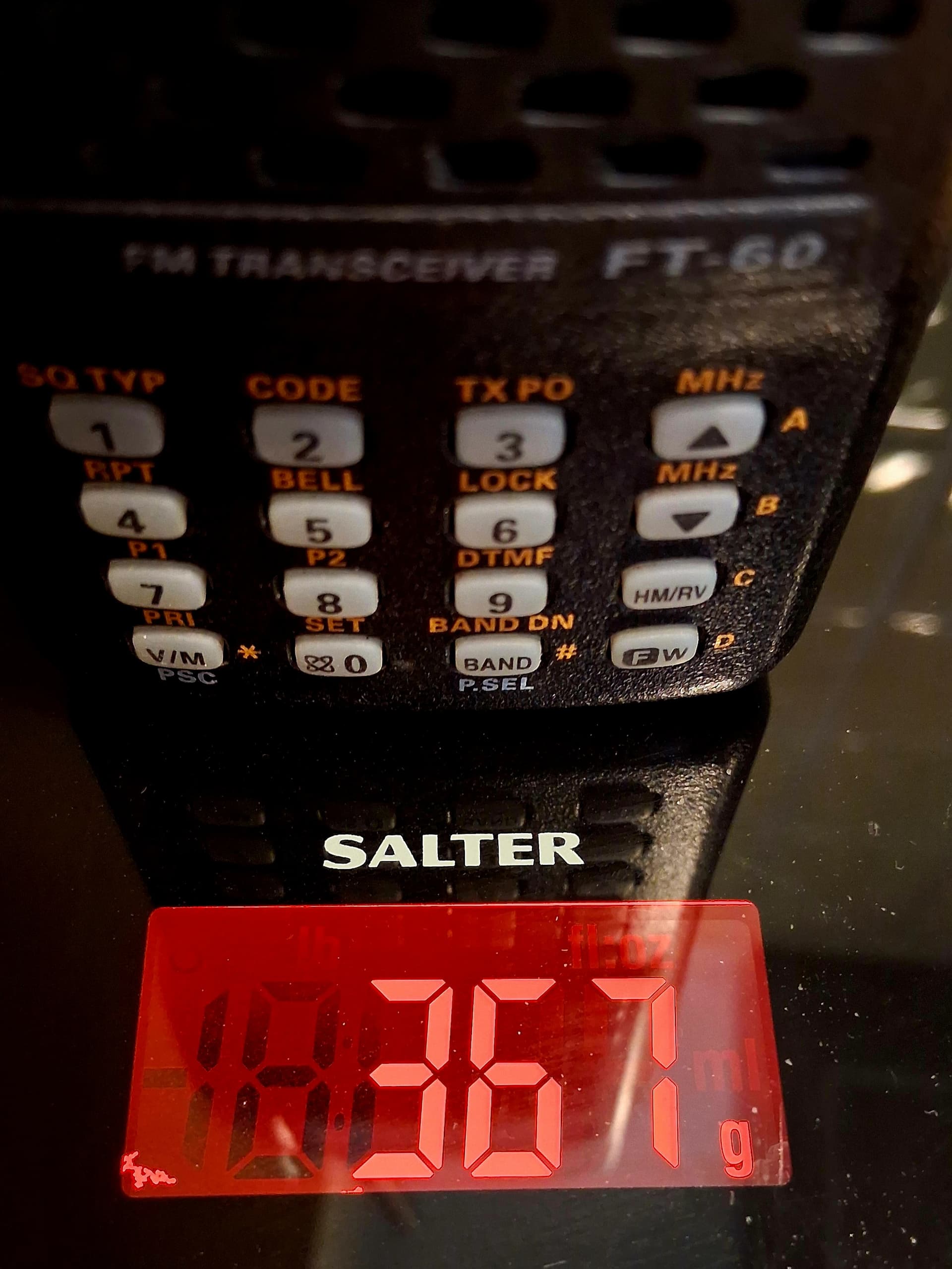

That’s light! The FT65 wades in like Big Daddy on Dickie Davies World Of Sport, tipping the scales at a colossal 260g! :melting_face:
A mammoth 367g for the King of handhelds.

367g!? How do you get that up a summit? Strap it to a St Bernard where the barrel of Scotch is supposed to be?
I suppose you could always have it airlifted up, like those extreme skiing folks do… :thinking:
