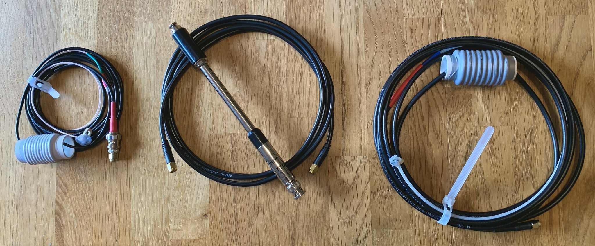

No1 - RG174 Flowerpot - VK2ZOI Dimensions of elements, 9.5 turns on 25mm PVC pipe, SWR 1.01, RG174 feeder 2.5m. (weight 80g) (top of antenna 4m AGL)
No2 - Diamond RH770, attached to fiberglass mast 2m above operator with 2m RG58 feeder. (2m RG58 feeder weight 85g, RH770 already carried) (top of antenna 3.5m AGL)
No3 - RG58 Flowerpot - VK2ZOI dimensions/turns/pipe exactly to website. SWR 1.01, Feeder 3m RG58. (weight 180g) (top of antenna 4.5m AGL)

No 3.
Why?

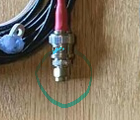

No 1 has an SMA to BNC adapter. I have had trouble with those.
No 2 doesn’t appear to have the right connector on the cable (it’s SMA at both ends but the antenna is BNC).

Yes, the bad BNC-SMA adapters that failed on me are like the one in your photo

The flowerpot options effectively have their own ground plane that the antenna works against within their design.
Just connecting the RH-770 to a pole and putting it up in the air without a ground plane of say 4 1/4 wavelength (or there abouts) rods mounted underneath it and connected to the coax braid is going to be a bad idea. That antenna needs a ground plane directly under it - normally it is the case of the HT but you have taken that away. By the way the coax with SMA connectors on each end isn’t going to fit the BNC plug on the antenna in any case. At VHF/UHF, it’s better to avoid using adapters to go from on connector type to another.

Well spotted. That RG74 antenna was made for another radio and I use the connector to use it on the FT5D. The RH770 feeder connector is not shown on the photo, but I do have one. I make my flowerpots with the connector for the radio it is going on, without any break between the antenna and the feeder. The 3rd one is made for the FT5D and I’ll be making one from RG174 if I decide its the way to go.

I need SMA female and they don’t seem to sell those.
I try to make antennas so there are no breaks in the coax, except the connection to the radio, so try to avoid adapter altogether. saves weight and reduces points of failure. The reason that adapter is on that antenna is because the FT65 has a male antenna socket and if it snaps its hard/expensive to fix the radio but easy to change the adapter. The FT5D has a female socket so the feeder/ antenna would be the thing to fix/replace!:grinning:
If the feeders all had “perfect” connectors, which would you choose. Did you pick No3 because of the RG58 v RG174 or because it was longer?:grinning:
I use RG174 on my centre-fed linked HF dipoles, but in general I avoid it at VHF. But as you are talking only about very short lengths, I don’t see a problem. Attenuation of 2.5 - 3m of RG174 at 150MHz is about 0.8 to 1 dB.
