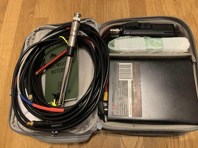

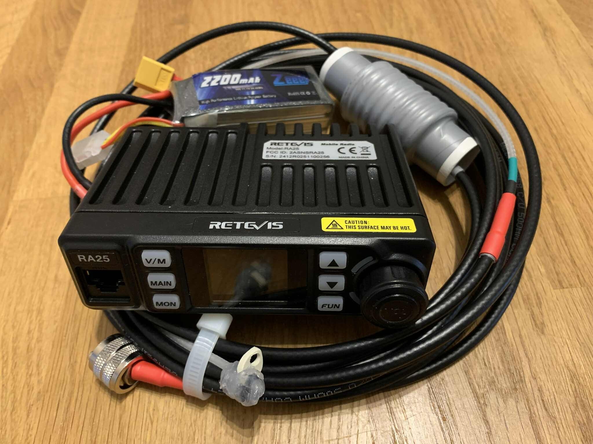

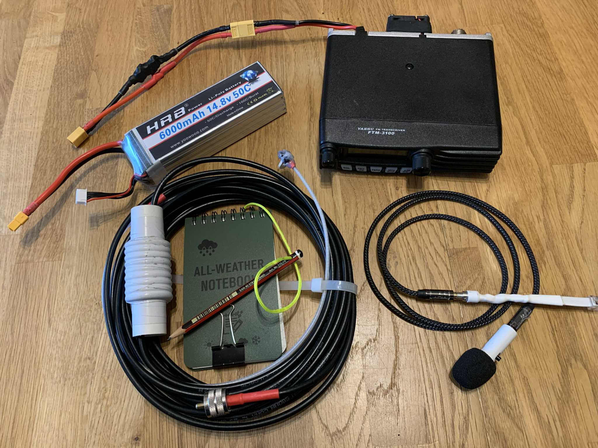

Hi Ian,
You’ve asked readers a few times to pick one of your 3 options, but if, like me, I don’t understand why them, they may be reluctant to pick one.
From the short lengths of your coax feeders the pole can only be about 1-2m high (allowing for horizontal run). Are you wanting to sit / lie in your tarp / tent (out of the rain) and have the antenna outside?
IMO, there are two classic 2m FM operating modes:
  1. standing up with HT/RH770 in one hand (quickest one to deploy / pack away), and
  2. sitting in chair, hunkered down in heather / hole, in tarp / tent with a roll-up slim-jim or j-pole on 6m pole with 1-2m of RG174. The roll-up types are very lightweight and pack down to a small volume.
If you’re going to the faff of putting a VHF antenna on a pole, make it a taller pole to improve your VHF coverage.
Did I read Slighly Crag and “on the next visit” in the same sentence? My kit could have weighed -20Kg and I still wouldn’t be tempted! 73 Paul
… PS J Pole up 6m mast with a backup RH 770 seems to work for me and the J Pole gets better reports but that is probably due to being 6m in the air!

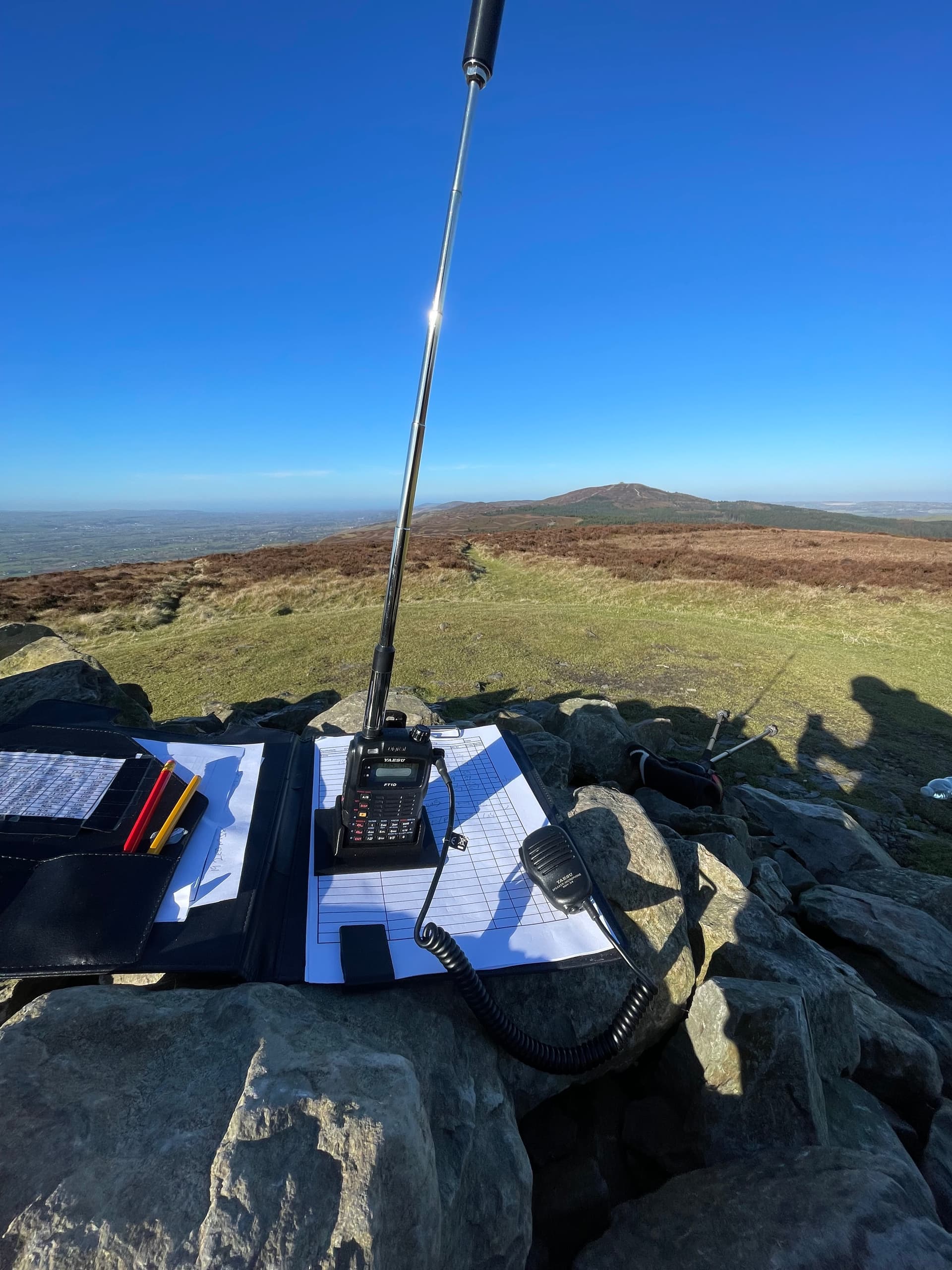

I use a stand and external mic. I have made one similar for my FT65 with a hole for a tent peg to secure it
I like the RH770 but I’ve never tried using it to log.
All over Katsushika-ku, salesmen are looking at that photo hoping lots of people will copy you and sales of new handhelds to replace those with broken antenna sockets will boom in time for Christmas. :slight_smile:
Not to mention the connections to the PCB, which are also not designed for the force exerted on the pcb and soldered joints from a long and relatively heavy antenna.
There has been only minor mention of the impact of a ground plane on radio performance. Normally HTs are operated with a quarter wave or more of conductor above the connection to the radio. The radio is presumed to be sufficiently efficient as a replacement ground plane, but in fact adding just one quarter wave wire to the connector improves its efficiency noticeably. But most HTs operate with the PCB of the radio as its only ground plane. In turn the radio’s PCB is loaded by a non-resonant water filled container on one side and an outer appendage of the operator on the other, neither of which make for a loss-free ground plane effect. The case of the radio is plastic and is of no value at all in terms of ground planes.
Working dx with the standard setup is indeed a miracle when it happens at all.
73 Andrew VK1DA/VK2DA
I share your concern :grinning_face: that’s why I 3d printed a load spreader for the FT65. The original Diamond SRH770 that I used on the FT1D comes with various spacers to act as load spreaders.
