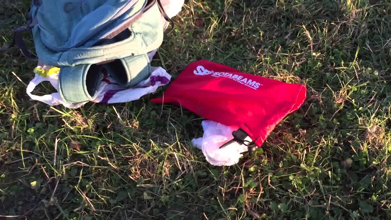

Made a video from an activation up on Wendover Woods back in November, might of interest to you as well:
Cheers, James M0JCQ
