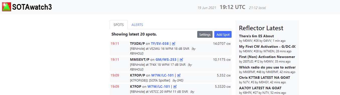

Did you “spot” yourself on SOTAWatch? I have found in my very limited experience this works very well. If you are unfamiliar with the procedure it is a system to tell people you are on a specific summit, frequency and mode. Chasers see this and will listen out for you. It beats calling out blindly into the void. :slight_smile:
If you look on the list of spots it can also give you an idea which bands might be working and the frequencies to try. For example earlier today 20m seemed very popular.
And hello from another 705 user. :slight_smile:
Ah … John just beat me to the comment Richard - spotting and alerting on SOTAWatch is the safest way to line up at least 4 contacts so that you can qualify the summit.It makes a world of difference.
Post an Alert with the approximate time you expect to be operational (if you’re not sure of the time say so in the comment), then when you get on the summit - as long as it has cell coverage - you can spot yourself either via a browser through SOTAWatch again, or via one of several Apps, SOTA Spotter and SOTAlas are commonly used, or you can even spot via SMS once you register your phone number with Andy.
