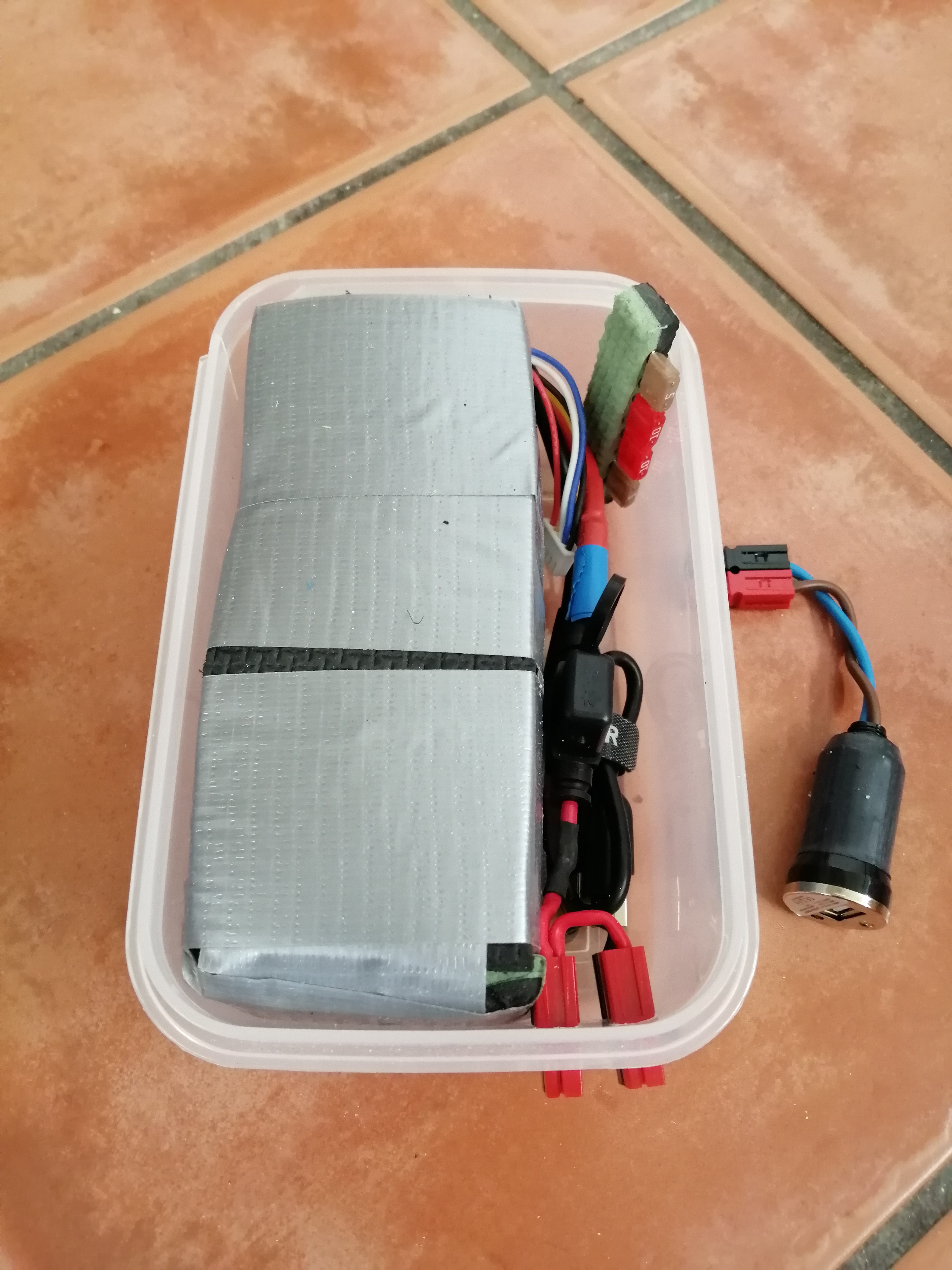

I updated my battery box with a second Powerpole connector. The battery is wrappped in a piece of old closed cell sleeping mat so it doesn’t rattle around in the box.
