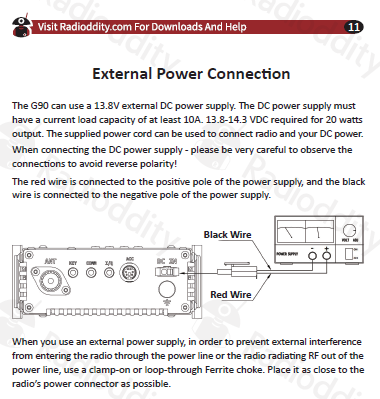

from the G90 Manual.
For the full 20 watt output, a supply voltage of between 13.8 & 14.3v is required. Running from a lower voltage such as from a 3S LIPO, the output power will be reduced. (and sometimes with some radios other issues can occur).

Hi Andrew, I posted the page from the G90 manual (obtained online) in response to the suggestion that the G90 could be run from a 3S LIPO at 10-11v.
I do not have a G90, you will need to ask Martin to measure the actual current consumption.
With my X108G, which is the G90’s predecessor (but not SDR and no tuner) I run it at full power (20w key down, probably 30W PEP output) with an 8 amp fuse, I think I’ve run it with a 5 amp fuse as well but wanted to give it a bit of headroom.
It is much less than 10A. I do not have exact measurements, Julian OH8STN has done a much better job and done all the measurements:
At about 11:30 min you’ll see the synopsis. Max is 5A @ 20W on 80m.

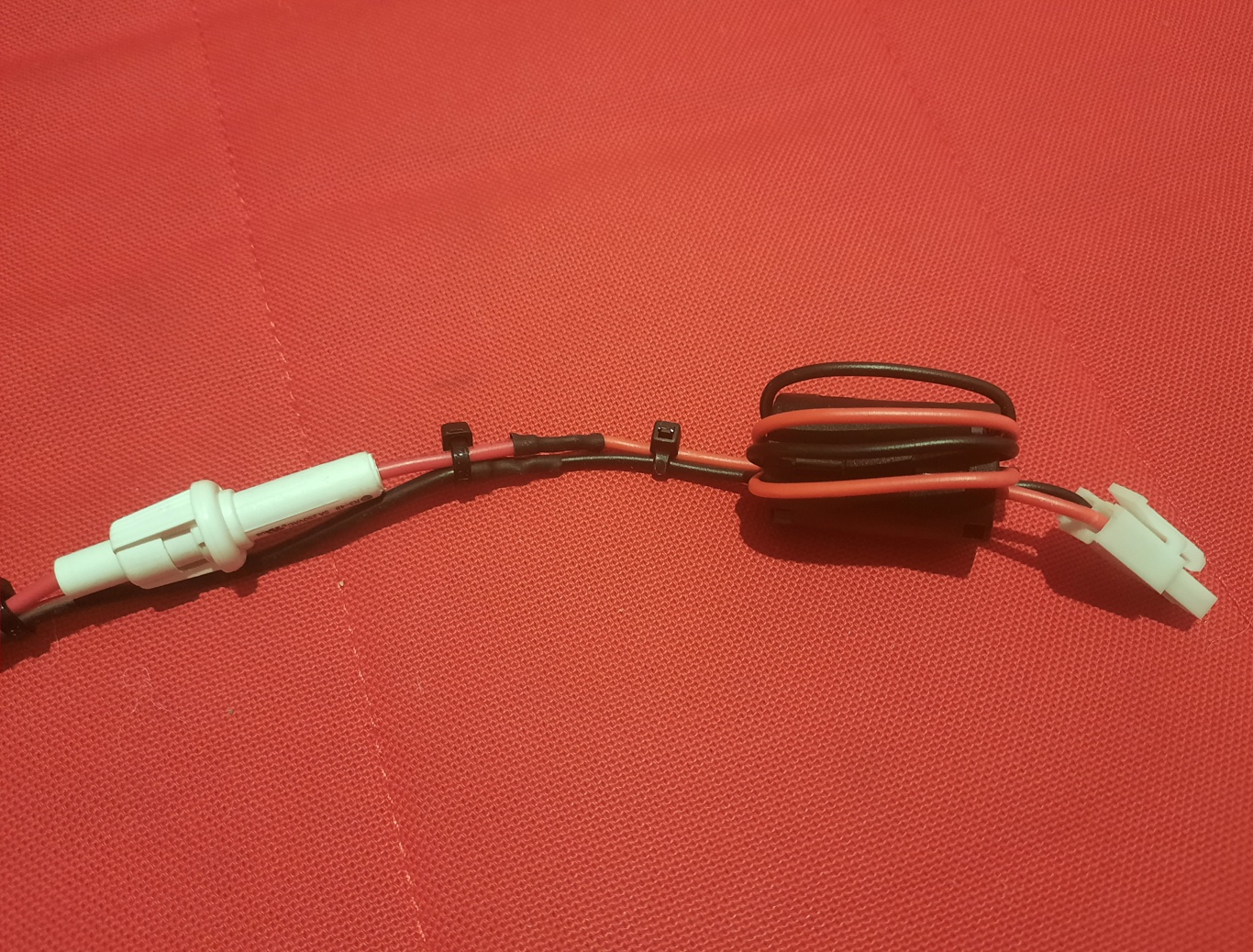

I saw it last week! Arrived and all soldered up!
“Fuse needed in both leads” says the voice of experience.
