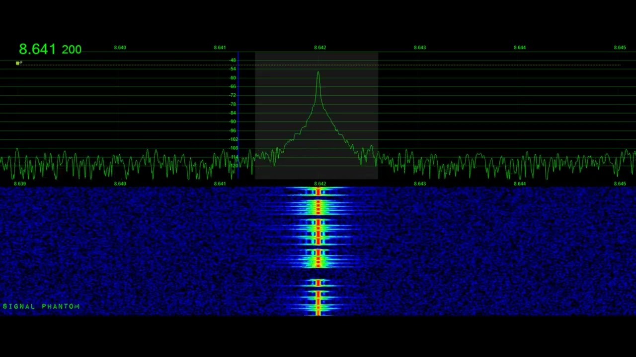

In case folks missed it or anyone is keen to hear the transmission, it’s available below. If you fancy cheating you can find the decoded message in the description.
The 5 letter groups start at 1’52’.
Random groups are good practice for reading morse as there’s no words to guess or anticipate.

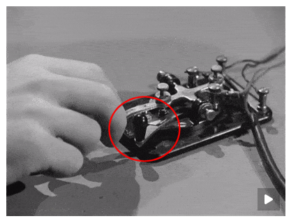

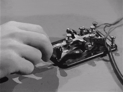

The image below is taken from the video at the top of this post.
The key shown in the image below would appear to be a Lionel J-38. My limited understanding is that these were manufactured in large numbers by the Lionel Company of New York starting around 1940. They were standard issue for the US military in WWII. Others from ‘across the pond’ will likely know more.
A couple of years ago, I was fortunate enough to be given one of these keys by a good friend. All cleaned up, and with pride of place on my shack desk, it still works excellently-well some 85 years after leaving the factory. It says Lionel on the base-plate.
One distinguishing feature of this model of key relates to the ‘vertical black knob’ circled in red below. This is attached to a narrow metal strip that rotates in the horizontal plane, and is at ground potential.
By pulling the knob towards the centre-line of the key, the metal strip slides under the spring-clip you can see in the image. When this is done, the key is permanently ‘ON’. This allows the operator to have both hands free to swiftly ‘plate and load’ the PA of his valve/tube transmitter.
As you can see in the image, the metal strip is under the spring-clip. As such, although the operator is ‘banging away’ on the key, it would seem he is actually sending nothing at all as the key is in the permanently ‘ON’ state … :open_mouth:
73 Dave

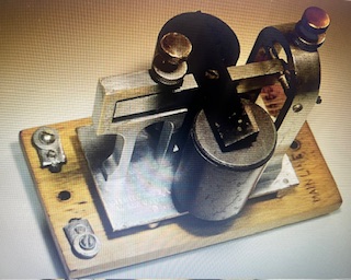

Dave, my understanding is also limited, but notice the strap at the back edge of the key with contacts at each end. That brings us up to two contacts on the left for incoming wires and two on the right for outgoing wires, used in landline circuits such as rail stations. Also in the circuits, starting in the 1850’s, are “sounders” that make a slightly different click when a key is pressed, than when it is released. At the end of a transmission, the operator closes the switch you circled in red, leaving only the sounder at his/her end of the circuit, ready to receive a message from the other station. Power is by battery at a single location. My sounder has a pair of ten ohm coils, but other resistances are available.
Elliott, K6EL
Typical sounder
Elliott, many thanks for your enlightenment :slight_smile:
I have been doing a little more research which I have posted to a separate ‘J38’ thread to avoid hijacking this one.
