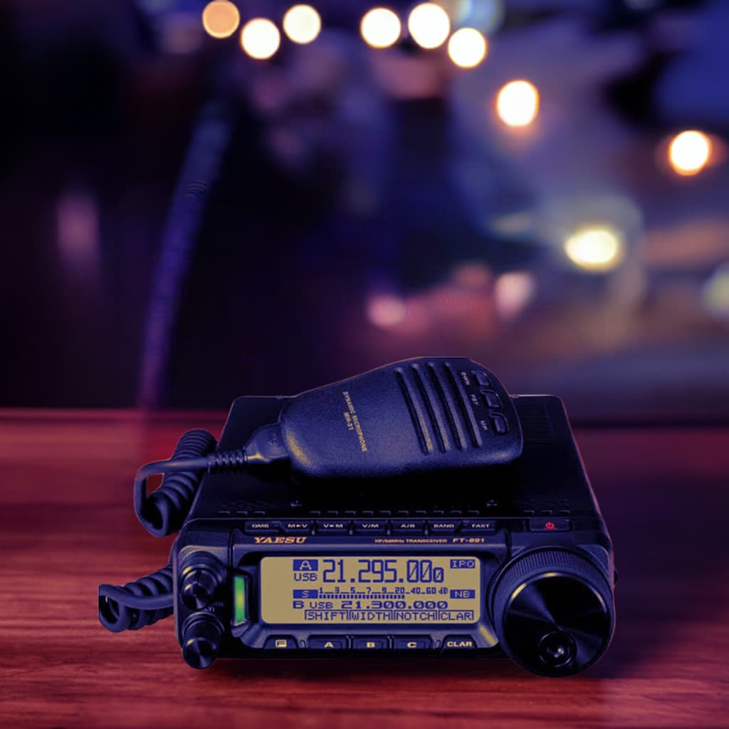

My 891 is going with me when I snuff it. Marmite menu system and all.
